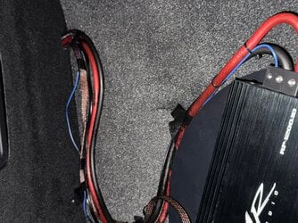

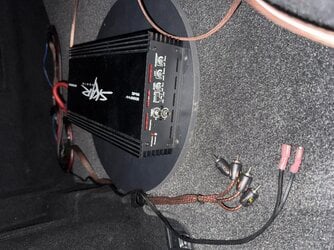

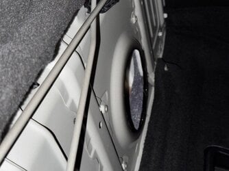

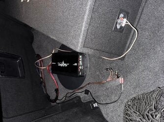

I appreciate the quick response, a lot of this audio and electrical stuff is confusing to me, where do I hook up the factory sub speaker connections? And if the RCA's are coming from somewhere in the front of the car, what exactly is coming out the LOC... Sorry I'm a little confused but I can go outside right now and send a photo of the setup.
Here are some photos if it helps, if anything help me understand what you guys suggest...
(Don't know why they're sideways)
Everything power-wise is wired to the amp, what's left is the factory cables and the 4 RCA's. 2 of which are tagged "F" and the other 2 "R." No matter which way I arrange them they give no signal to the subs.

Ok, let us try to figure this out. Where do those RCAs come from. If the previous owner only had a sub system installed, he would only need two RCAs. So do trace them to form the battle plan.
Here is how LOCs are wired-
On one side you will have pairs of regular wires, white and gray if two channels plus green and purple if four channels.
These wires are spliced into the factory speaker wires to feed the signal into the LOC.
The other side will have either two or four RCA ports. These feed the modified signal to the amplifier. That's it for a passive LOC.
If it is a digital LOC, it will have power, ground, and remote out. The remote out goes to the amp's remote terminal. That's it for now.
