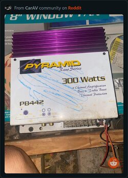

What year was this amplifier in anybody know? My guess, 1990s.

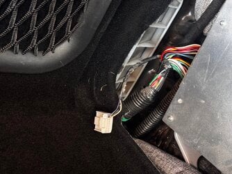

Alright so everything is working now with the small little cheap kicker loc. thank you guys. I still have no idea what the point of those 4 RCA’s were. However I need to now figure out how to connect the bass knob which I tracked its wires back under the kick panel.
I found this harness taped to the factory amp, that looks to be the same wires… do you think this was connected to whatever loc he had? If so, how can I connect his bass knob to my amp? Or do I have to replace it with my spare bass knob?
EDIT:
It looks like he has a Stinger bass knob. Those usually have 4 RCA’s, I connected them to a RCA - 3.5 Jack adapter and now those bass knob works good. I think I’m going to upgrade to the KeyLOC which has a higher wattage input due to me using the factory sub as the source

Good deal. If you are not noticing any bass reduction as the volume goes up, then the regular LOC is just fine.
If the bass knob has 4 RCAs, then the RCAs that run to the front are for that. Remove the LOC to amp RCAs. Now plug one side of the car's RCAs to the amp and the other side to the LOC. With the bass knob volume down turn on the system and test it. If no bass, switch the RCAs on the amp and LOC. Test again. If the bass knob is connected to the RCA cables, it should control the amp's volume.
Alright tomorrow I’ll try that. I only have the rear RCA’s hooked up and the bass knob works but it’s very sensitive, everything past medium sounds like max.
