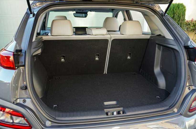

My entire trunk space is 19.2 cubic feet. I'm willing to use upwards of half of that (so up to about 9 or 10 cubic feet) or more if needed. My plan from the beginning was to do a ported box, but I'm still doing research on the best way to shape and orient it. Thanks for all of the advice. I will definitely keep all of that in mind

2020 Kona?

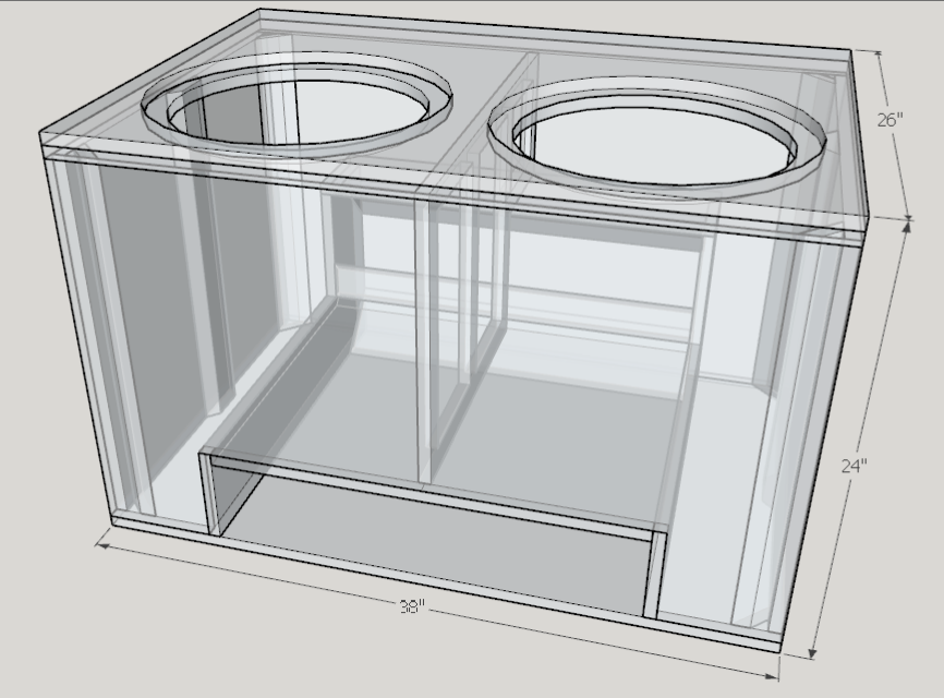

If that's what you have to work with some actual useable measurements would be extremely helpful. It looks like a pair of 15's would fit offhand to me without knowing actual measurements.
A pair of P3-12's will fit in there easy if you ask me... hell... in a similar sized car (Ford Edge) I designed a dual Sa Zv5-15 enclosure for a buddy.

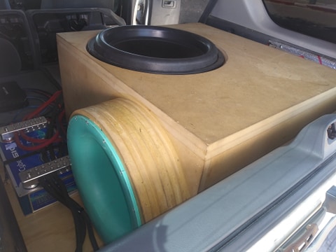

I think even a side firing port would work if placed properly, like this...

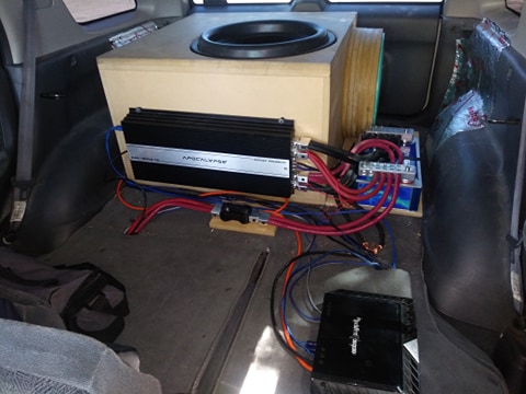

Holy spacer rings
lol... It's what I ended up with for a low tune in a smallish box.
27" of 10' Aero is awfully hard to fit in a under 5.5ft3 net enclosure 18" high with all the displacements. Sux competing stock 3k but it is what it was so to speak... Sold now and I miss it everyday.
24196
She did pretty well for what it was... I'm still a low power guy and after a break I'll start over.
