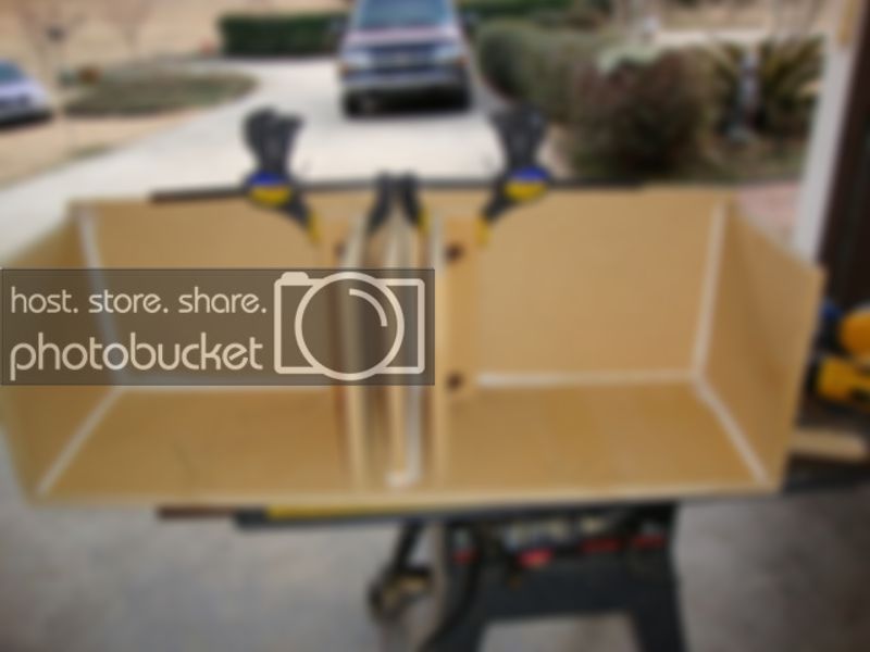

my 2nd system ever...here we go

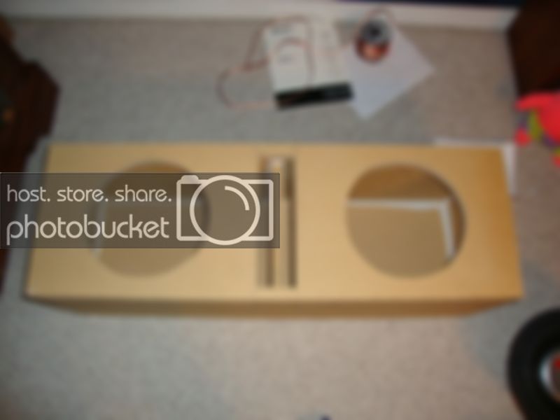

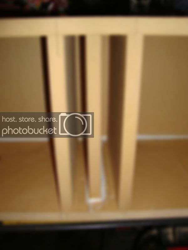

shit my bad, it IS 1.3 per chamber, so 2.6 total...sorry about that. are the ports still too small?
They are a bit on the small side...only 8 square inches per cube, the usual recommendation is like 12-16. But that doesn't necessarily mean you will have port noise, but you might //content.invisioncic.com/y282845/emoticons/crap.gif.7f4dd41e3e9b23fbd170a1ee6f65cecc.gif
yep we'll see, if it sounds bad, then i already have a little experience building a box //content.invisioncic.com/y282845/emoticons/biggrin.gif.d71a5d36fcbab170f2364c9f2e3946cb.gif

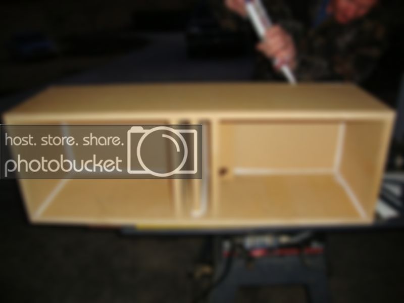

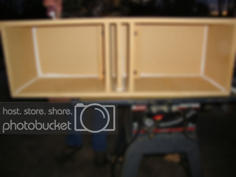

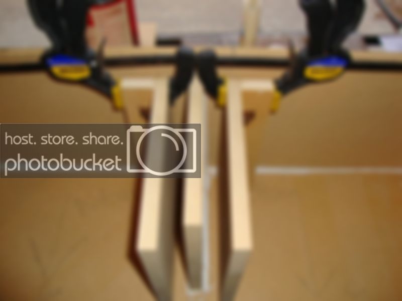

sorry it took so long for an update....
i finished building the box.
carpeted it myself. this was my first attempt doing it and i was very pleased with the results.

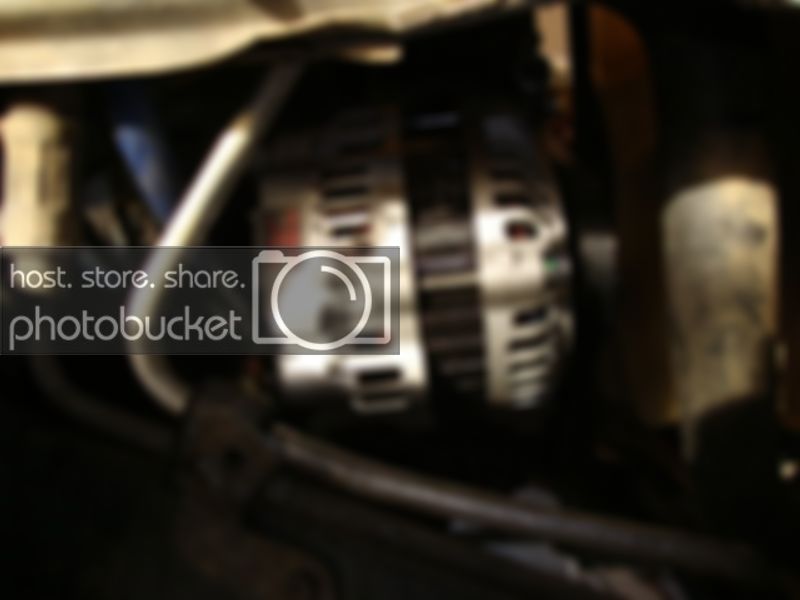

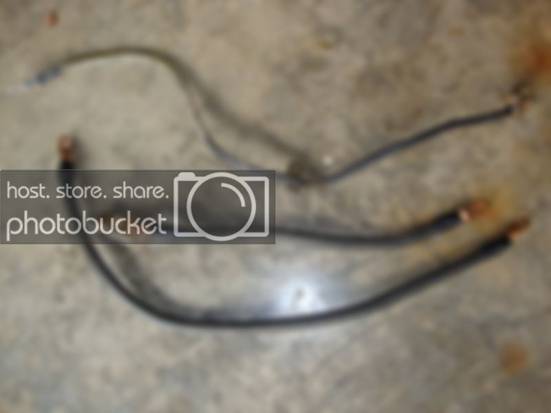

also did the big 3 upgrade and installed a 125amp alternator from a 96 nissan quest 3.0L

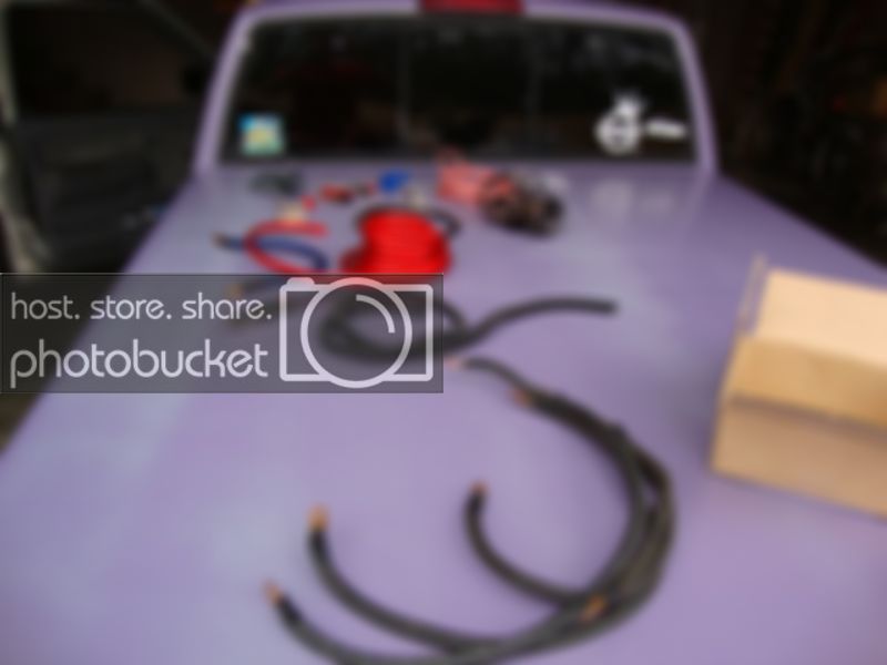

big 3 wires and amp wiring kit on my truck

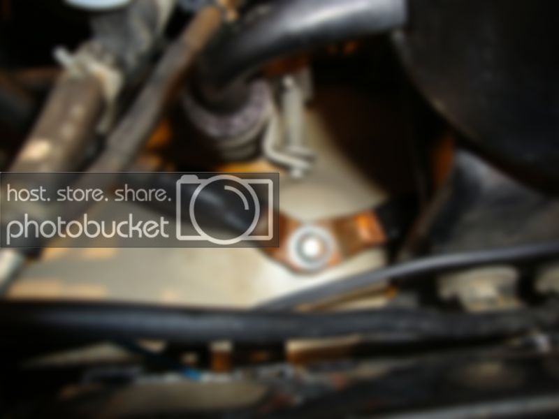

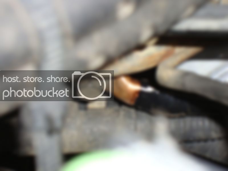

here's number 1 and 2 of the big 3. this is the battery negative to chassis and engine block to chassis. major size difference. i used 1/0 welding cable for these.

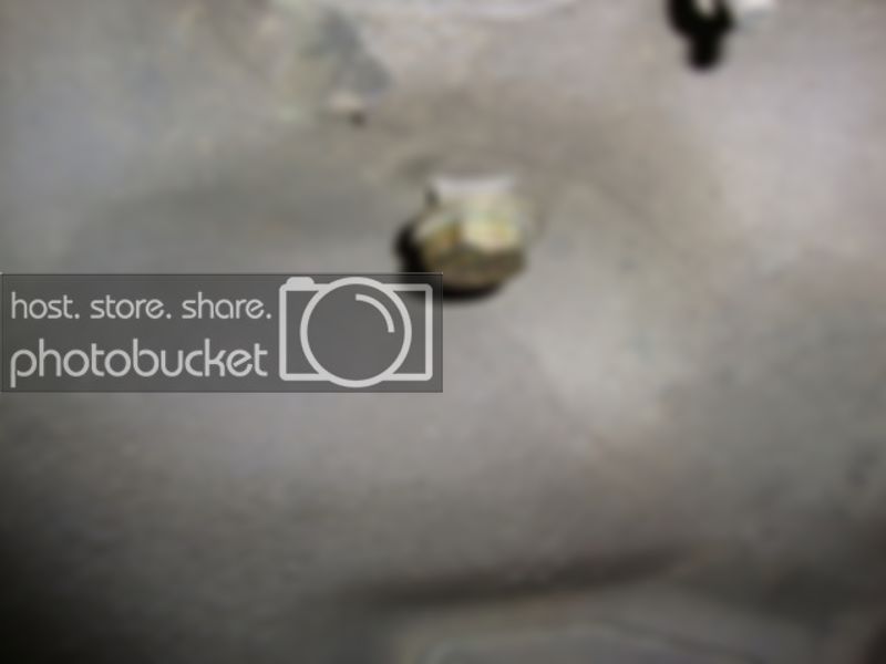

i drilled a hole in the inner fender and ran a bolt thru and secured the 2 cables with a lock washer and nut. this will have to be relocated when i bag the front b/c the fenders have to be cut out. but it will work for now.

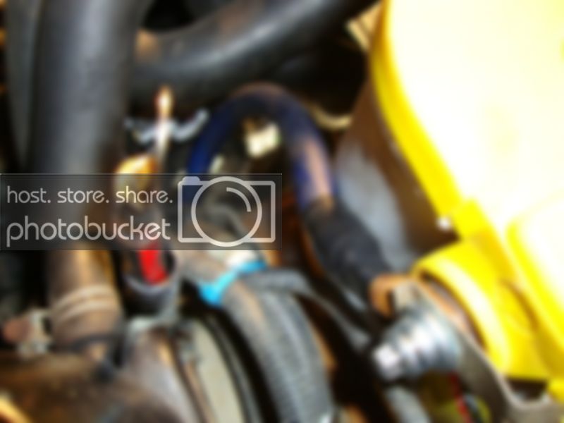

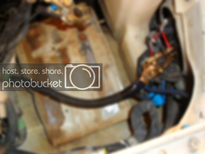

here's the 3rd of the big 3. batter positive to alternator.
and here it is connected to the new alternator...
this 3-phase project turned out great. (box build/system install, big 3 upgrade, new alternator install). the system is quite loud and sounds very clean. i have the subs wired at 1ohm so i have to be careful with the volume knob. it sounds very nice.
i got the alternator tested at advance auto parts 1 week after installation. 14.12v at idle and 14.05v under load. also, absolutely zero headlight flickering when the system hits.

and nope, no port noise at all, just a LOT of air blowing against the back of my arm when i'm driving //content.invisioncic.com/y282845/emoticons/biggrin.gif.d71a5d36fcbab170f2364c9f2e3946cb.gif
