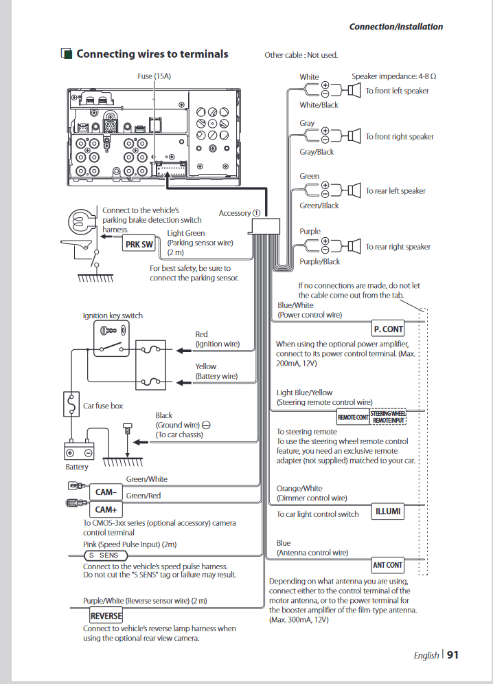

Ami doing something wrong? I think my P. Cont wire (white/blue wire) is not hooked up correctly. I read that Kenwood uses this P. Cont wire for power to the radios built in amp to produce sound. Am i wrong? does anyone know why im having this sound issue? My old head unit works fine. I plugged it back in to verify my speakers worked over and over.

Do NOT connect the P Cont wire to 12V or anything else randomly. It should never be connected to the yellow or red wire.
The P Cont wire is the “remote” turn on wire that turns on an external amplifiers mounted remotely in the trunk or wherever. Mostly for aftermarket amplifiers, but possible it could be used for very few OEM amplifiers if equipped in some situations. So this may or may not be needed, but you need to do it properly. This wires stays disconnected unless you need to use.

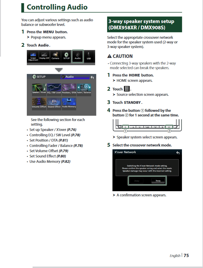

From the manual for reference and other members to offer thoughts as well.

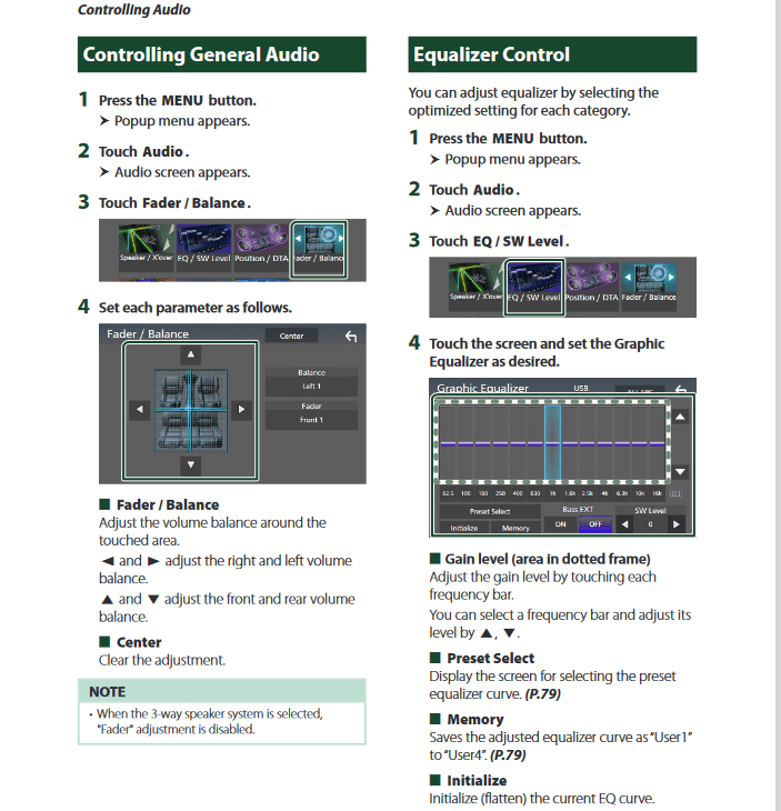

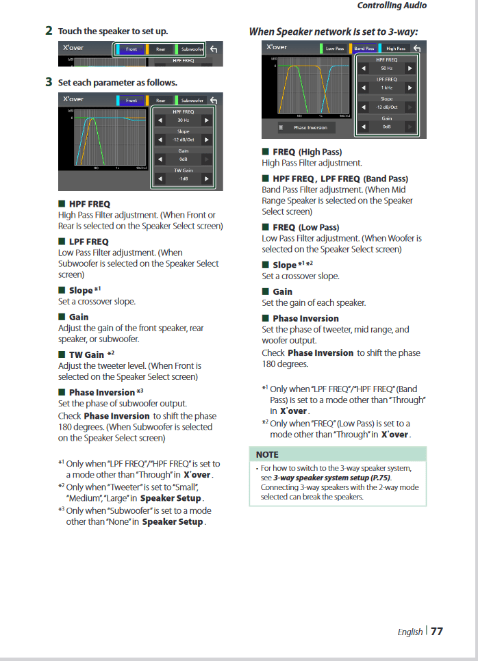

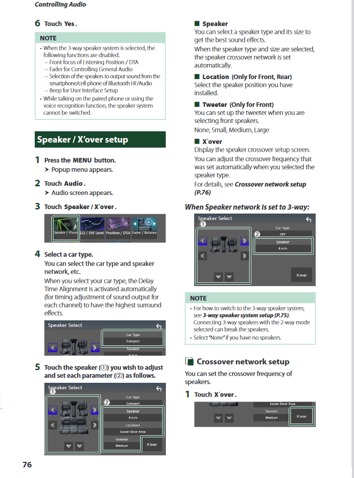

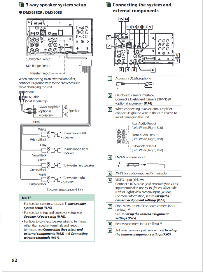

Some screenshots of the crossover stuff and such in the manual, and the last one that the deck apparently supports running active, so can use 2 channels to power mids, and the other two for tweeters, so make sure it is set to 2-way, you don't want 3-way unless running components. There are other pages of course with important info, but it shows that deck does have a lot of settings to mess with.
