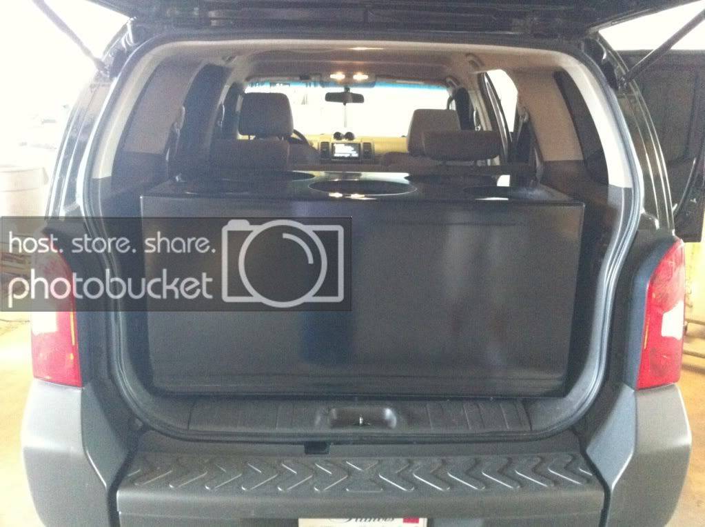

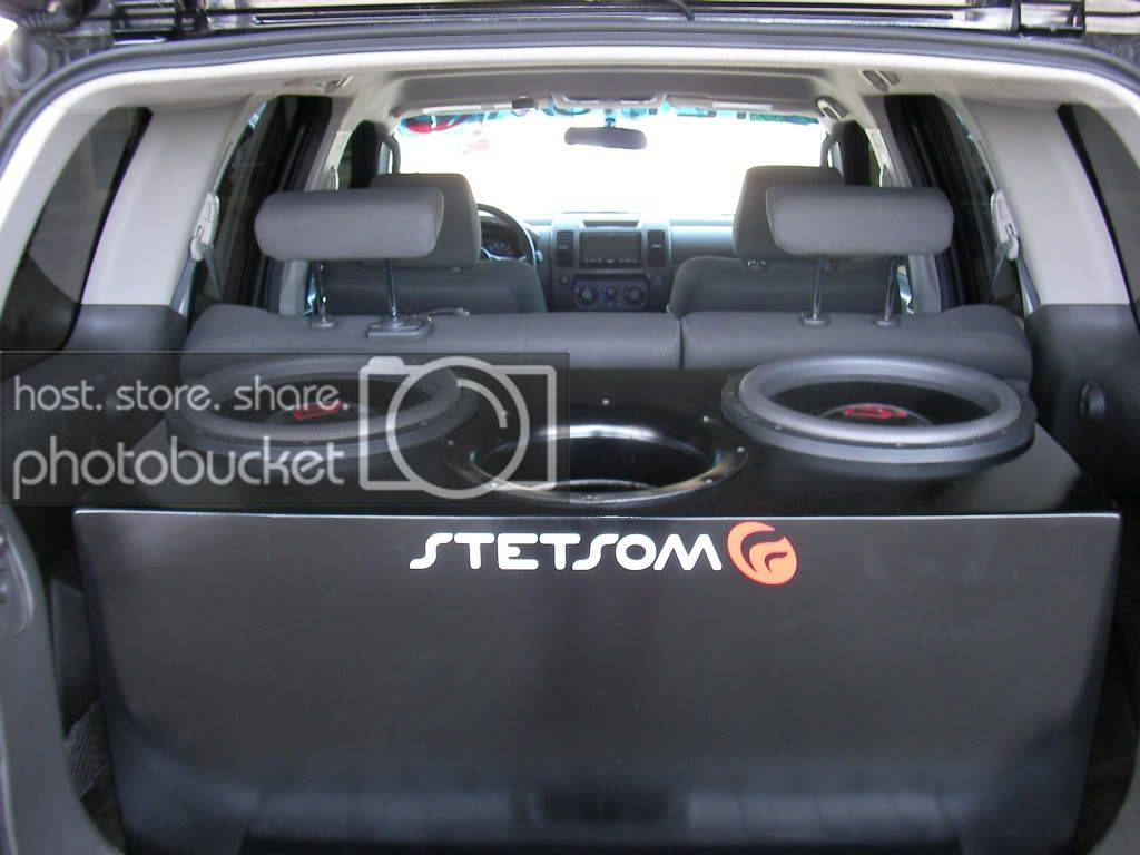

Now with having this much power decided to go with four 10's instead of the two 15's. This change is to allow to be able to play louder longer. Last box peaked at 151.5db with 5k power at 46hz and hope this one will tune to about 43hz but doing anywhere from 151-152db.
Old set up with two DD 9515g's

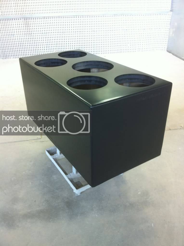

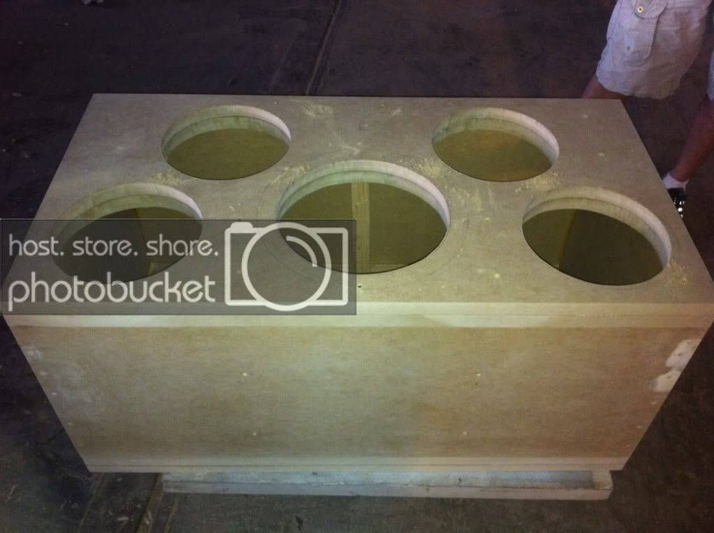

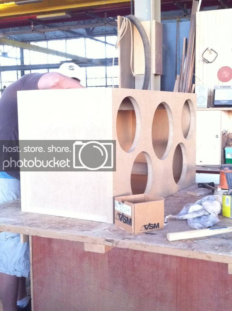

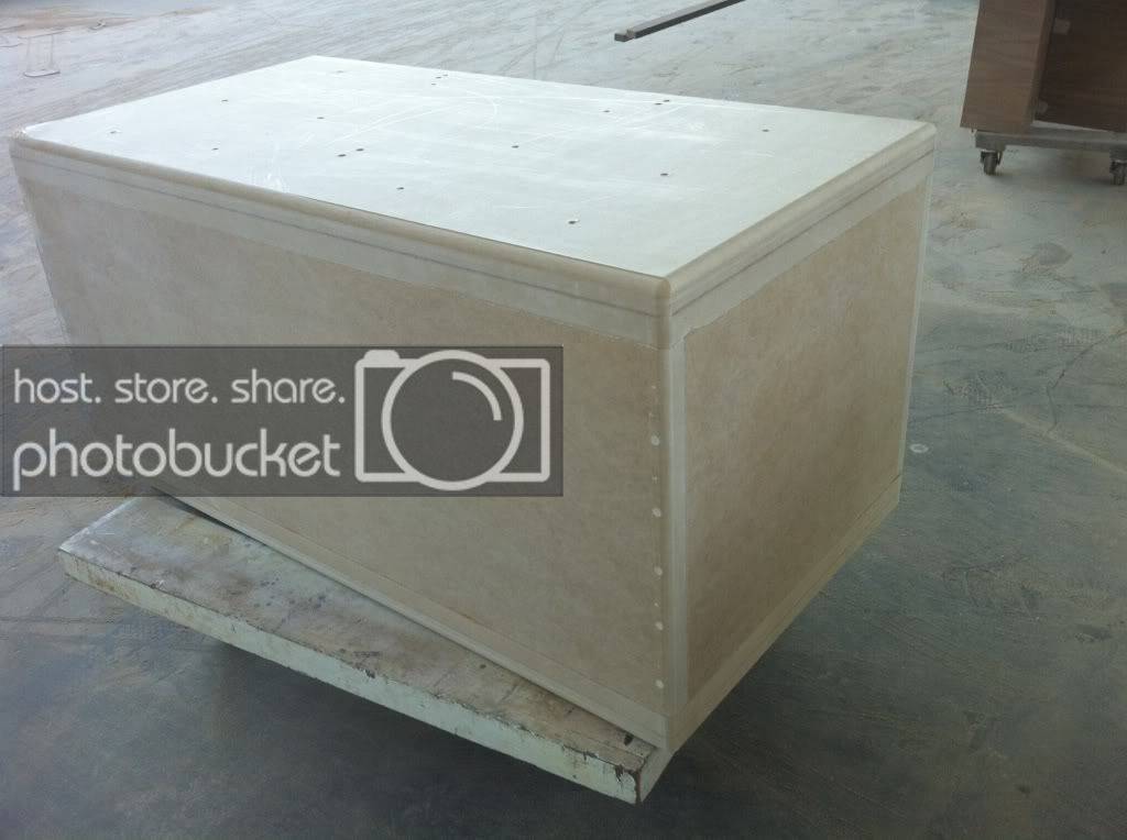

New build with four 9510h's. Using 1 1/8" mdf. Just waiting for port and next is testing. Some results soon to come.
i assume there was a lot of filler, sanding and priming to come up with a finish like that
Yes a lot of priming and sanding but not as much filler as there could have been to make it perfect to hide the lines. And it's was finished with a veneer finish. Looks pretty sick.
