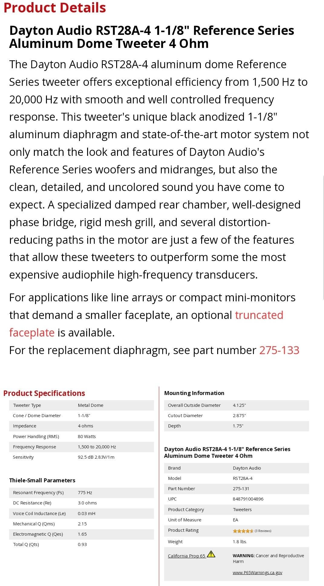

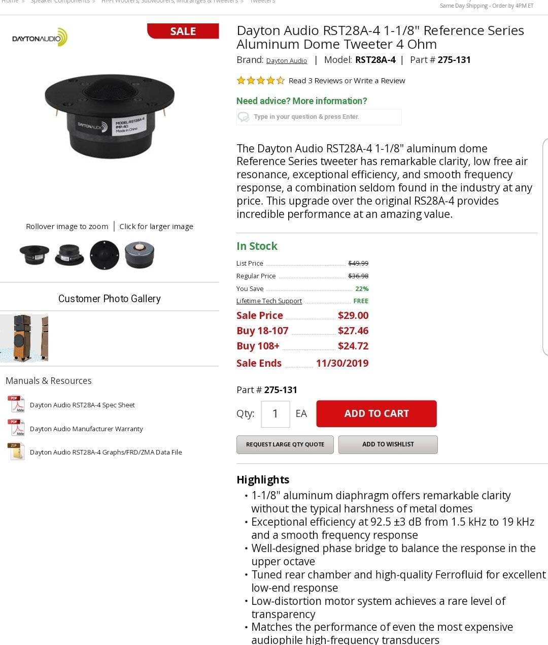

Do you like these? Only 80 watts rms. I would run them off the Taramps DS250X2 and then run the Pioneer Pro 6.5 and the ABVFL65MB off of the Taramps DS800X4. Thoughts?
My buddy chris likes those rs28s in his mustang. I think it'll be fine
I already ordered the Pionerrs and some Pac Bass blockers. If they sound like crap, then, I will order the Daytons. What should I be setting my Bass amp at crossover wise? And, what should I be doing at the HU with the Bass crossover and subwoofer level. The gain is only about 1/3 at the most right now. The pressure in that little car is pretty intense.
