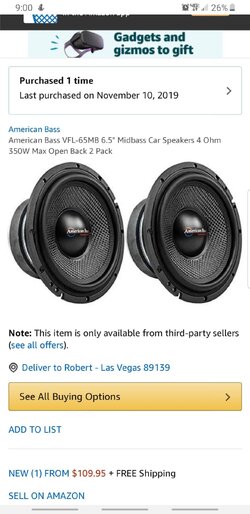

It seems like my DS250X2 puts out more than my DS800X4. Could it be a speaker difference? The DS250X2 is pushing Pioneer Pro 6.5's and the DS800X4 is pushing ABVFL65MB's. I can hear the rear Pioneers on 125 watts over the AB's with 200 watts. Why would that be? The gain on the AB's is maxed out.

Both two ohm amps. AB's in doors and Pioneer's in rear deck. I thought the AB midbass with 200 watts would be a lot louder and stronger. Barelyvaudible at this point.
