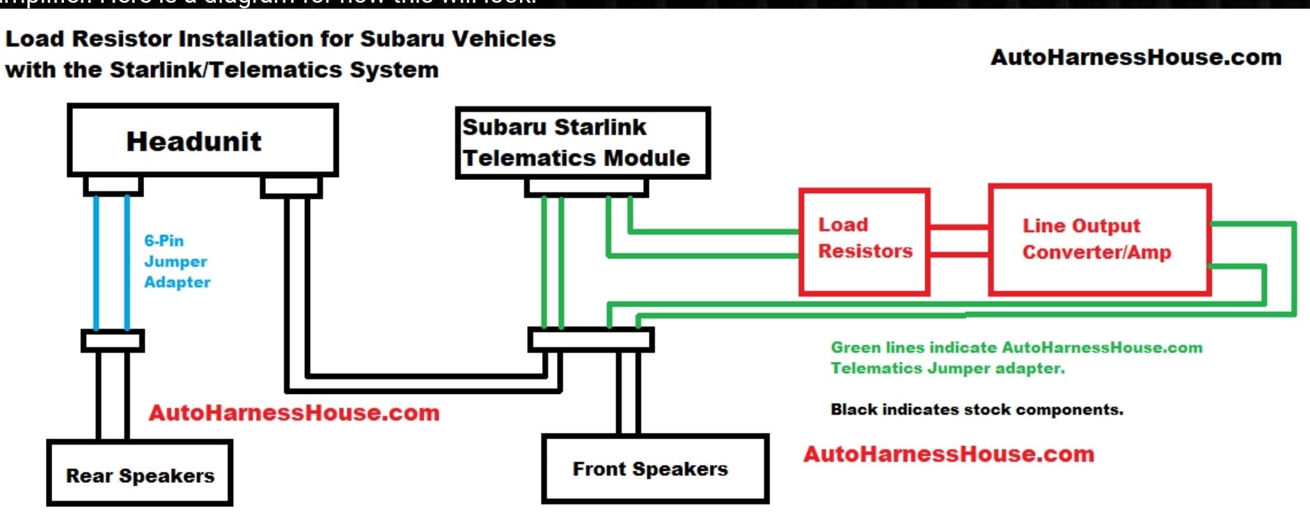

Yes I'm running the Starlink telematics. I've already purchased a jumper harness from Autoharnesshouse.com in order to grab the front signal and install LGD's after the telematics module as shown in this schematic from their site.
M
