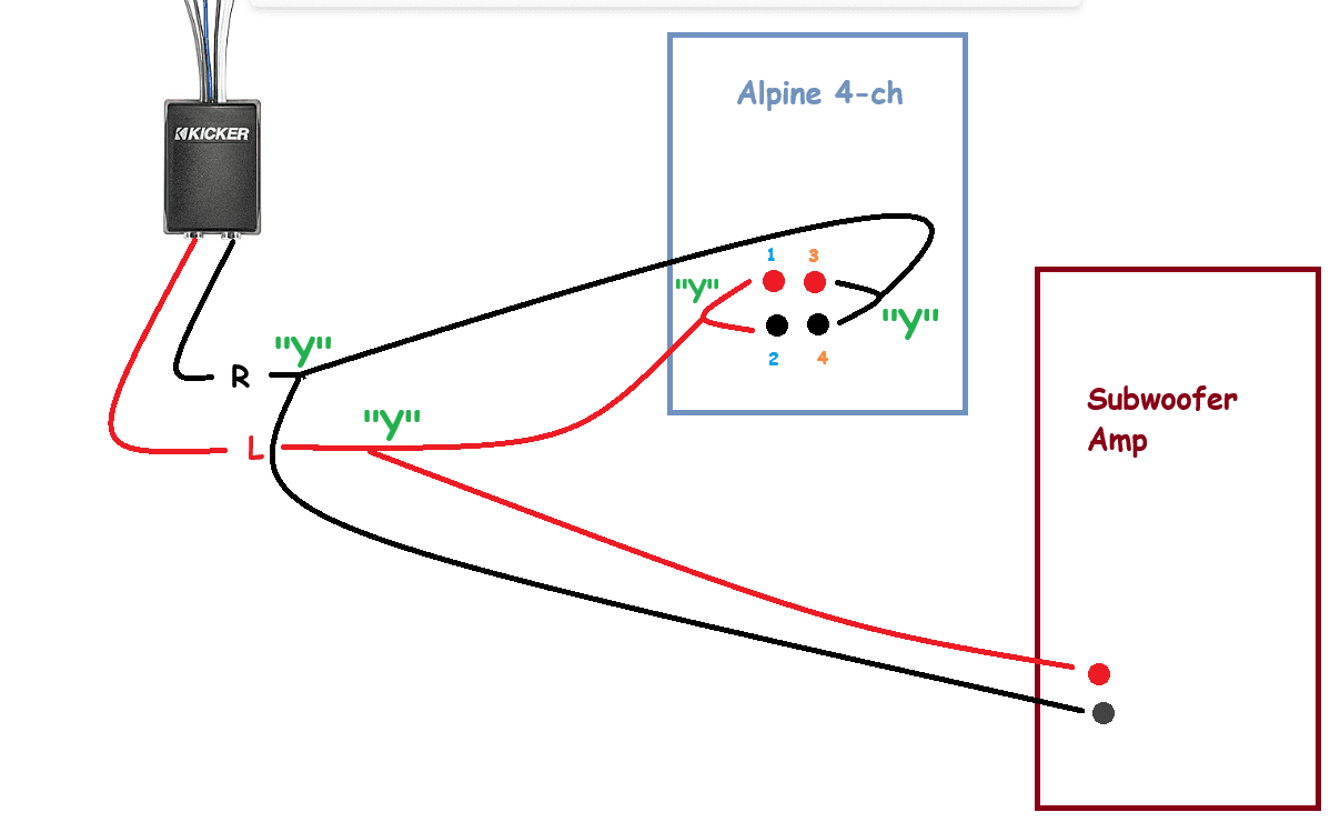

Here is where it gets a bit confusing.
You will run a y from both of the kicker LOC outputs to split them into dual right and left outputs. You will then take one R and one L, run those to the Alpine, use another set of "Y" splitters at the amp to get dual R and Dual L to the amp as I demonstrated earlier.
You will run another R/L RCA cable from the remaining L/R outputs off the LOC to the subwoofer amp and use the crossovers on the amp to set up your subwoofer, probably somewhere between 70-100 hz, wherever it blends best with the focal sets up front.
Here is a rough draft of how that looks.
This is the best way to setup the system with the existing equeipment.
