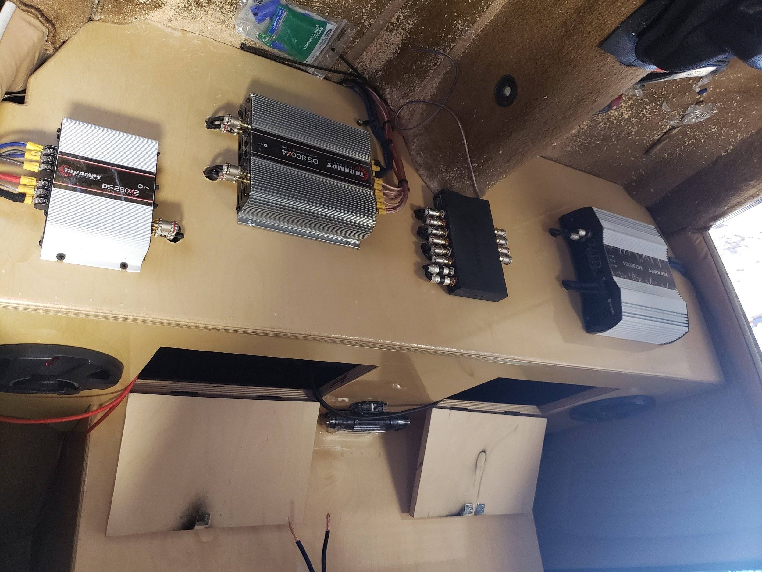

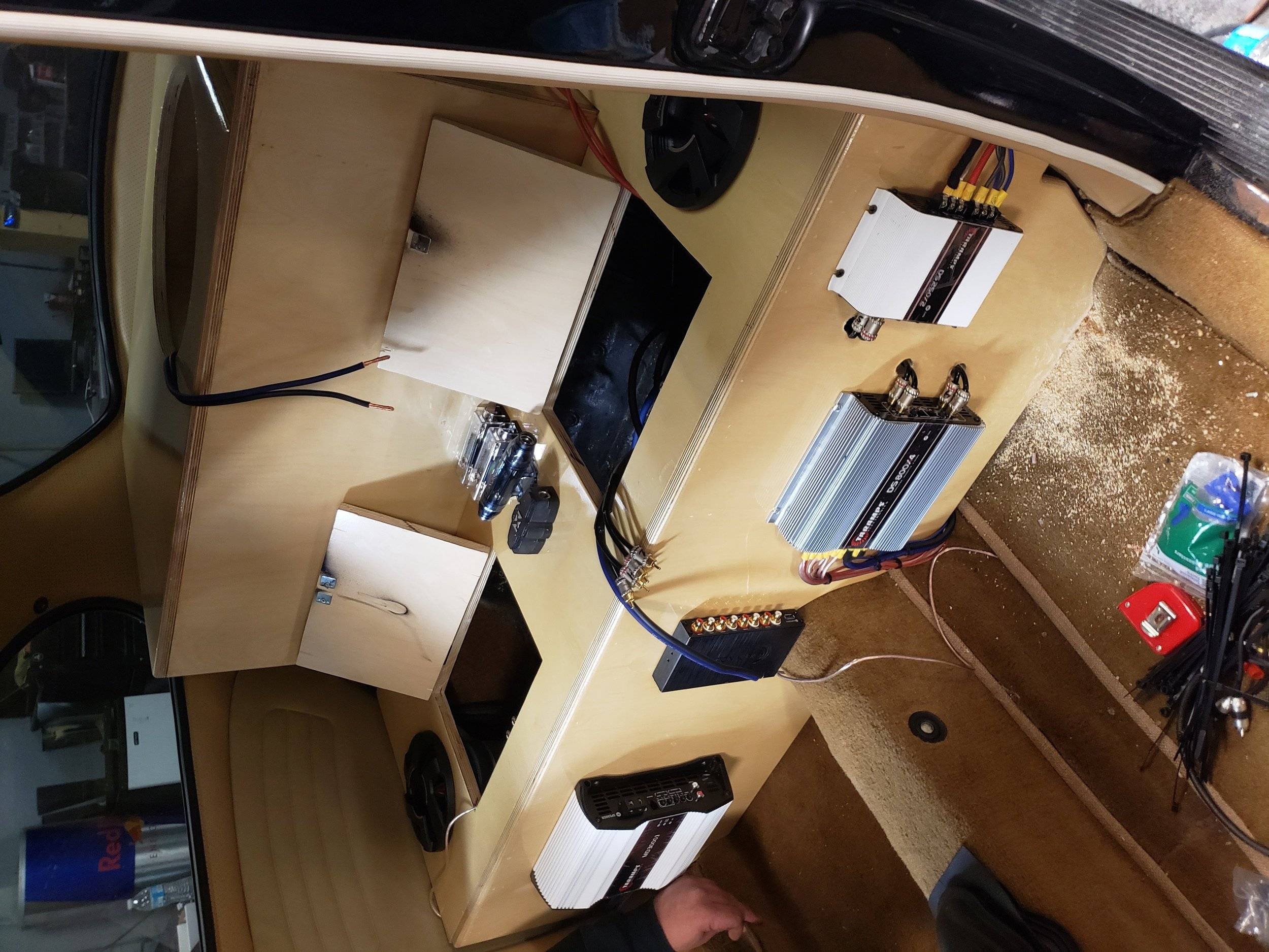

I have the app on my phone. When I initially turn on my system, what settings should I have? It looks like everything is at zero right now. My setup is:
Taramps DS800X4 (200x4)
Channels #1 and #2= front tweets, Pioneer pro 3.5
Channels #3 and #4= front midbass, AB VFL65 MB
Taramps DS250X2 (125X2)
Channels #5 and #6= rear midrange, Pioneer pro 6.5
Taramps MD30001 (3000X1)
Channels #7 and #8= subwoofer AB HD15D2
Any help is deeply appreciated. Installing right now.
