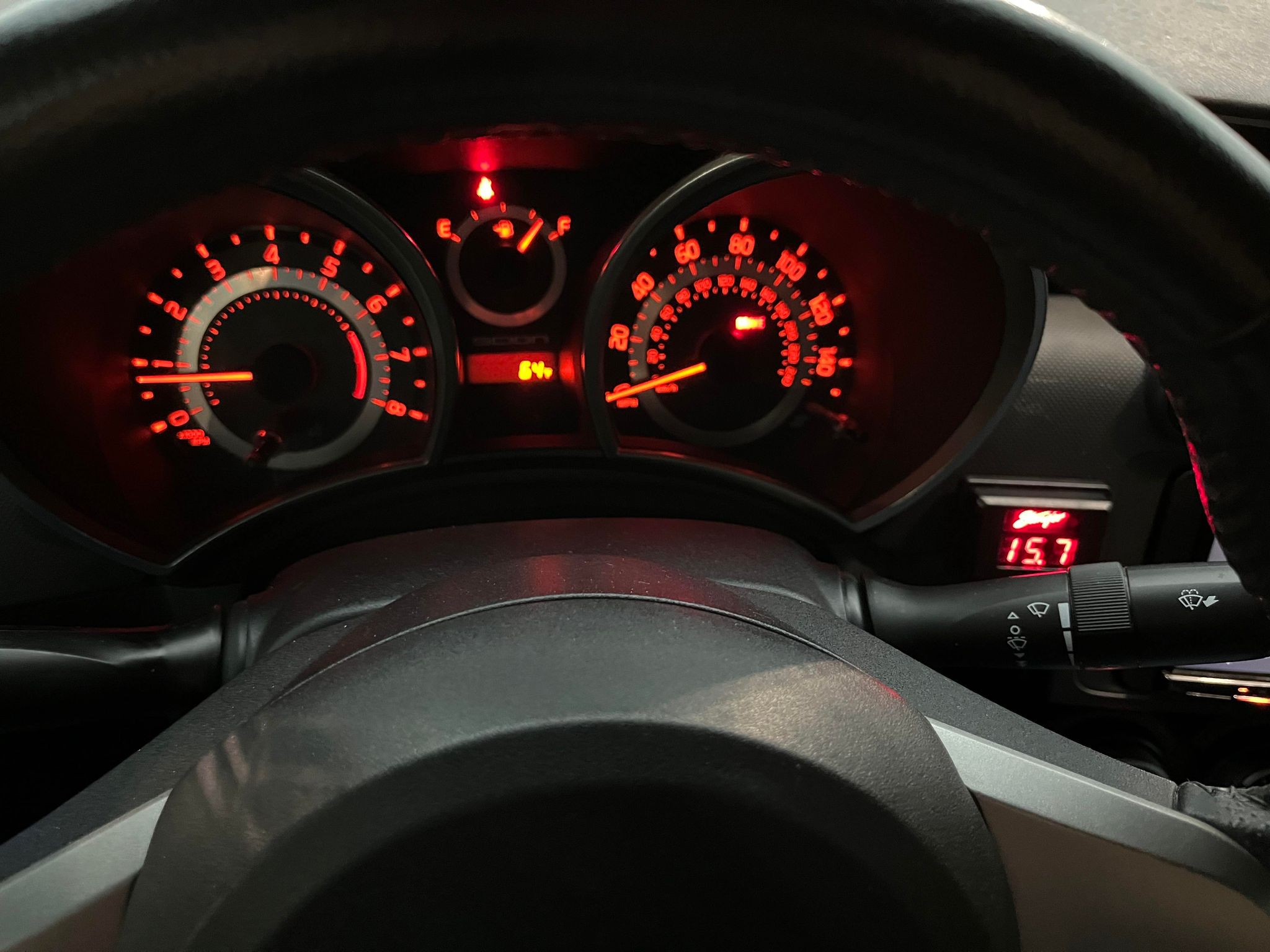

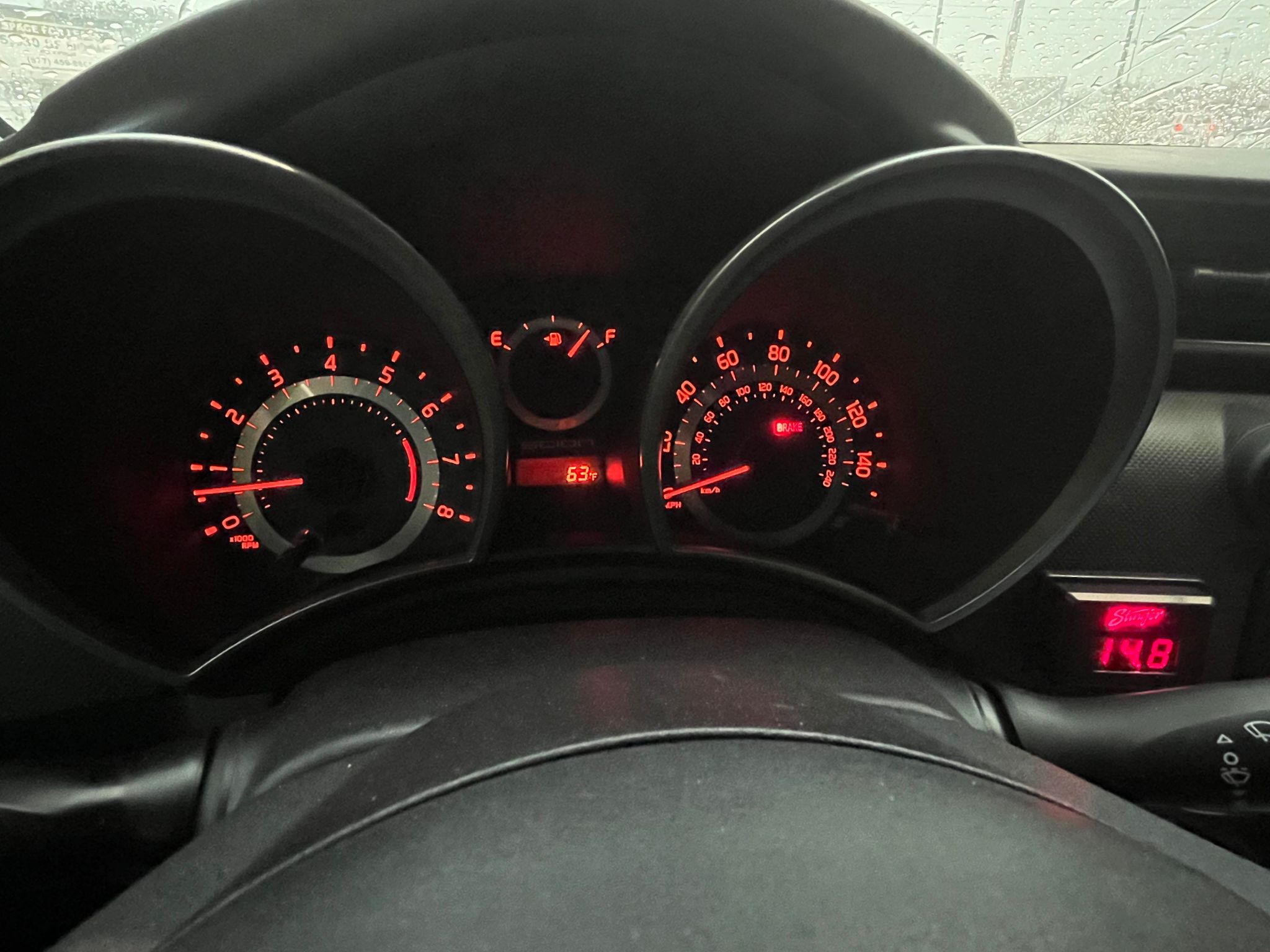

At 650+ RPM voltage is great. Under 650 and it drops to 14.8 and keeps dropping slowly as the alternator is not charging at all. I'm just getting tired of having to keep my foot on the gas when idling. The low voltage alarm on my ISDT battery monitor is quite annoying. :LOL:

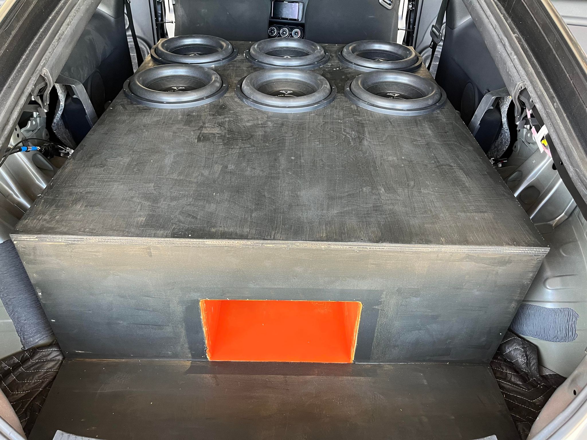

I would have never guessed six 12’s in that car!
I should have done 8.... :ROFLMAO:
But if I do upgrade these have caught my eye.
6 12s my God I know it's monsterous those cars get loud !!!!
