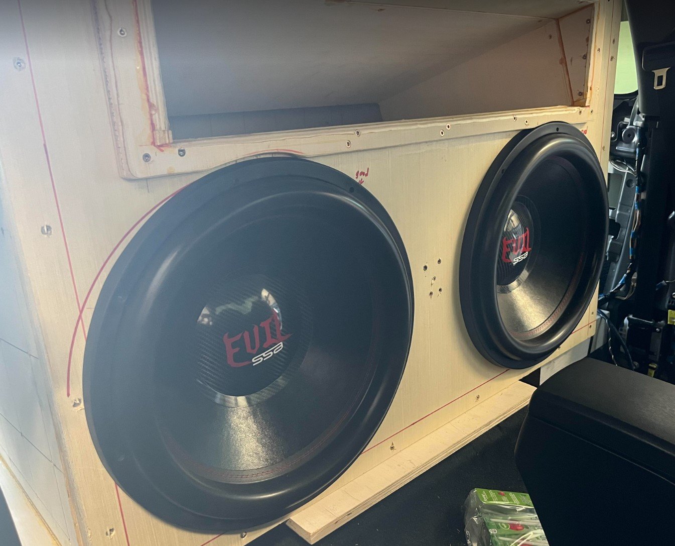

Port needs to be shrunk. I get zero velocity out of it and not much subwoofer control with lows. (n)

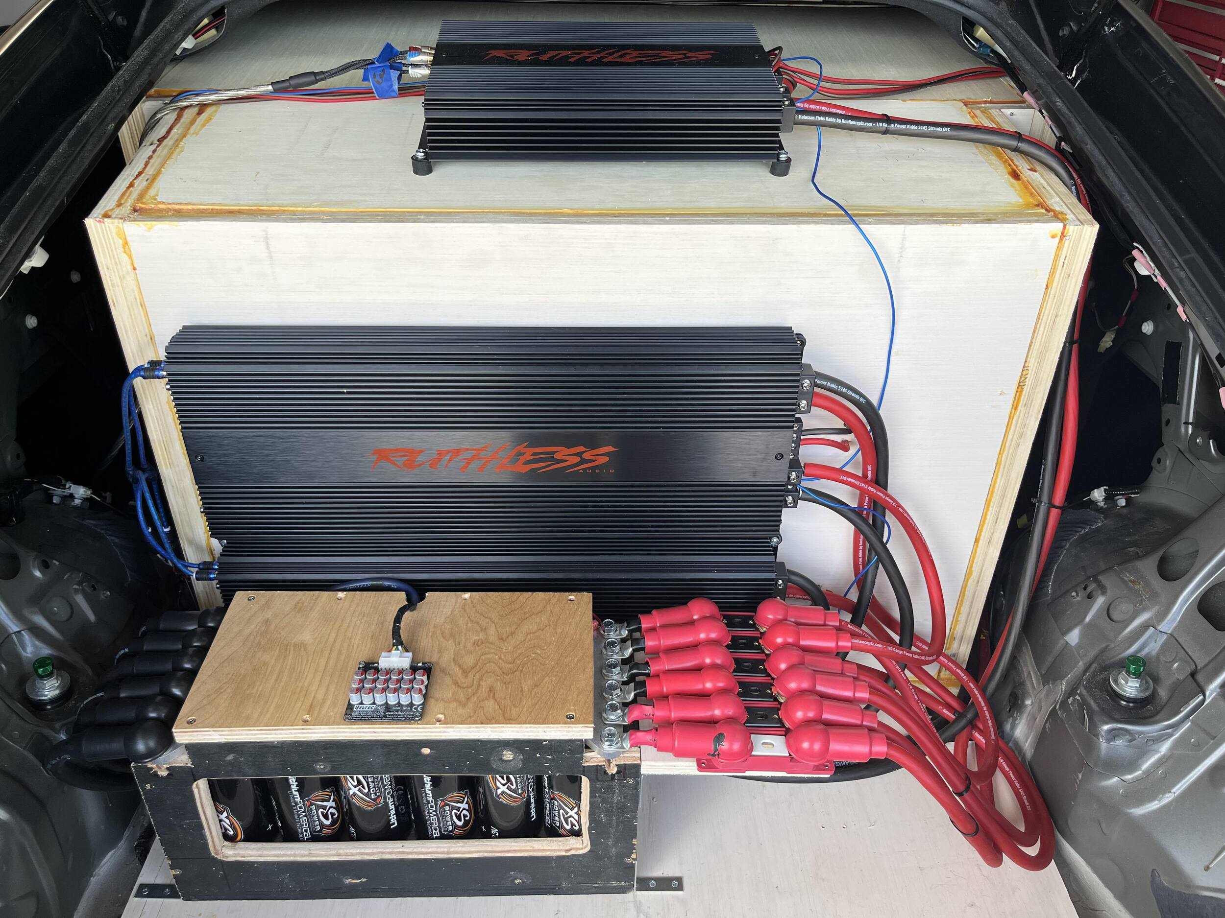

75 volts AC should be 5600 watts out of each amp. Have not gone over half gain on the knob.
Wiring "done" and amps gain matched. Set at 75 volts AC clean 40hz -5db. I don't remember the formula to determine wattage. :unsure:
Both subs are in and it's playing. I'm tired and have to be back at work at 4am tomorrow so I'll play them on the way in.
Man as long as you gained matched the amps, I wouldnt worry too much about wattage as you tune for your liking and free from that Dammned Clipping area,and what the cars electrical can handle and amps on low notes

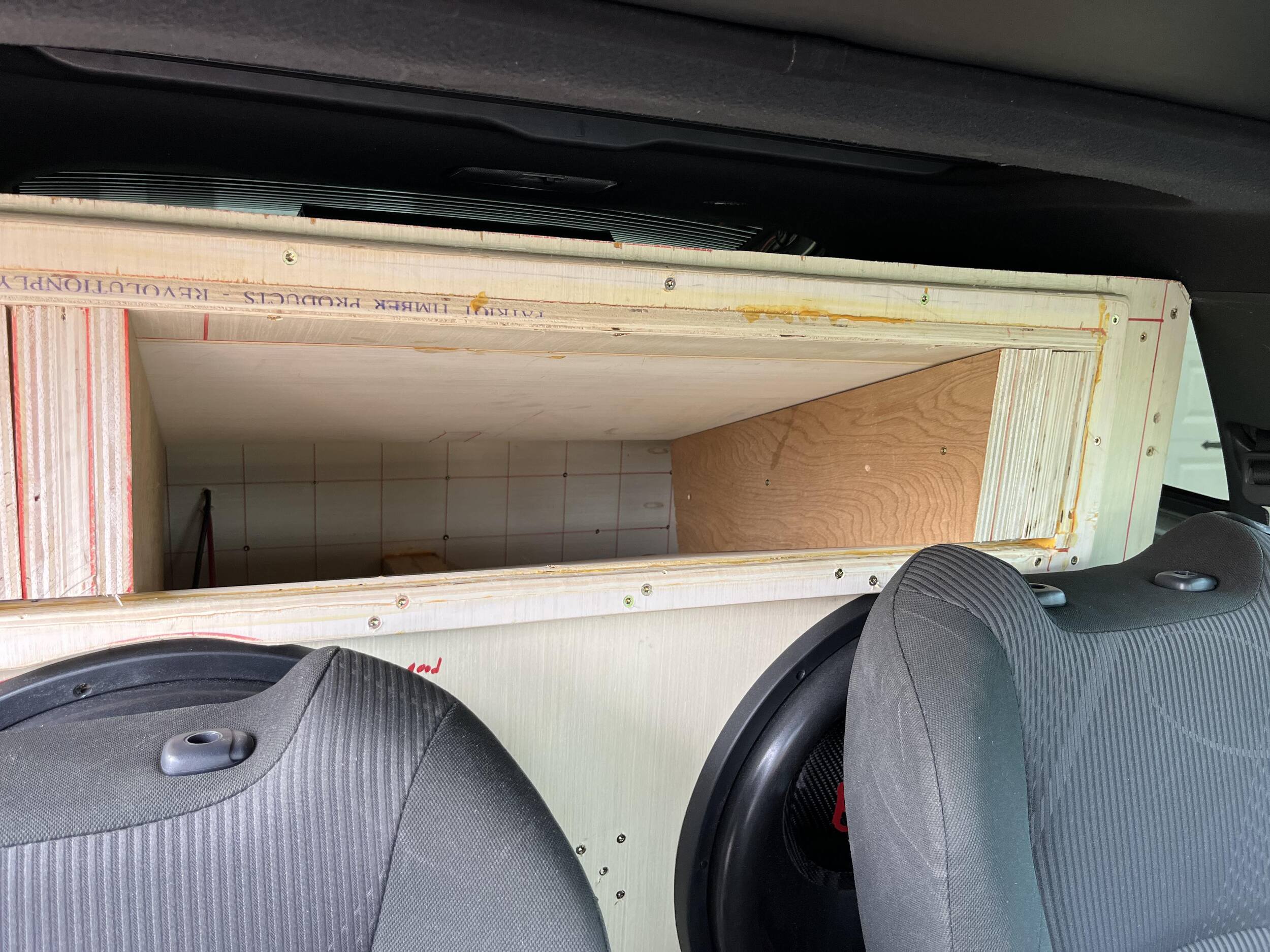

Got some time today to work on it. Shrunk the port quite a bit. It's better but far from perfect. Top and bottom are single layer and flexes badly. Will either put a brace all the way down the center or double layer it. Maybe both.

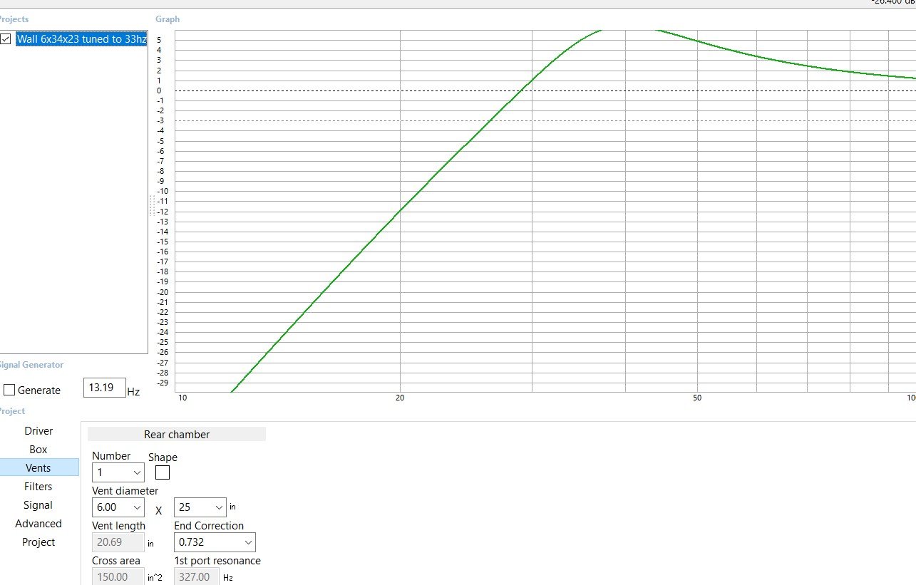

It's now 6t x 25w x 21d and tuned to 30hz. Should be around 150" of port area.

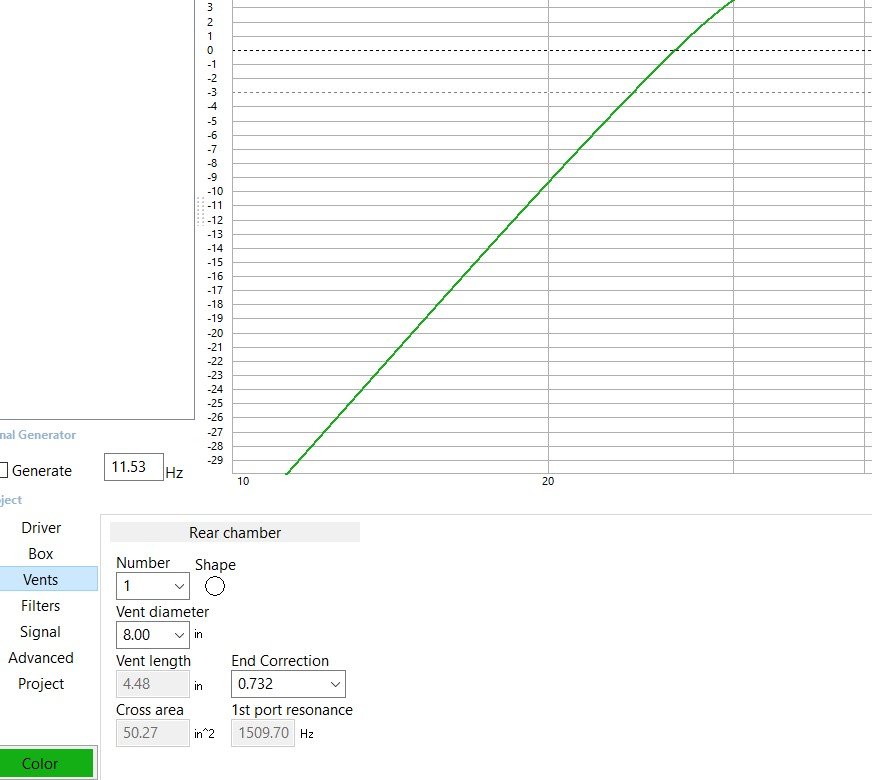

I was thinking hard on Aeroports but the smallest I could do would have been eight 6" or four 8" aeros.
Area of a cirlce is pi*r^2 so a 6" aero would be 113 square inches of port. 6 of those would be a biiiiit too much lol. a single 8 inch aero would get you 201 square inches. Just some food for thought.

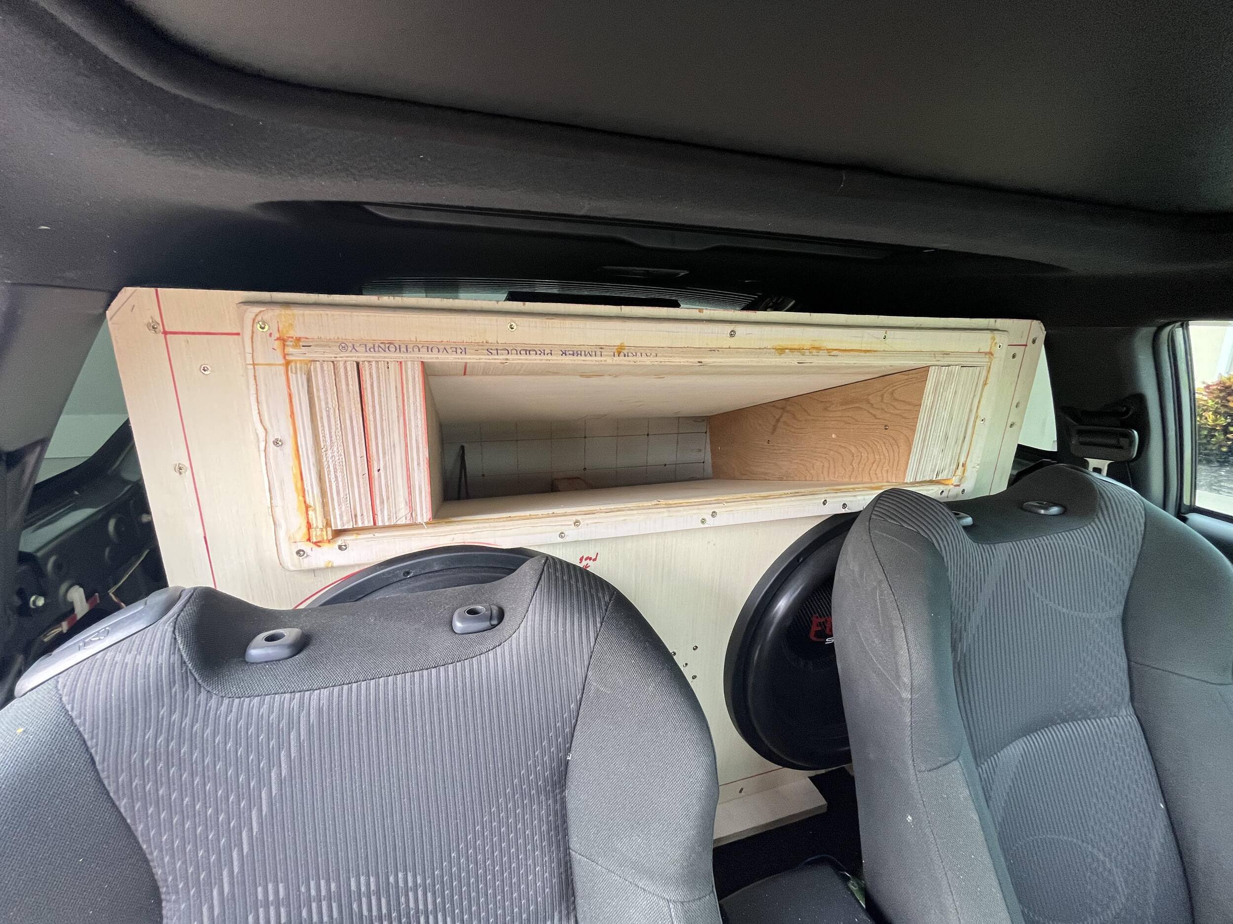

Alright so I braced the port really well and it doesn't flex anymore. Setup hammers anything 35+ but is very unimpressive with lows. My port took up like 2 cubes so the wall is probably around 12 cubes net now. Pretty unhappy with it honestly. I really have to give these subs some power to get loud and they get smelly pretty quick with zero clipping.
No matter how I model it in WinISD it seems to peak in the high 30s which is what it is doing now.
:poop:
This is how it is now. Tuned to 33hz. If I added some length to the port I can get it to 30hz. But I'm thinking I'm just going to redo the whole baffle. It's not glued in just used thick weather stripping and 3" screws to seal it up so it would be easy to remove.
That was a pretty dammned smart idea. I would have never thought of doing something like that.I would have glued and screwed
