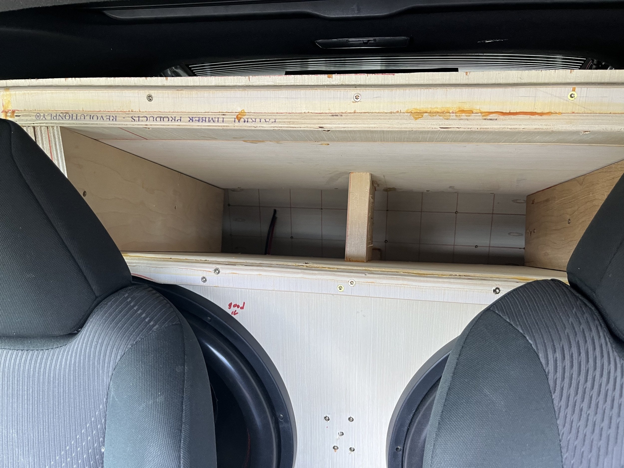

Alright I'm going to seal off the wall and extend the port some more. Possibly cut the port in the middle and 45* it to get more length. If I'm still not happy I'm getting rid of the 18s and getting 4 Sundown Xv3 12s.

The box is 12 cubes net 🤔
Trust me I regret not getting the Fi neos or Fi MTs over the Evils. :poop:
The evils only have 3 spiders and an FS of 25hz though.
I never believe TS specs 🤣. You can pull them yourself and they can be drastically different. 3 spiders from one can be very different from the other as well. You can get those evils to get low the problem is you probably will need 8 cubes each to do it. Many of the high wattage subs have very stiff suspensions and require a large enclosure to get that nasty low end output. It’s possible if you call Fi they can do two layers on the spiders. I don’t know the deflection rates on the spiders they use or they stiffness of the surrounds on their cones or I’d be able to tell you what to order. If they are willing to give you at least that info on the spiders, I can tell you what to go with.
Yeah I don't believe them either. Even their site says they are 77 pound subwoofers yet the shipping boxes with plywood inside said 74 pounds. I did have my SHDs in a massive wall and massive port and they played amazing.
Think a different set of 18s is the way to go over 4 Xv3 12s?

I’d take 2 18’s over 4 12’s 8 days a week! 2 18’s have more cone area then 4 12’s and those two Fi 18’s would cost less too.
My reasoning for the 4 Xs is I would have more baffle space for port and I think they would do well in the box size I have. Plus they are some low end monsters.
They would most definitely work excellent in the box you have. Cause I’m lazy and don’t want to go back to see if I can find this info. How many sq inches of port area do you currently have?
Honestly can’t remember what it’s at right now. I want to say 190. I keep playing with shrinking. I’ll measure it tomorrow.
Honestly can’t remember what it’s at right now. I want to say 190. I keep playing with shrinking. I’ll measure it tomorrow. View attachment 54602
190 you are on the bigger side for port area. In 12 cubes depending on the subs of course, I’d bring it down to 160. Id still be doing those 18’s but if you had to go with 12’s, I’d do 4 Fi neo 3.5’s with 2 spiders. They sell them with that option so no reason to even call or ask.
I'll drop the port area some more and see how it does.
