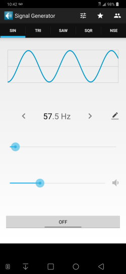

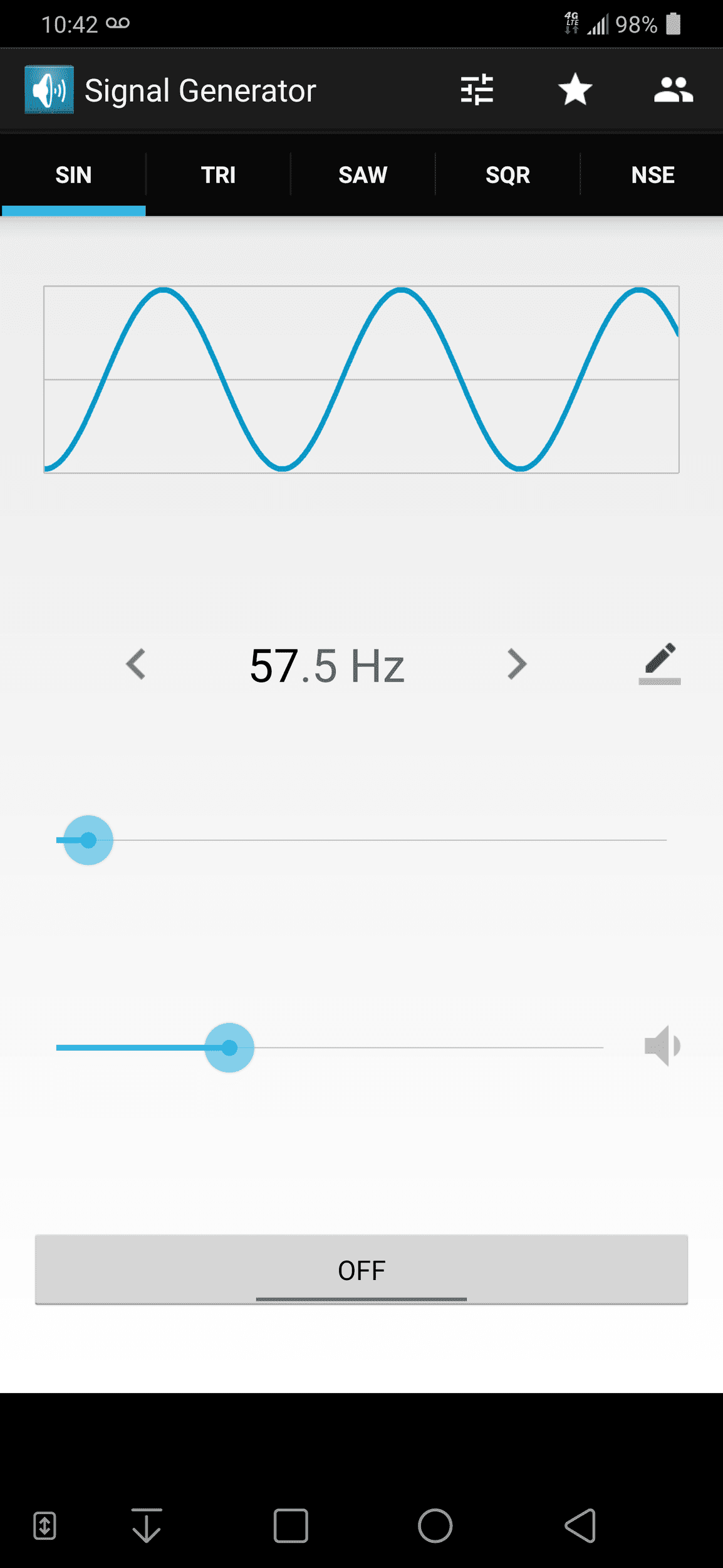

Switch the multimeter to AC volts and play a 50 Hertz tone at your usual listening volume. I use one called Signal Generator I got free off the Playstore.
