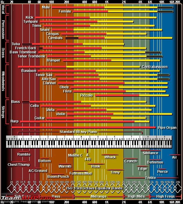

Most actual music played on musical instruments will contain little to no material below 40hz. Even most EDM music I've played will not dip below 35hz. If you do not plan to listen to "bass mechanic" type music or slow speed recordings or similar 35-36 should be plenty low to handle pretty much anything that would play on the radio.
I would agree that 45hz tuning is going to be a bit high for a good range of music. That and higher tuning is typically reserved for SPL burp applications where you're aiming to just play very loud around your car's resonant frequency which usually is 50hz or higher for most common vehicles.
Anyway, you will notice that some horn/string instruments will play 30hz and lower but if your goal was to reproduce a concert hall sound, you could still get loud enough to be realistic even with higher tuning as the port will control the cone a good bit below tuning frequency.
