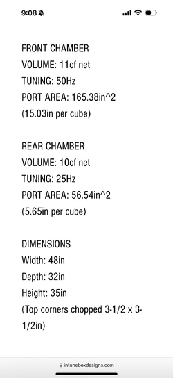

So I currently have 2 enclosure blueprints that im undecided which one to go with. They are for 2 18s Adire Audio Kh3001 and are gonna be powered by a taramps md8000.1. Ones is a conventional sub up port back and the other is a c-pillar 6th order. Will be going in a 2003 GMC Yukon.

a bandpass is a pretty large box for 18's. However, I had a Toyota truck with a bandpass in the bed and a cut-through from the bed. I tuned it perfectly and it sounded really fricking good. If you have the room, go with the 6th order.
Yea I had a 4th order blow through in a single can pick up. I have no use in my Yukons 3rd row so I can go as big as I want
That's funny! A daily musical pounder is something with 2-12" subs. You're talking about 18's. Not too many people will consider that to be a "daily musical pounder." Those are more like a "daily attention getter."
I had 2 15's in my saturn vue only because I couldn't fit 18's...that was for daily bumping. It was loud as fck inside the car but not very impressive sounding outside it 🤣🤣🤣
