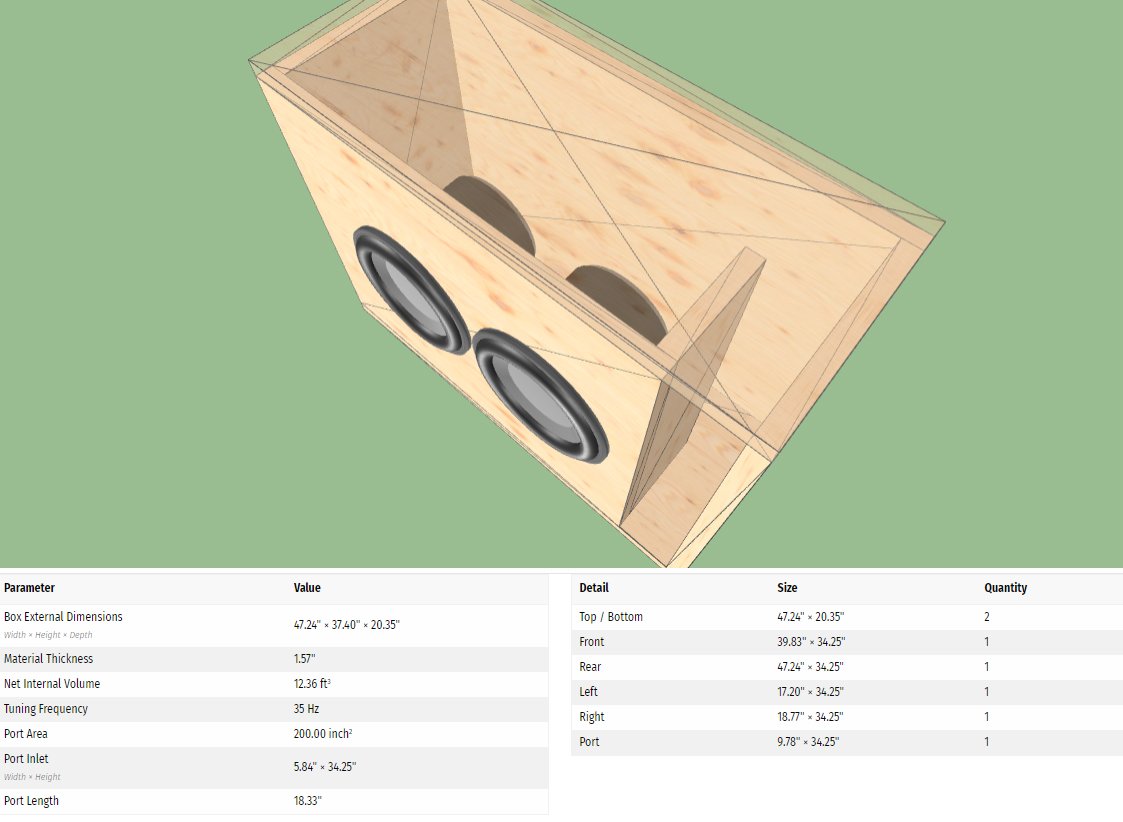

Thank you for your answer. I have at the moment 4 agm batteries 100ah each one, and a 120a alternator that i will upgrade to a 320 soon. My car is a tiny Fiat punto van, that allow me to build a reasonable large box. 350 liter (12 cubic feet) using 4 centimeter (1,5 inch) plywood. Pride in the manual says to tune at 30hz, would that allow me to feel the bass physically outside the car or for that kind of bass is better a higher tune?
Those look like decent subs. I have this sub specs saved in the database of my enclosure designing software. I never got to build the box for it though. I had a friend from Kazakhstan who was going to use it, but he got deported before the build came. The box I have saved in here for him was 3.2 cubic ft, with a port tuning of 29.
Would you kindly share that with me?
I would not tune that low if you intend to play actual normal speed music.
That said, use every bit of that 12 cubic foot gross space you have and use 300 square inches of port area. If your box is built solid you should not have any issues being loud everywhere.
300 square inch of port? Holy! That huge?
My mistake, 150-200 for 10 cubic foot net box should do well. 300 will be impractical if you're not doing a wall build and likely not gain much over 200"
if you google "Salvati loudspeaker white paper" First link should be scholarly article explaining how more port area = more efficiency. Typical "cookie cutter" box designs use 15-20 square inches per cubic foot of internal airspace.
The "DD Box" will typically get very loud with a critically over-damped (huge motor and stiff suspension) sub.
If you feel you need lower tuning make the port longer, but I would suggest going no lower than 15 square inches per cubic foot of box volume.
[/URL]
Thank you very much, i appreciate your comments. So 30 is a bit low tuning for normal music, and people tell me 45 is too high because then it will not play the deep notes, so 35 can be a good solution? Remember, for me the only real bass i need is the one you can feel outside the car, not only hear, but feel too! Sorry for my english, i'm in italy
