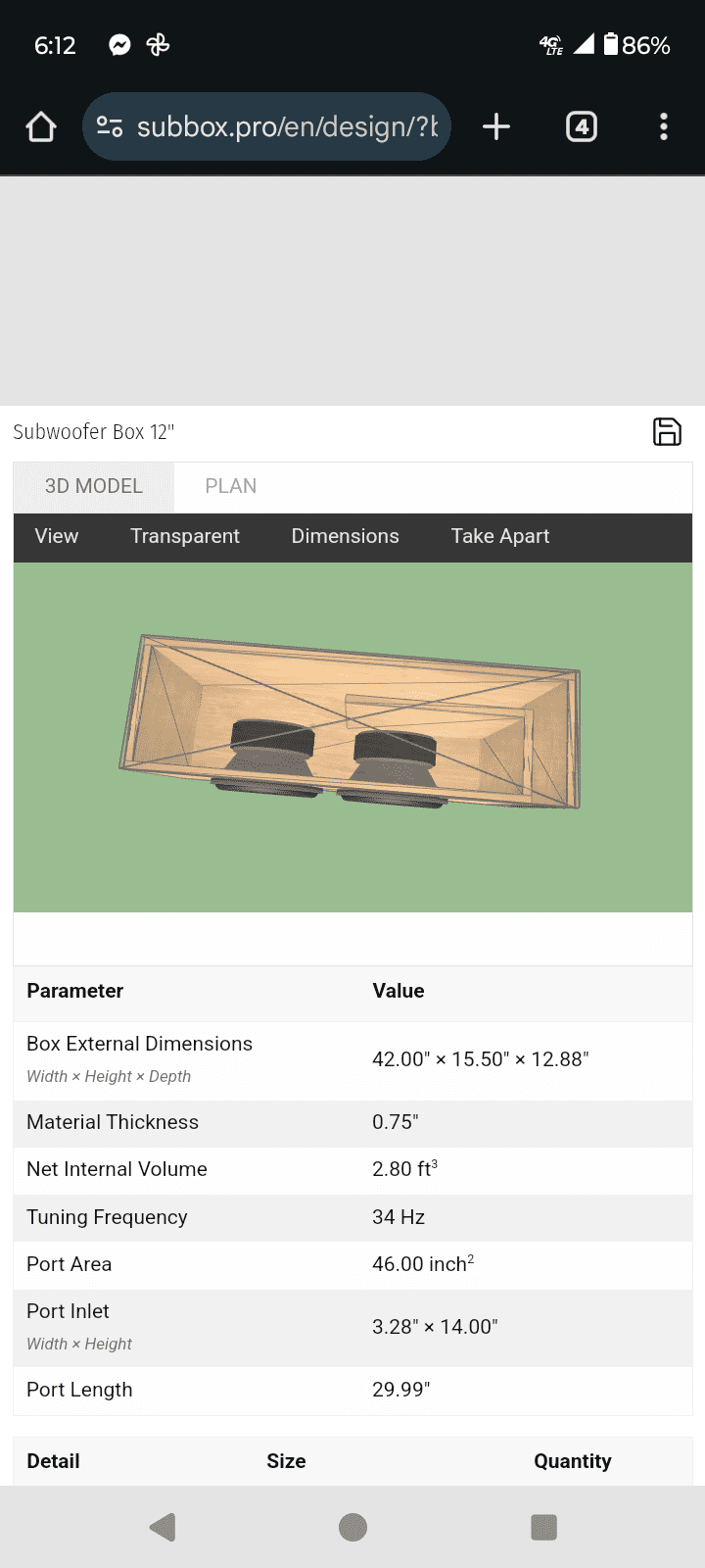

Do you have any room to work with on the height? This is a mockup I made using free software (not best the best but good for reference) the only issue is that you will be missing out on a lot of output cause the box will have to be tiny. This is using the absolute minimum airspace specs for those subs(1.4 cubes each) with about 23 square inches of port area.
after seeing you guys replies, honestly how much taller would i need to go ? i in reality could go taller, i just measured up to where it aesthetically looked nice along my back seat. I'm super interested in these B2s so im trying to not let those other people tell me the spec sheet doesn't make sense haha! and if it matters i do want to run subs up port back ideally. I just love how that looks . im not trying to go crazy with this build so i definently don't want to run 3k. This is a more SQ build than SPL. I thought the 1600 sounded like a good pairing for them but being told they wont sound good at that level confused me even more. I almost feel like i was trolled haha
