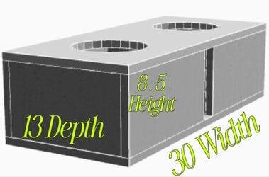

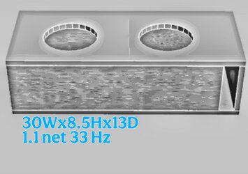

5t4y_50L0
CarAudio.com Recruit
INVERTED SUBS
(Two) B2 audio 8 in V2
30x13x8.5
Port 2x7 25 in L
Looking for 1.1 net at 33 Hz
I don't have much room to work with.
Iv seen people online with 1.1 net box for the same subs, so that's why I feel comfortable with that net volume. I don't know how to use winisd or bassbox pro 6, I have both.

To shrink the enclosure I'm wanting to run inverted, my goal is 1.1 net
With subs on top and inverted
30x13x8.5 33 Hz 1.1 net
My depth cannot be anymore than 14 in. I need room for groceries. lol
So I'm trying to do the minimum box space for ported on my specific drivers

After modeling up 2 Rage 8's in 1.1ft3 (Rage or Rampage?) I'd go with 20-22in2 of port and understand that once you start trying to save space or seek output compromises occur.
I'm a longtime forum contributor and tend to read between the lines... are you asking for a full design?

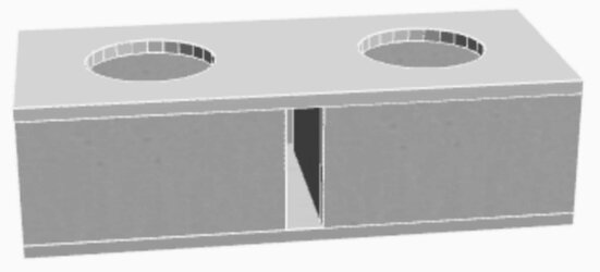

One idea I had was to create 2 separate enclosures and connect them side by side after installing. External width at 14.5 to create a 30 width.
Option #2
30x14x8.5: 1.1 net
The split cabin/center port with subs on top allow the port to vent freely through the backseat.
Also allows me to reach in between the inverted subs and access the emergency trunk release
Option#3
30x13x8.5: 1.1 net
Front side port, shared cabin allows one inch less in depth, (1 inch more for trunk space)
My current box is 19 inches in depth, so enough room for one 24 bottle case of water. (roughly a foot)
Plus with the depth decrease from 19 inches I can also open the fuse box/air compressor aka spare tire hatch. Where I plan to put my amps and LOC.
If anyone wants to accept payment on this forum for a design let me know your price, the guy I use has a website, 3D visuals and same day turn around. I got 4 builds so far.
