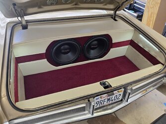

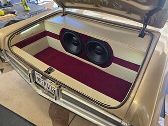

65 deville. The port is vented into the cabin, the subs face the rear. There is about 48x16 open space between the rear seat and trunk to vent.
I was talking with other classic car owners that have ran into the same issue and they recommended bandpass vented directly into the cabin.
Here are pictures of the car and trunk

The whole way you have the current enclosure is your problem, cones in the trunk with ports in the cabin... I've seen this type of issue happen a lot. Some people actually advise this is a good way to install an enclosure... haha.

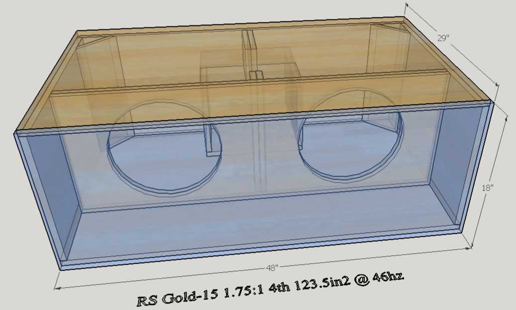

Yep... the 4th vented into the cabin is the way to go but realize a pair of 15's (AB?) are going to need a far bigger enclosure than you currently have and probably somewhere around 100in2 of port to do it right.
This a 4th for 2 Resilient Sounds Gold 15's, I am fairly certain its a little bigger than something ported would be. What works for your particular subs may be different but I hope this gives you an idea of the size difference.

Plus the trim panels separate the subs from the cabin and to make it worse the ports are like 1/4-1/8 wavelength away from the cones with the configuration and delay. Even a normal ported setup would perform better if the trim panels were fighting a set of 15s /w/ the ports on the baffle. Cancellation comes to mind. A complaint of "with the trunk closed" means he's reaching. Been there... simple fix actually even without going 4th order. Install and acoustics over beauty panels.

Yeah you never want to fire your port and subs into different airspaces because distance is tuning. Basically the bass from the subs in the back is changing phase too much before it meets back with the port in the front because of the extra long distance, but also because the trunk itself is going to act like an enclosure and the small airspace pathway the subs have around the box to reach the cabin air is like a port itself. It's like a parallel 6th order basically but tuned badly or not tuned specifically. The big trunk is a ported chamber and the smaller cross sectional area where the trunk air has to pass into the cabin acts as a port itself, basically, so you're getting an untuned resonance (causing cancellation) there in between the sub cones in the trunk and the port air in the cabin.
Really you want the subs and the port to be as close to each other as possible to eliminate cancellation from my understanding. Just a general statement. You never ever ever want to put the port and subs firing into different air spaces, you always want them firing into the same airspace, like you want them all firing into the trunk or all firing into the cabin.

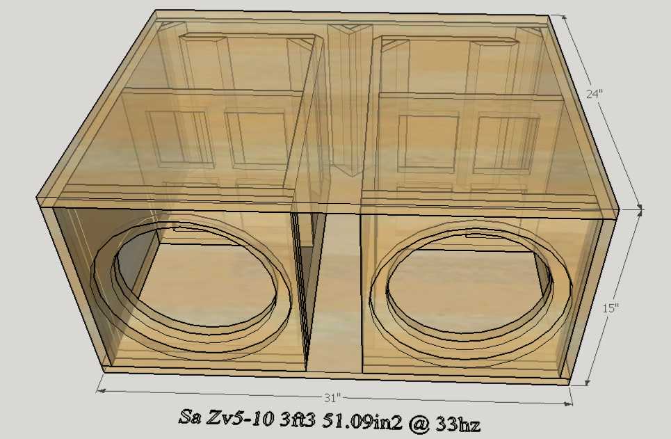

Its really the absolute worst way to do a ported in a trunk, cones in the trunk all trimmed in /w/ ports firing into the cabin. One local expert tried to get creative for looks and did something similar /w/ 2 Zv5-10's in a Camaro. After he threw some more bux and time at it hands got thrown up in the air. Mind you this was Zv5-10s on a Sundown 6K so tensions were apparent over the install once I weighed in.
Simple fix...
Some parcel shelf work where he originally tried to port it into the cabin really let it open up. But make NO mistake it was a gorilla back there. Before it was mildly interesting without lows. I was unimpressed. We fired the thing up after the change and his garage door piledrived the roof and rear window. He was so happy he didn't care
Baltic Birch and some compromise actually put a set of Zv5-10's in a newer model Camaro once upon a time. On 6K no less... it was epic
