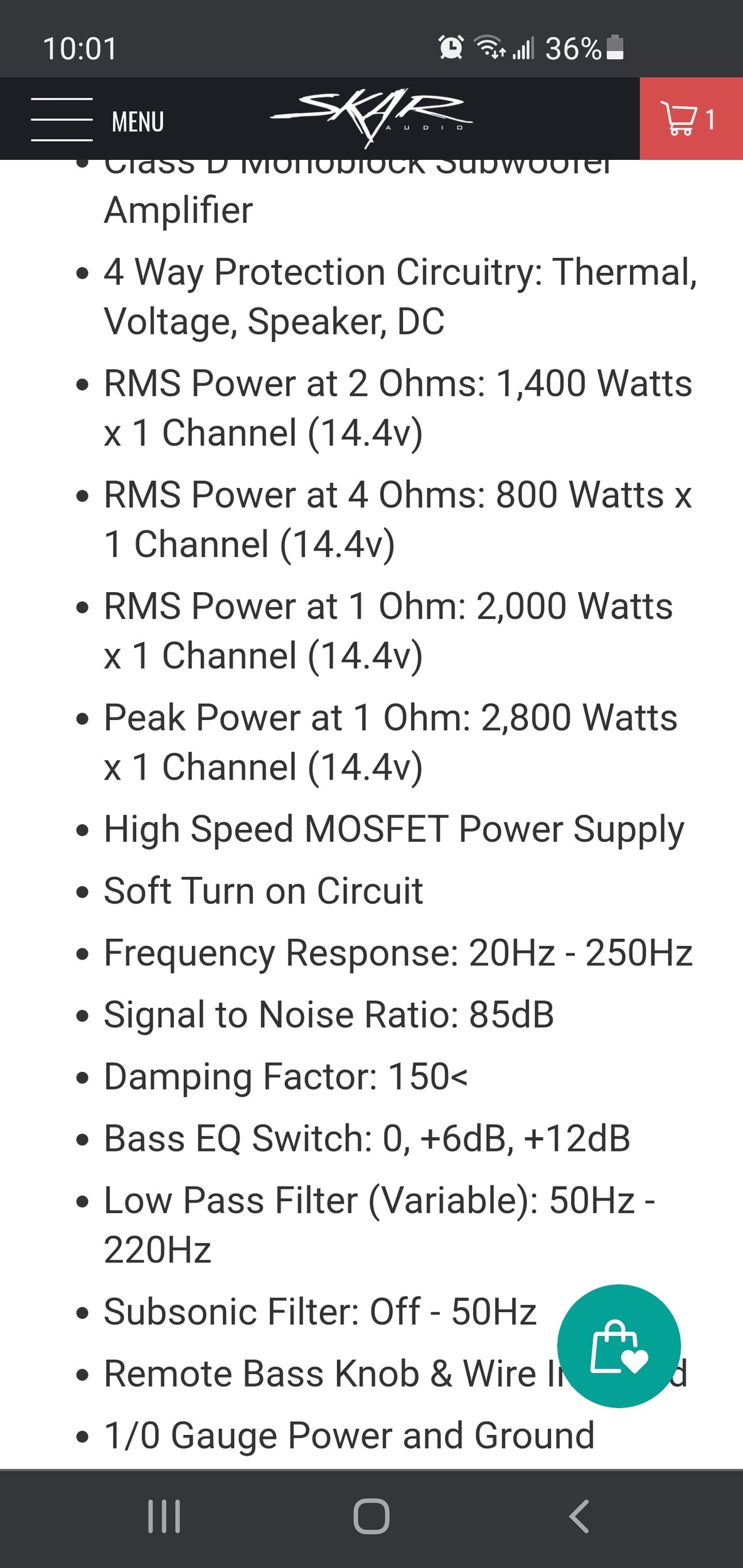

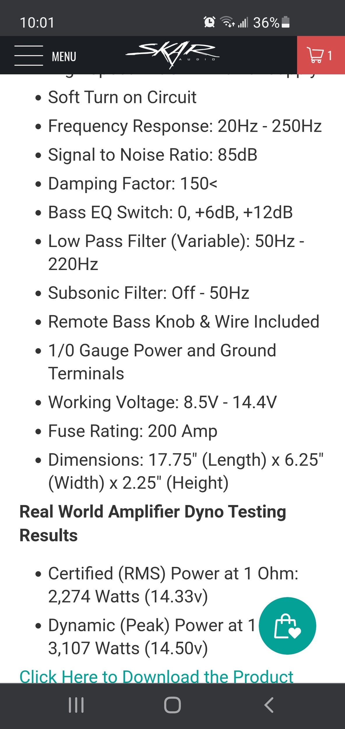

Your worried about not being able to run the amp at 2ohms
No amp is ever going to run hotter at 2 ohms than it does at 1 ohm so don't worry about that
If power output is your problem than look at it like this
Right now your running 2000 watts between 3 subs so that 's 650-675 each give or take
The amps output is something like this
1000 watts @ 4ohms
1500 watts @ 2 ohms
2000 watts @ 1 ohm
The don't list the numbers on the website so I'm averaging it out, the real numbers for 2 and 4 ohms are probably higher than that
So even if you do go with just the 10's the your still going to run like 750+ in to each one.

Thank you so much kickstand. No I'm not 100% on the tune of the box. I used subbox pro. As far as the Amp output I attached pics from skar website. As far as the subs they are ddx 2 ohm dvc 1500w max and 1000w rms. Both the 12 and the 10s.
