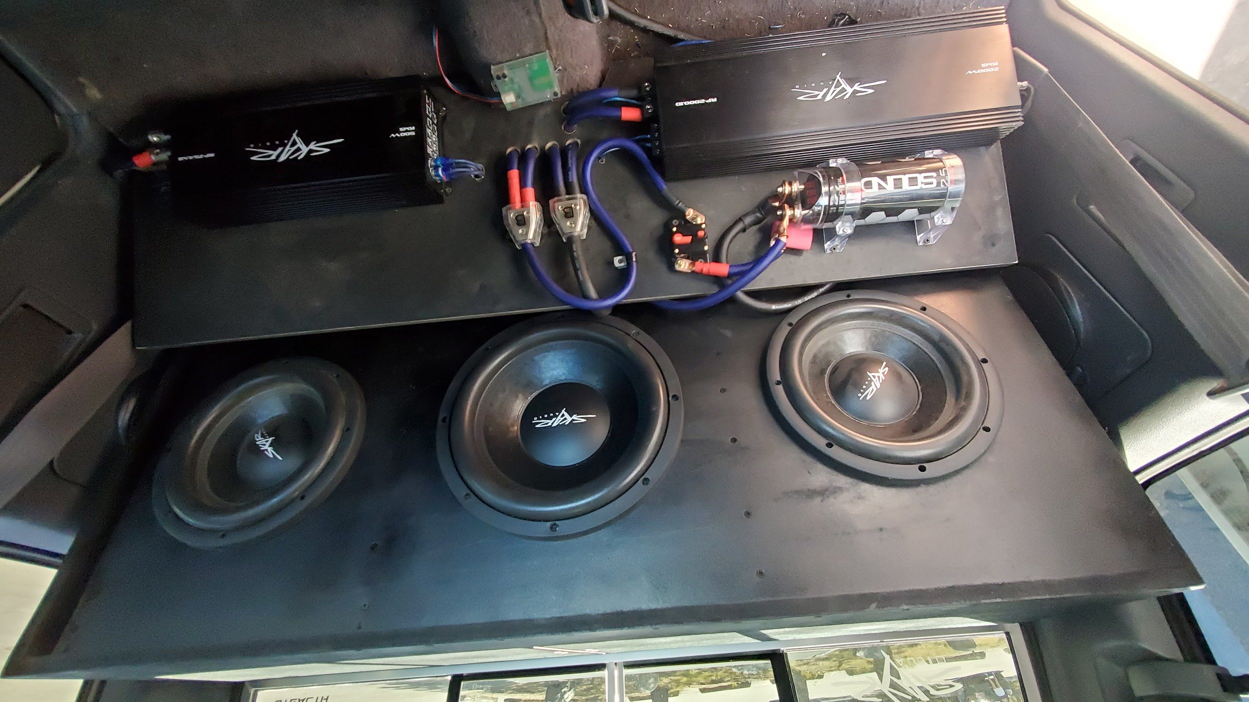

So I have everything skar audio. I have 2 ddx-2 dvc 1000w rms 10's and a ddx-2 dvc 1000w rms 12 in a t type box 5.5ft³ tuned to 32Hz i belive. A 2000w monoblock 1ohm stable skar rp2000.1. I have subs wired series parallel to bring my final impedance to 1.3 ohm. Set gain to 50v using a dmm. Also have 4 component 6.5 with crossovers running off a skar 75.4AB. My problem is the subs hit ok but not really hard and if they do it sounds like there is a popping sound. Please help
2 10s and 2 12s together..
2 10s and 1 12. All of the same brand and same max w 1500 and all same rms 1000w. All 3 are 2ohm. Sorry new to this page. Don't know if this will post twice.
You must have an Suv, Van or wagon because throwing all that into a trunk is a major fail. Like stated, mixing sizes is never a good idea.

Got any pics?

Dont mix different size subs......keep the 10's or the single 12 not both.....dumbass....and fuck skar im so sick of seeing newbies buy that junk, must be the first brand that shows up on an amazon search i dunno

Nice enclosure (sarc)... Id just go with the 10's. And what forum is spreading around the idea a RP2k overheats at 2ohm?
Just get a proper box built, taking into account the power you'll be making at 2 ohm, ditch the cheapo cap and I bet it sounds way better.
