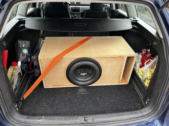

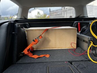

Hi guys, I need help am not getting the bass i want, even tho i have a decent amp and a sub

Its actually insane now its even moving the paper from the pressure
The sub itself modeled up overrated like I said earlier in the thread. The importance of a well designed enclosure for the foundation of your music can't be overstated. By my estimation I'd rate the driver around 750rms. That said even a lower wattage driver can do work in the right enclosure.

Am super happy now am glad you helped me:)
