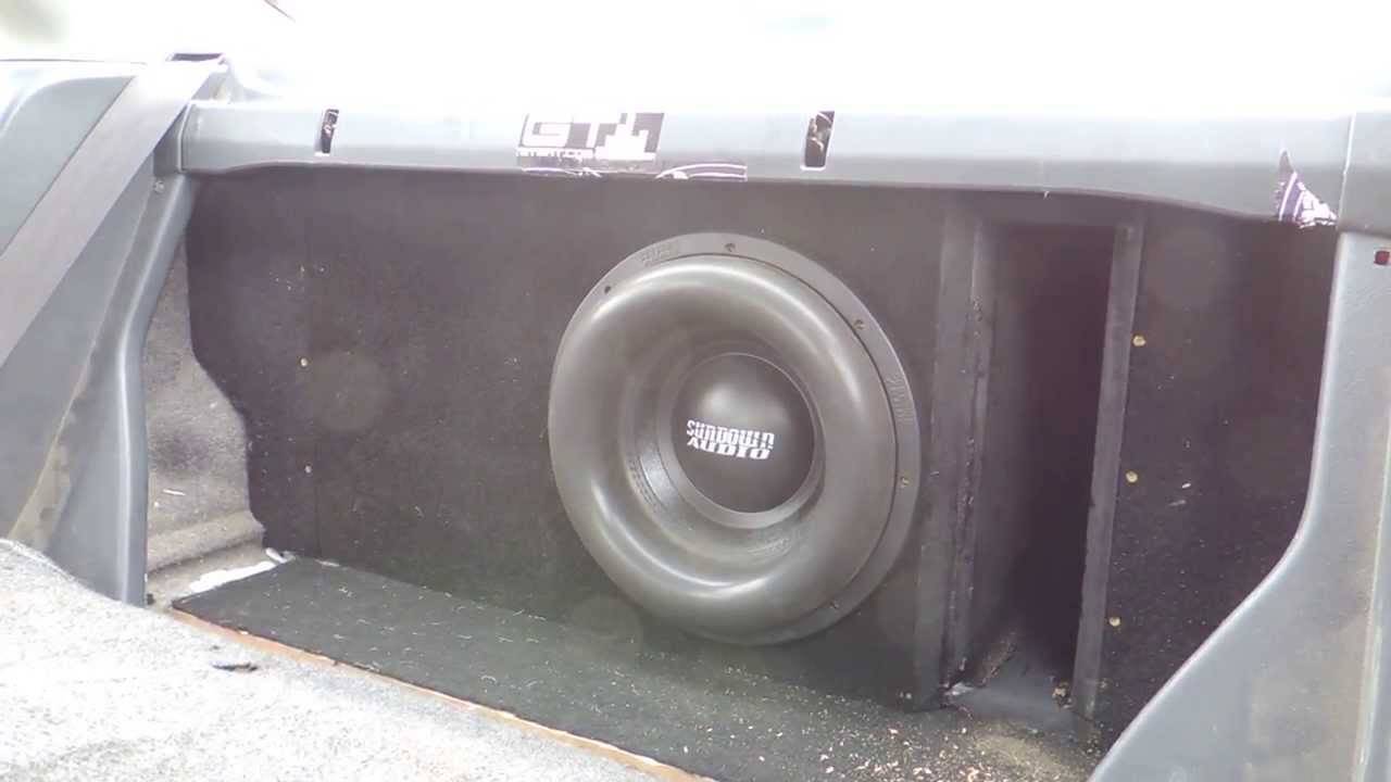

The box is 3.3ft^3. The areo ports are 4"x19". The frequency must be anywhere from 28-32hz. I don't remember.
27 1/2 width, 18 3/4 depth, 14 height, minus 3/4 mdf.
something is seriously wrong with your box... like completely wrong... Port is way too small, box is way too big tuned way too low. If its two 4 inch aeros, it looks a lot better and its workable, however, there's still an issue. It looks like its a side port as well, which is far from optimal.
There is TWO aeroports. Its funny cuz the guy who custom made it was a user on this website. I put my trust in people's recommendation to buy from him. I don't even know anymore. Bout to sell everything, been losing my mind all day with this lol.
Two 4 inch aeros are fine then, you are at 32hz, for now, get yourself a soundqubed hds 312 and cut the port lengths down to 15 inches long and you should be slamming and get some money back doing so.
