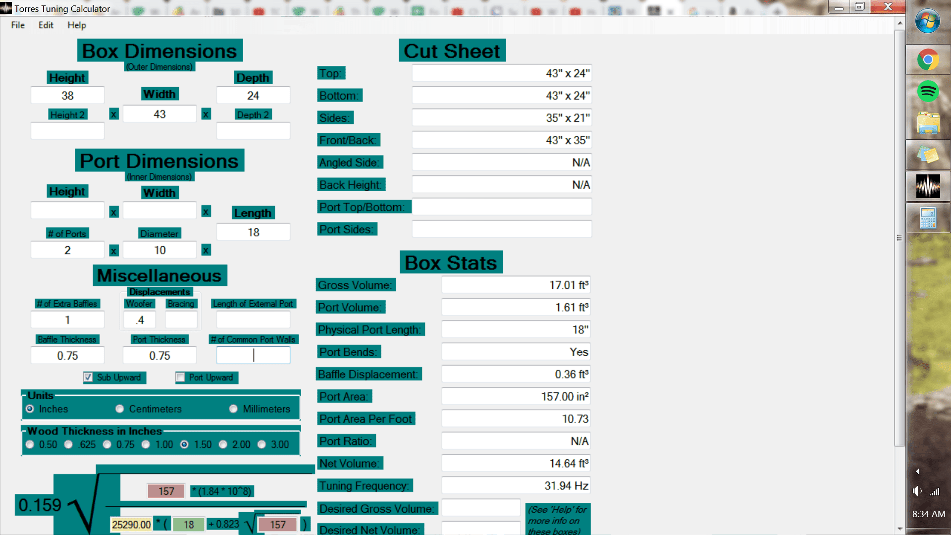

you have space for two 18s bud
This would be a double layered box with a quad baffle with plenty of airspace for two 18s and more bracing. Definitely use high layered plywood over MDF, sucker will be heavy. It'll be subs up, port facing the rear and you have clearance for the port to breathe and load to the rear trunk as well with the depth. make sure the box isnt going to be obstructing your view tho.
