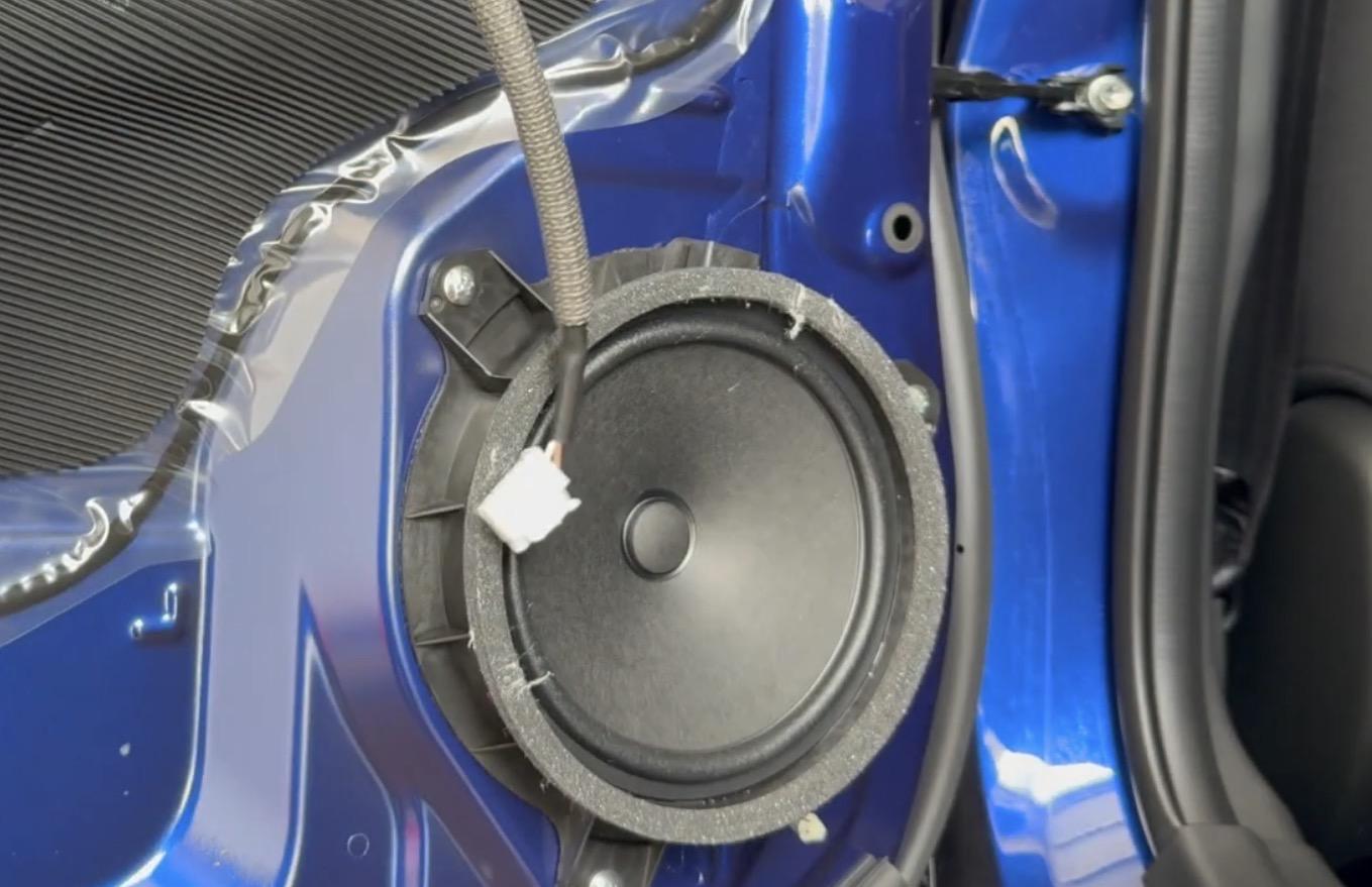

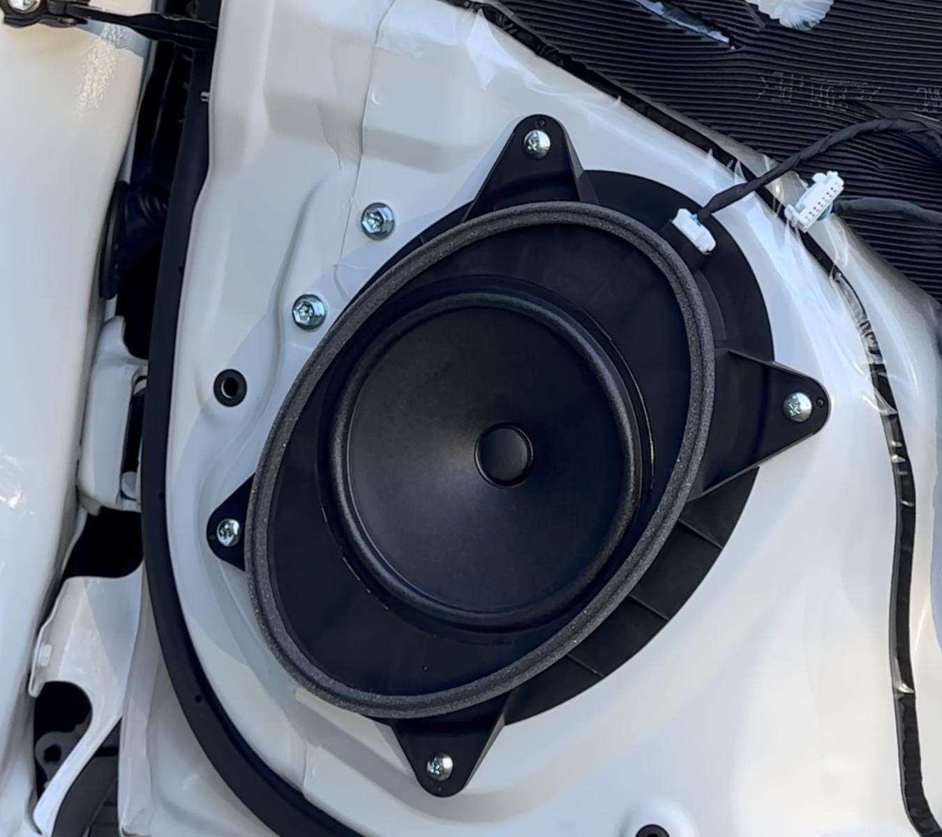

To put things in perspective… here’s a picture of the junk they put in the front door: A paper 6” round speaker in a space which can house a 6x9. And some 3 1/2” in the dash. The back doors hold cheap, 1-way paper 6” speakers.
For that, I was thinking of the component Alpine’s, which have a 6x9 “woofer” paired with a 3” mid/tweeter which would go in the dash. The front speakers alone will be the biggest improvement over these really bad built-in speakers. Then I figured, for another $100, might as well replace the back door speakers. Then I figured, might as well add an amp. So now you guys have convinced me, it makes sense to install a 5-channel amp so we can install a sub later on.
FRONT DOORS:
REAR DOORS:

Looks like a great choice, as long as I can fit it under the passenger seat. I wrote to Stinger asking if this amp will work correctly with the speaker outputs of the Subaru, or if an LOC is needed.
If it doesnt fit, you can easily / very inexpensively & safely raise the seat some using spacers until it does...
