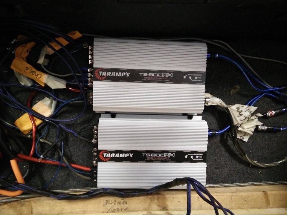

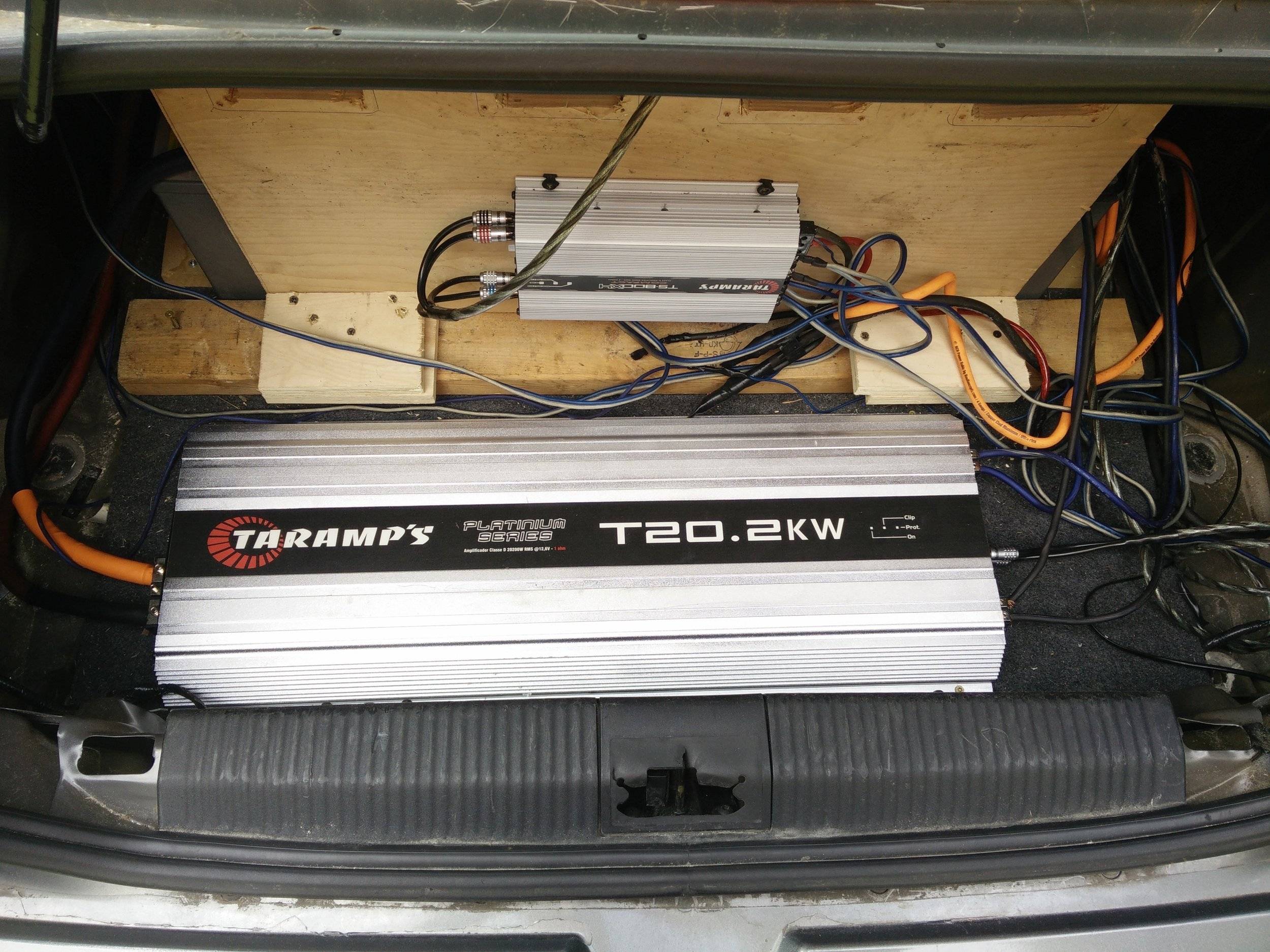

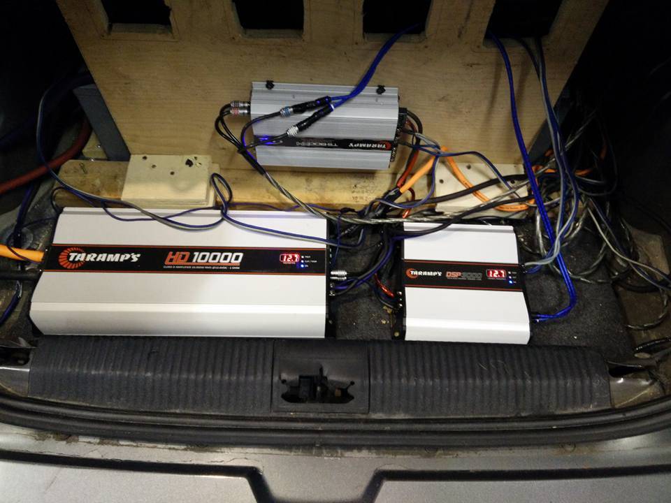

Just post an update about that 4chan taramps amp once you install it because that's my next purchase.
I had two TS800x4s and they were great little amps. The DS line is even better built. Loads of power and super tiny.
