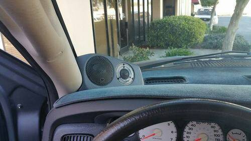

Like this
Ill say this about fiberglass. Its easy to learn, ******* hard to master. Ive spent too much on fiberglass materials trying to make them look Nice and i have never succeeded. Yea ive built MANY enclosures but idk how to like finish them in order for them to look smooth and presentable. They are thick and work great, just look terrible. I have had plenty of help on forums but i just cant seem to pull it off. Maybe i dont have the tools or something. Im a visual and hands on learner so someone telling me doesnt help much. maybe i need to go to a boat repair shop and just ask them if they want free help for a few weeks :p
Also, For those wondering about speakers so deep. They are way behind the kicks and i have NO issues with frequency extension,stage height, or depth) I think my left midrange goes to like 6.6khz and drops rapidly after that(also where im crossed over at). I have noticed and heard from others that you're soundstage will never be deeper or wider than your car and this is id say 80% true. Its more like the Front of the stage will never be farther than your deepest driver(assuming its playing a majority of your frequencies). What i mean by front of the stage is imagine your listening to a live recording and any good live recording will have a depth to the stage. youll be able to tell the drummer is behind and to the right of the singer. Youll be able to tell if there is a crowd in the front of you(think of the crowd in the beginning of Ac/Dc Thunderstruck). Basically the most Forward(closest to you) sound will only be as deep as your closest driver. My drivers are as far back as i can get them, they are literally glassed to the firewall(and deadened to the nines).
Basically im saying. Keep your tweets up high and use Kicks as much as possible. I despise A pillar builds short of those with a very deep dash. The hard window reflection is just a Cunt to tune(read: nigh impossible). Thats why i have waveguides on my tweets. i have quite seriously a near flat response from them when tuning. Any A-pillar ive heard were super in your face.
