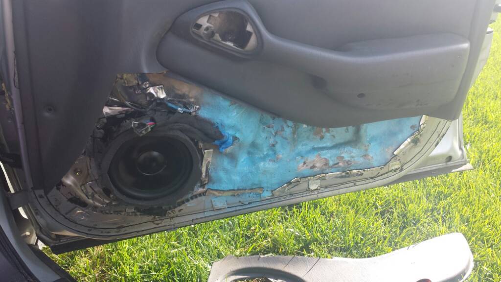

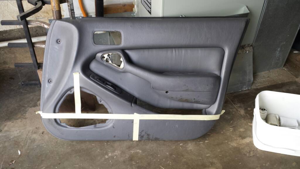

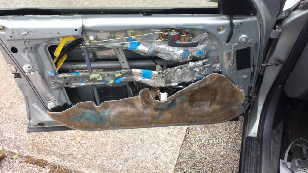

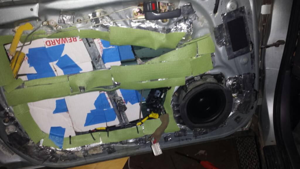

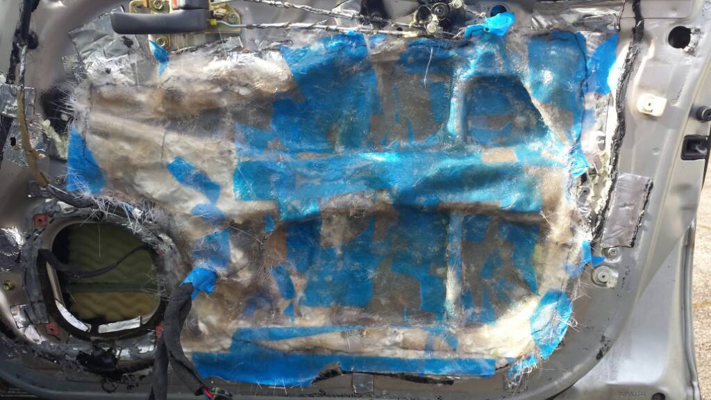

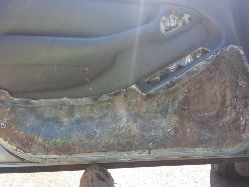

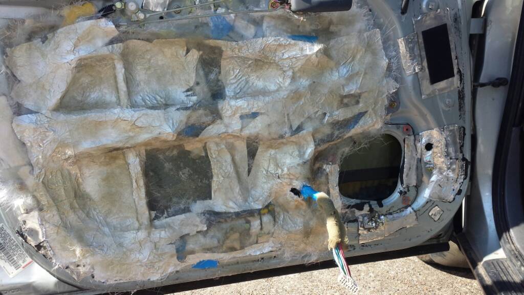

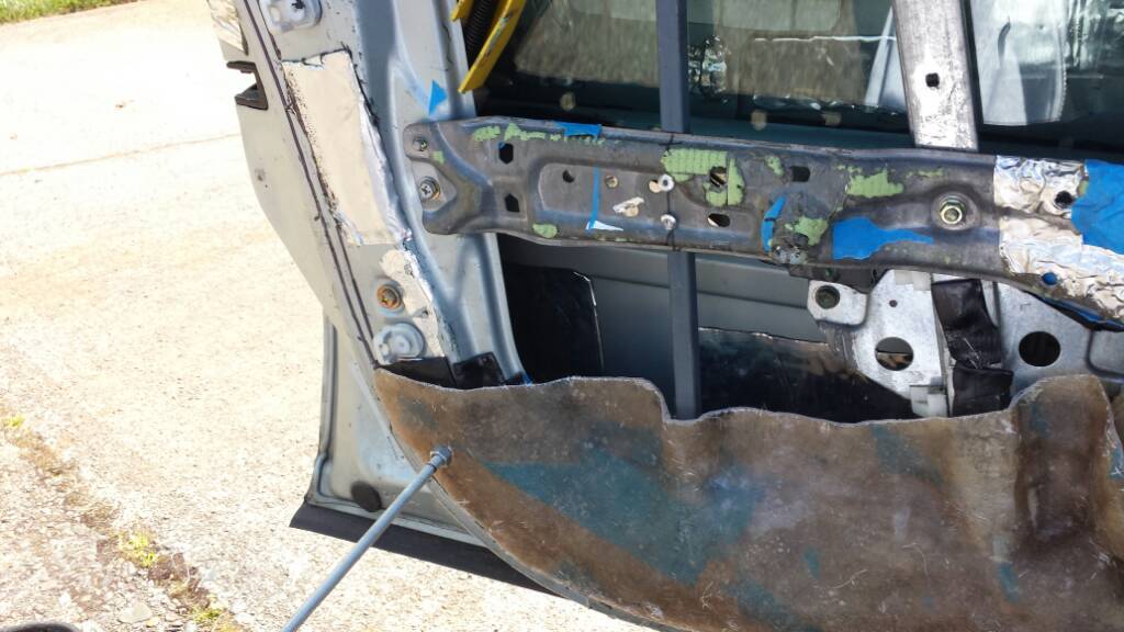

When your whole door is a friggin hole. I cut up some 1/2in steel and riveted it in to reinforce it then glassed it. I cleaned it up afterwards but im too lazy to tske a pic
Sent from my SGH-M919 using Tapatalk

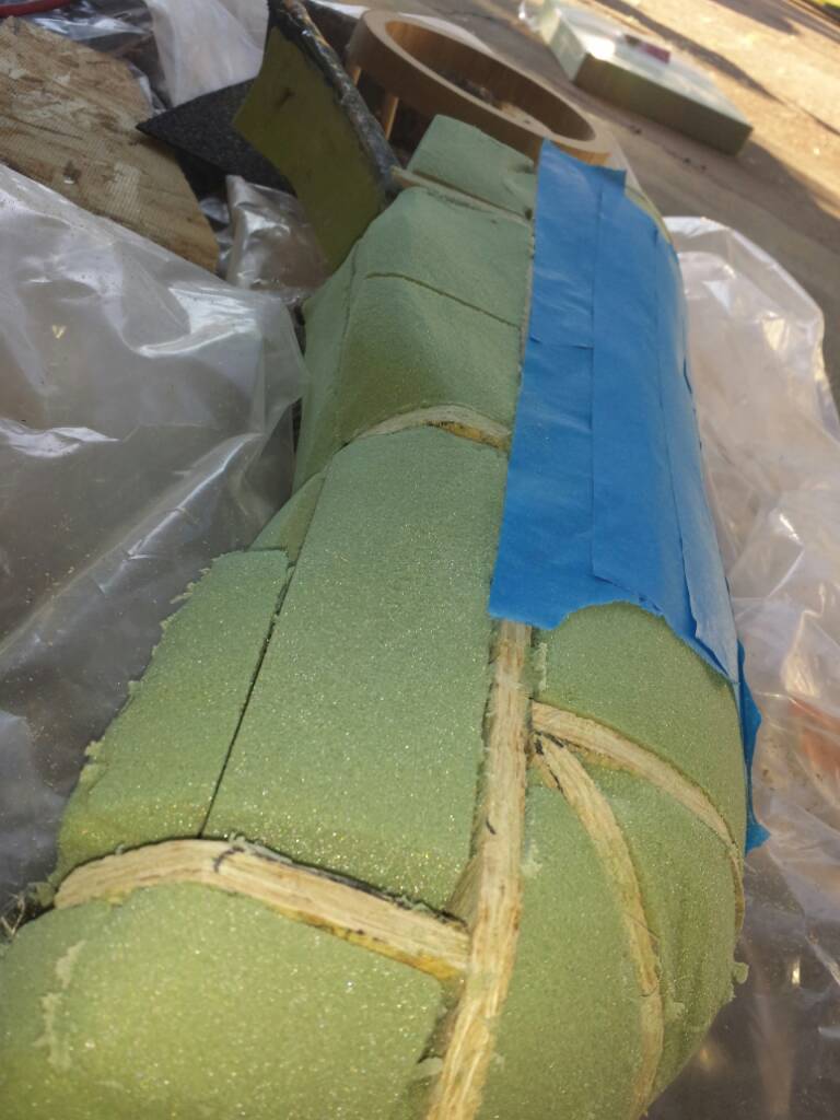

Smooth fiberglass enclosures:
spandex/thin stretch fabric for basic shape
resin/mat laid on smooth as possible
scuff with 40 grit and dig out any bubbles/air pockets
fill with chop mat/bondo glass and scuff with 40 grit
lightweight body filler, sand with 80 grit, repeat if necessary
milkshake - sand with 80 grit Research if you're not familiar with this technique
That gets you ready for vinyl or any fabric, painting would need a few coats of primer
x2 on fleece being crap, it wrinkles easy and adds ZERO strength, no matter how much resin you soak it with. The mat/cloth reaction with resin is what gives any FG project strength...

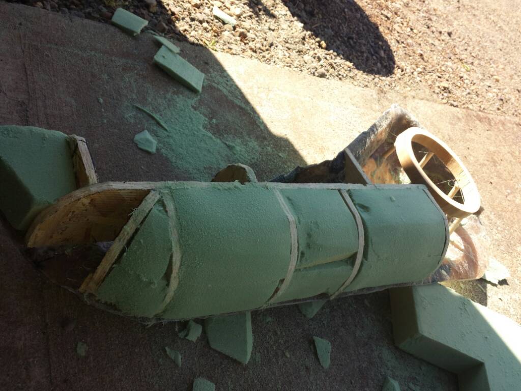

Running into a very big issue with wire placement. Friggin wires are in the middle of the enclosure and there would need to be serious rewiring to give it length enough to be outta the way

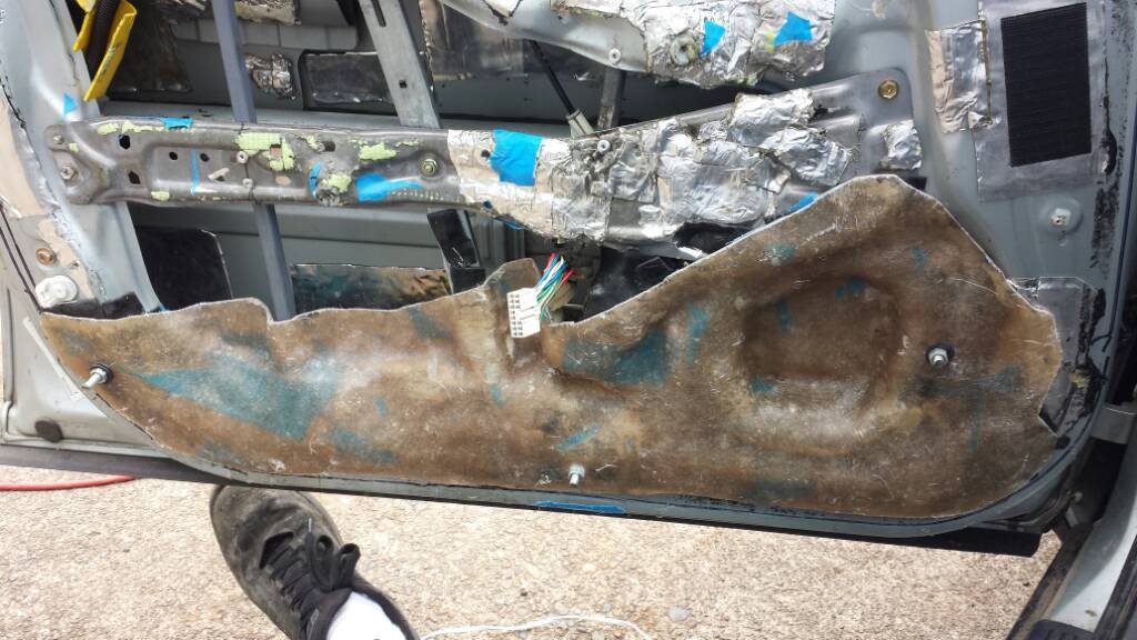

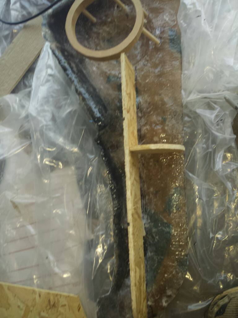

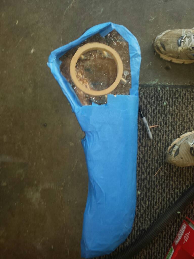

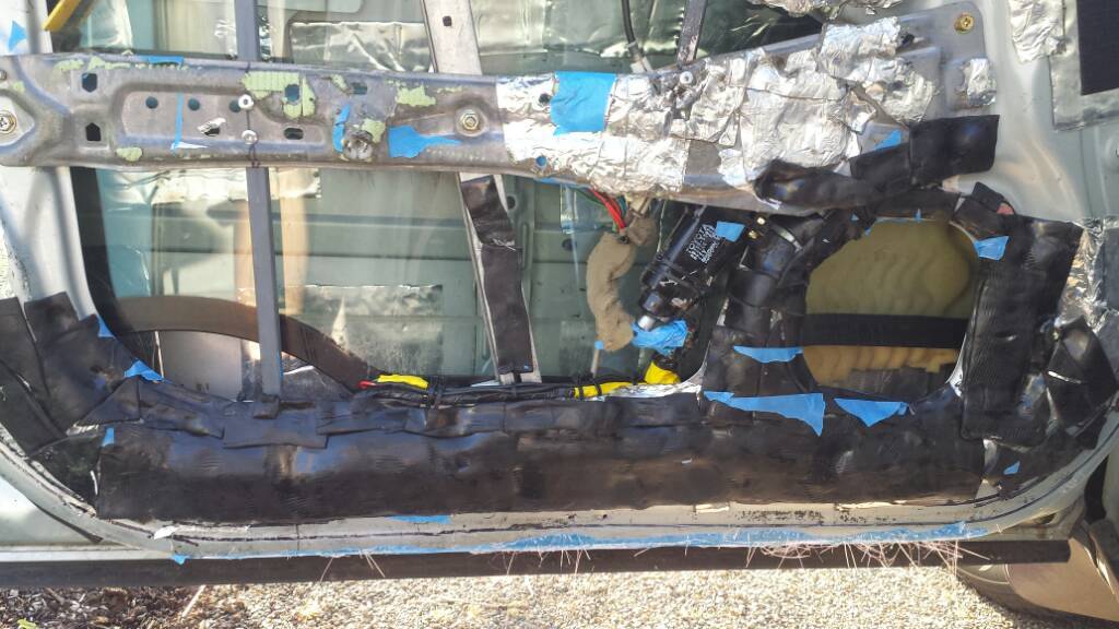

Butyl base as a decoupler. And beginnings. Im not 100% if i can actually do pods well. This is just the easy part but ima still try.
Plans have changed tho. This'll be pods for a 6.5 dedicated midrange then 8s in the kicks that are vented outside

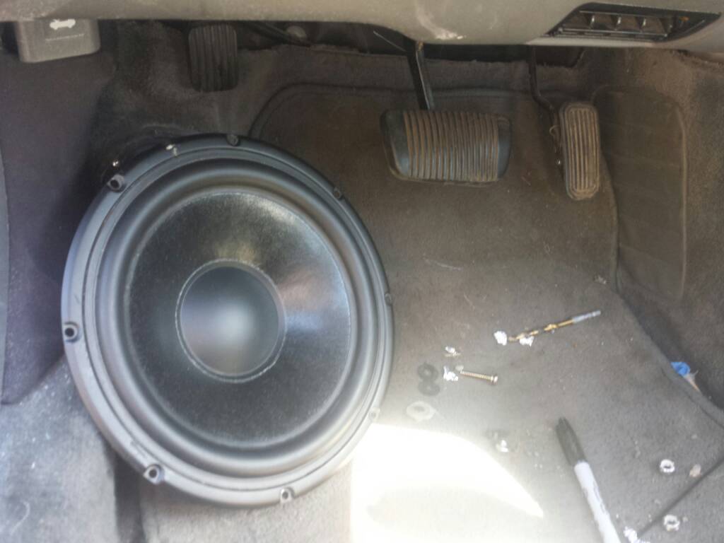

Is that a pedal just above the drivers side woofer?
yea its the E-Brake. Itll have to be cut and shortened to fit but thats no biggie.

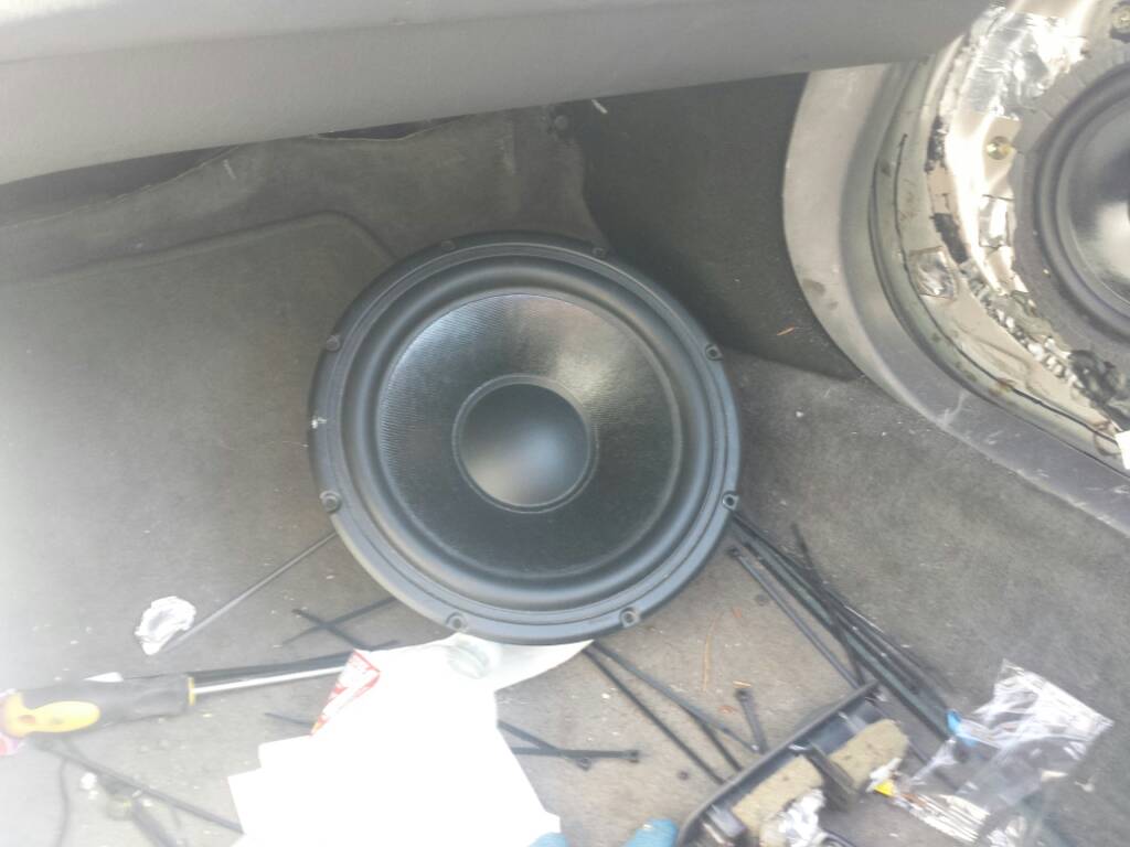

you going 4 way now?
Ive been 4 way for a long time, im just moving up in the driver size department.
Current is midbass- door,
midrange-kicks,
tweet- dash waveguide
moving to
Sls 10s in kicks
6.5 Satori dedicated midrange in sealed pods built into the door.
tweets in waveguide in dash.
