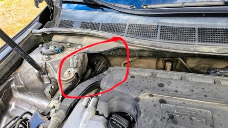

Yes it may prove worth it to pay them to make the hole. I'll be able to see more when I have time to pull the air intake stuff out of the way. Been about 30 years since I put an amp in a car, back then you had way more room to work and there were free grommets with nothing run through them on many vehicles.
Many of those cars have an manual transmission option. Try looking on the driver's side where the clutch would be. There should be a wide-open area to punch a hole. I would recommend taking it to a stereo shop and pay them $20 to punch the hole and install a grommet.

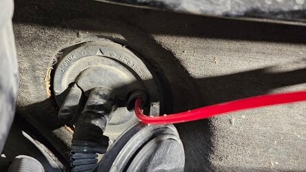

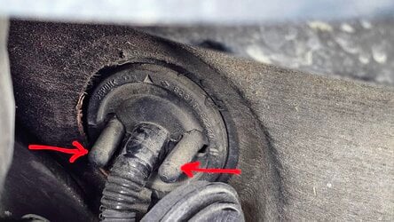

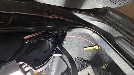

I have seen on YouTube someone route an amp wire through a rubber grommet that looks quite similar to this one on the passenger side of my car. They cut the end off of one of those little nipples and fed the wire through the opening.
