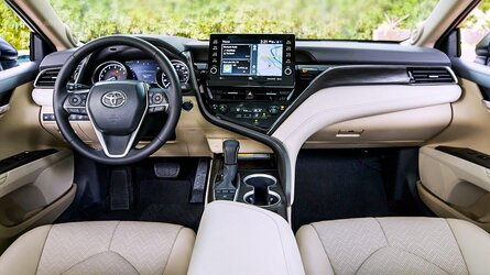

Is this your interior/radio?
Yes that is a picture of my radio type.
