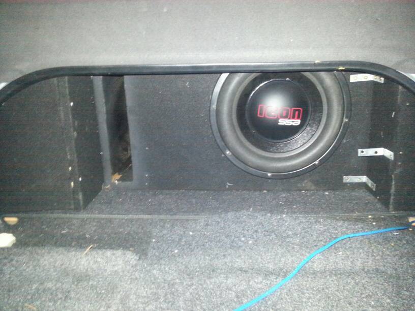

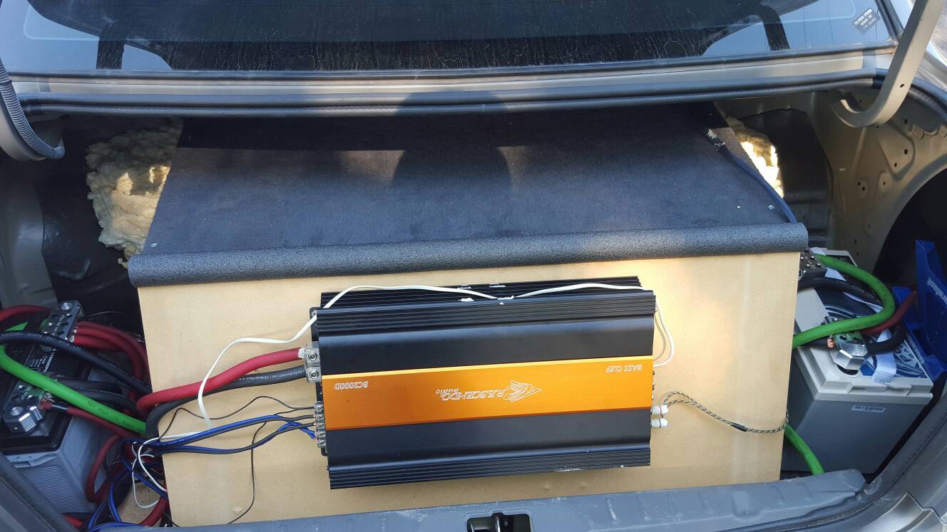

Box is in place, new amp isn't in, but here's the placement, mid and High amp is on backside of board

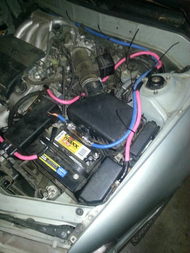

That's the plan! Put in side and rear bracing today, need to decide of I'm going to make the second run from the alternator under the car or inside. Don't know if I feel like drilling more holes in my firewall :|

Under the car is easier all around wiring but id personally never do it. Too much risk for me.

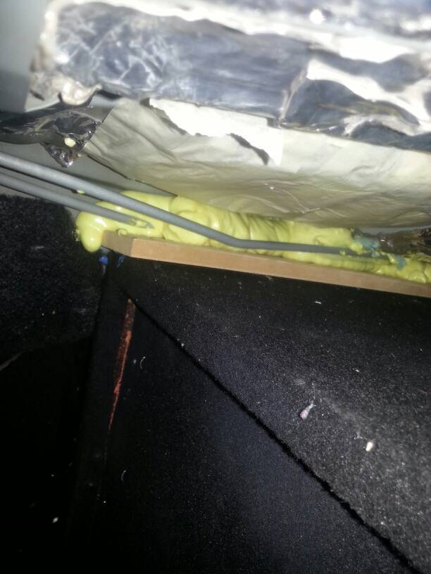

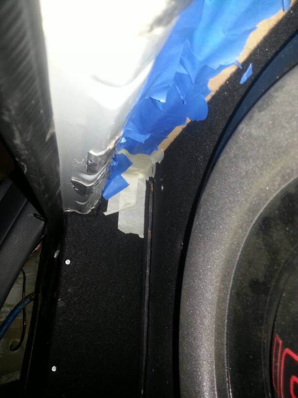

Dat seal though.. Yeah I feel the same, it would be extremely easy but I've bottomed out the car plenty of times as it is (It sits extremely low in the rear even with helper springs) So that makes me even more apprehensive. There's about a 4" gap on either side of the box, which makes me think I may be able to fill the entire gap with "big gap" expanding foam.. Would make it much easier than trying to fit pieces of wood as the side of the car is curved. Or.. I could tough it out, and try to cut some pieces that'll fill part of the gap, then fill the rest..

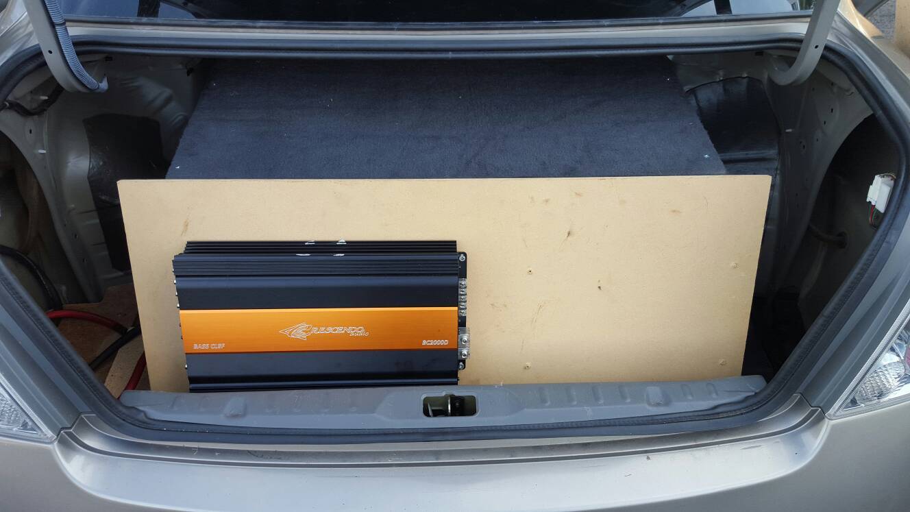

I cut out cardboard to fit everything first. Then transferred to wood. Just take your time. The top part has as much wood as possible but it has expanding foam on top.
From the back^^
From the front. I taped it off and sprayed so its unseeable from the front and its still really removable

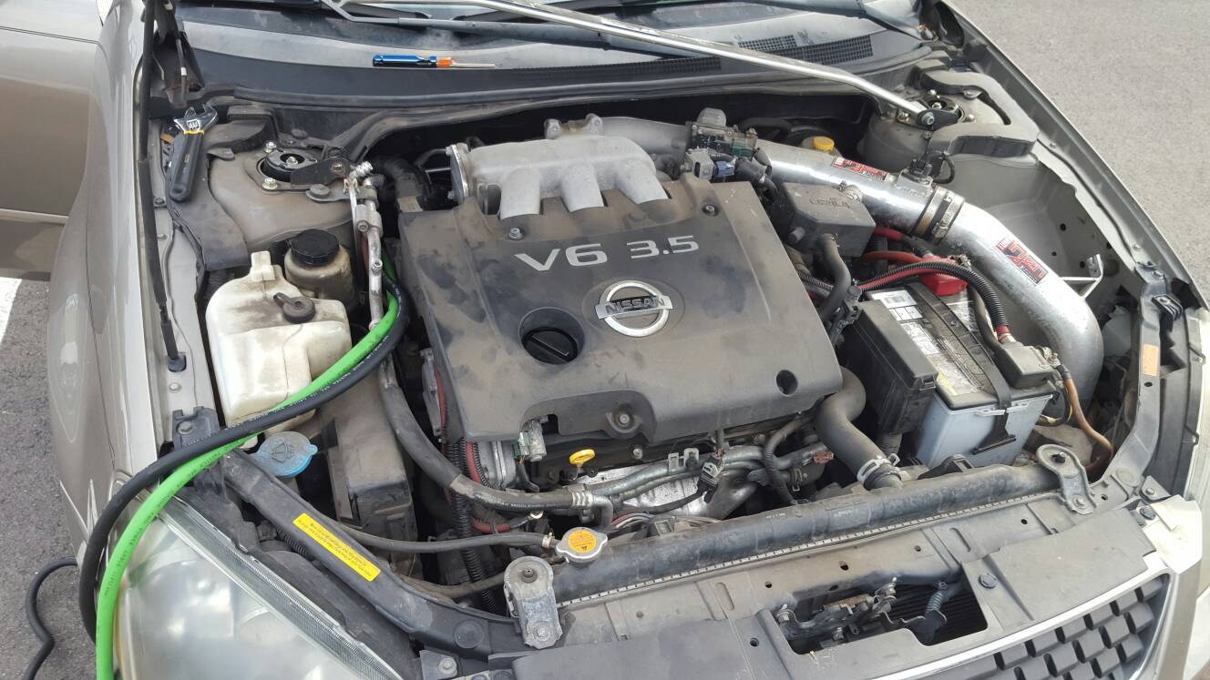

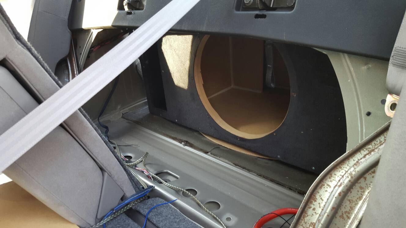

Started tearing into the passenger side kick panel. Found the ECU wire harness grommet so if I find the motivation I might have the last two runs done today... Probably not lol. I have some scrap 1/2 inch MDF left over that I'm going to cut out to fill the majority of the gaps. It'll also be a smooth surface to paint so that's an extra bonus.. Doing all of this in a parking lot gets me plenty of weird *** looks, spent an hour or two last night sanding and cutting wood on the curb...
Second run, through the firewall.

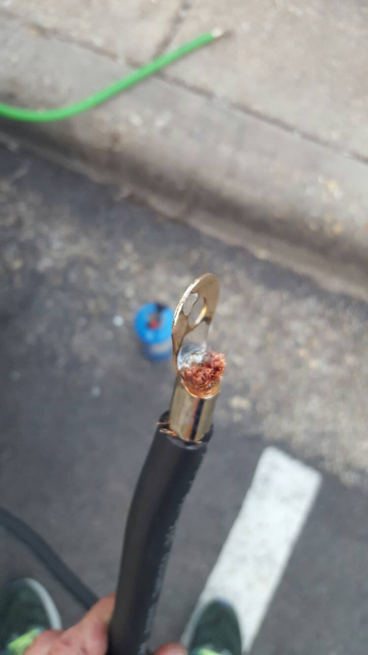

For soldering. I take a sealed copper lug. Cut a short bit of solder. Put it in the lug. Heat up the lug. It melts the solder and creates a puddle inside it. Then you dip the wire into the lug and leave it for a minute. Itll cool, expand and lock all around the wire and lug. Creates a clean awesome solder

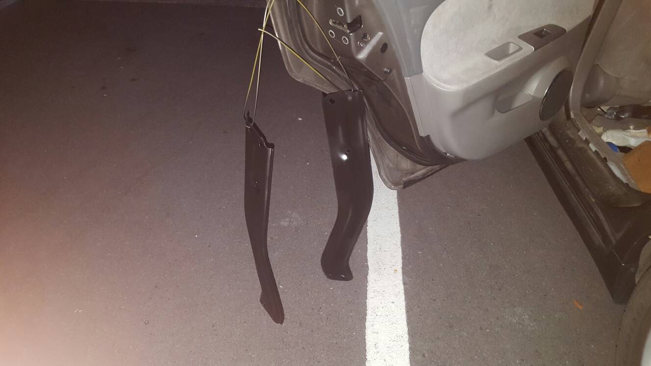

Removed some braces from behind my seat that were covered in rust, sand and paint in the parking lot.. and here's my drying rack

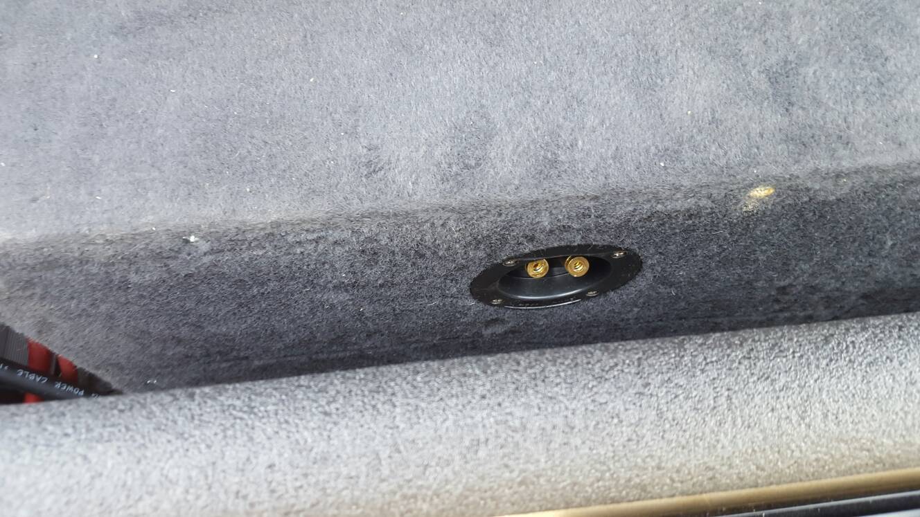

Added some pipe insulation to the top and bottom of amp board to stop vibrations (mid/High amp on backside). Expanding foam almost done. Going to use the terminal cup to put a dowel in to brace from the front baffle to the back.
