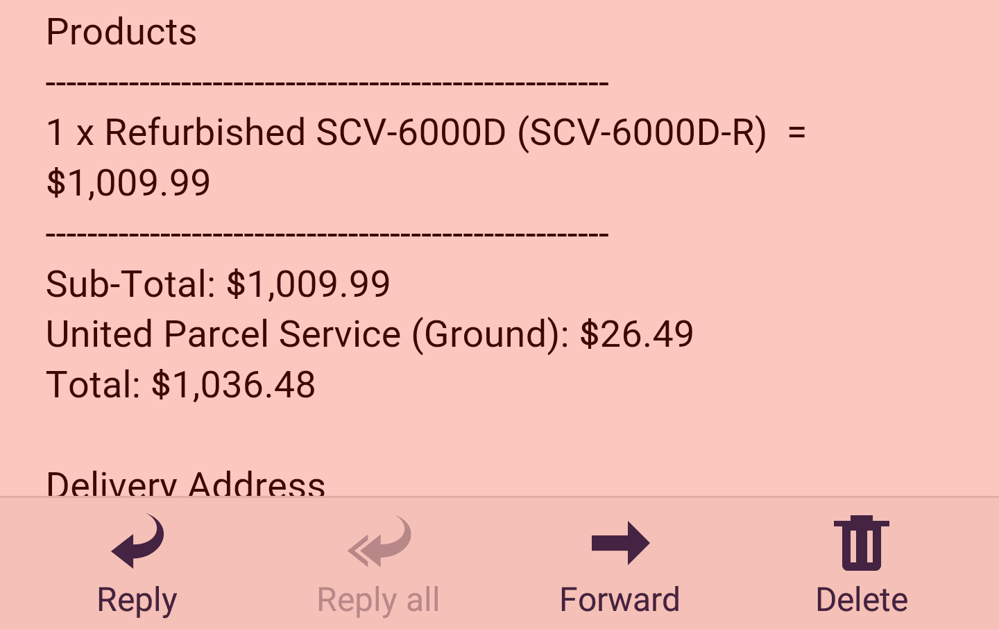

NEW PLAN. Nightshade v3 15 @ 1ohm on SCV-6000D
