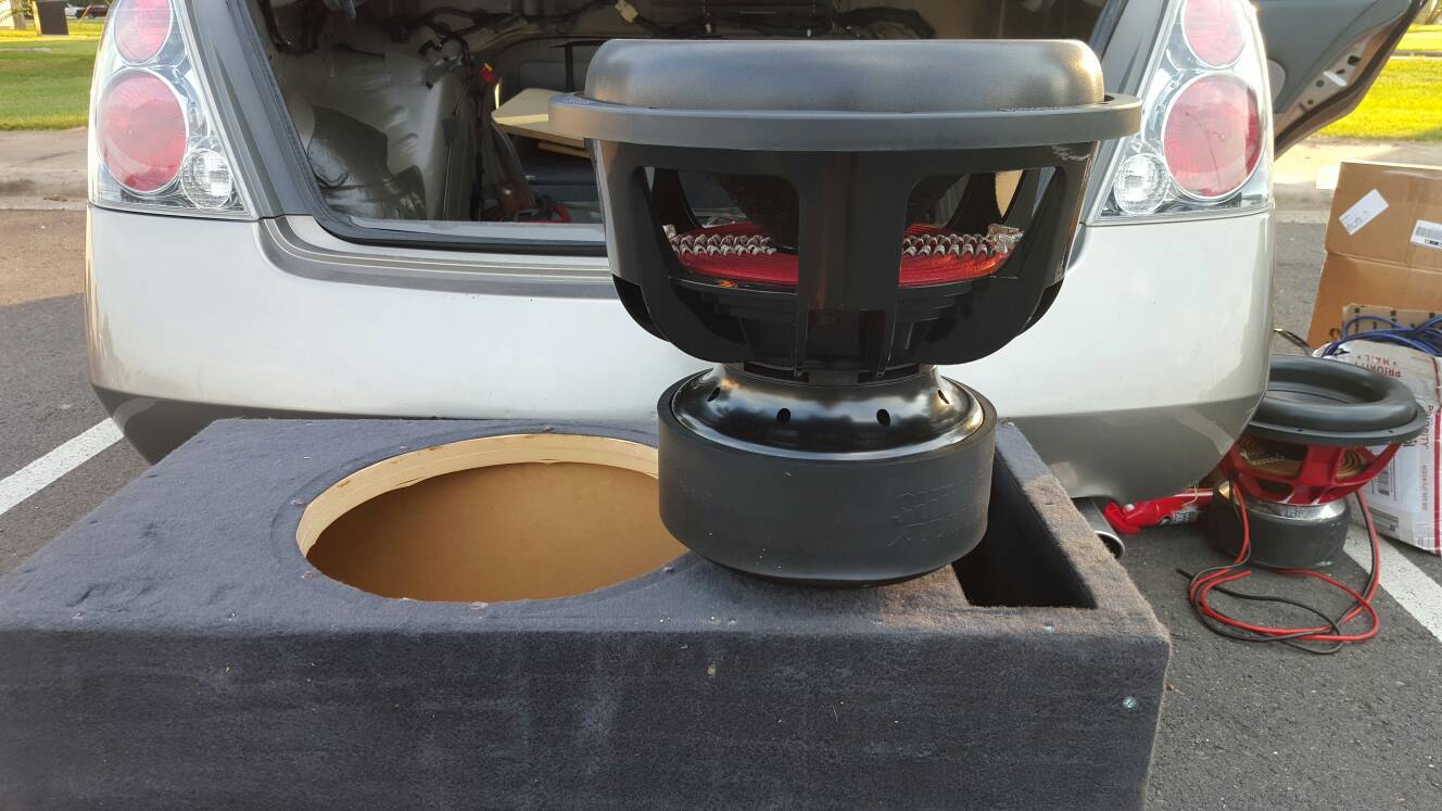

My box right now is 40x26.25x17It's a bit small and pushed back a bit away from the back seats, but it's not too bad.
I'd like to try a few different boxes in there, but it's a lot of work having to tear the whole thing apart each time I wanna try something new.
I was thinking of something similar, with the two subs inverted on either side of the box with a 12" aero port in the center at 30hz probably one from psycho port. Not sure how long it'd be. But having them inverted would cut down box displacement by about .5/1 cuft which isn't much but every bit helps.. I'd much rather have 2 15s simply due to cone area. But I'll need to run that 6k at .5 ohm which will be tough on... everything lol

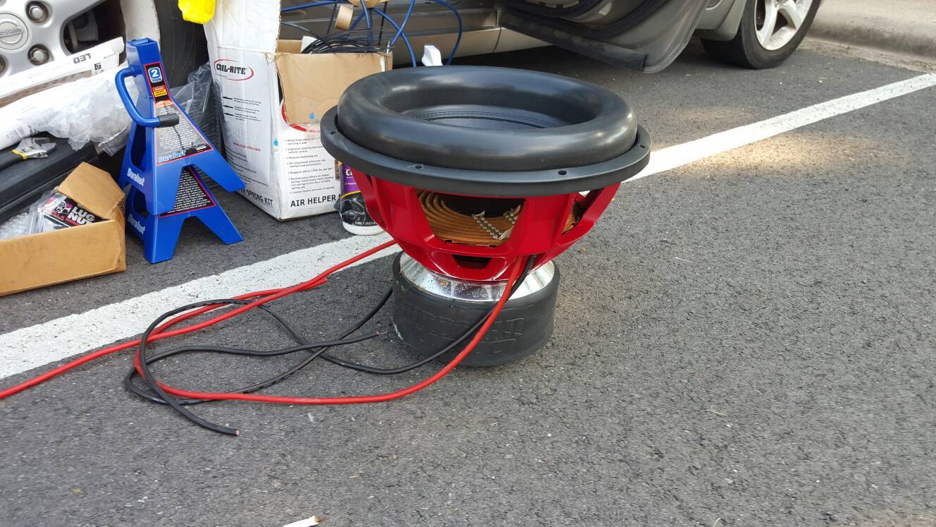

She's out! Taking offers //content.invisioncic.com/y282845/emoticons/wink.gif.608e3ea05f1a9f98611af0861652f8fb.gif
Sent from my SAMSUNG-SM-G920A using Tapatalk
---------- Post added at 09:21 PM ---------- Previous post was at 09:20 PM ----------

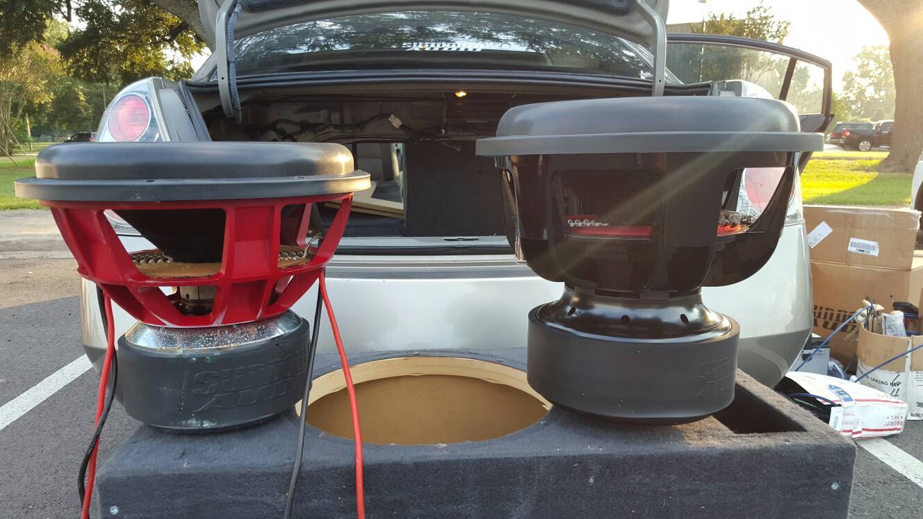

Sub info.. dual 1 Zv4 15" in non sundown basket
I'm using the BC2000D @ 1ohm in the mean time to break in the Nightshade, coming from the Z @ .5ohm. The Nightshade is no **** just as loud if not louder on roughly 2/3rds the power. Really impressed with its efficiency, and now I can run full tilt constantly due to the significantly lower power draw.
