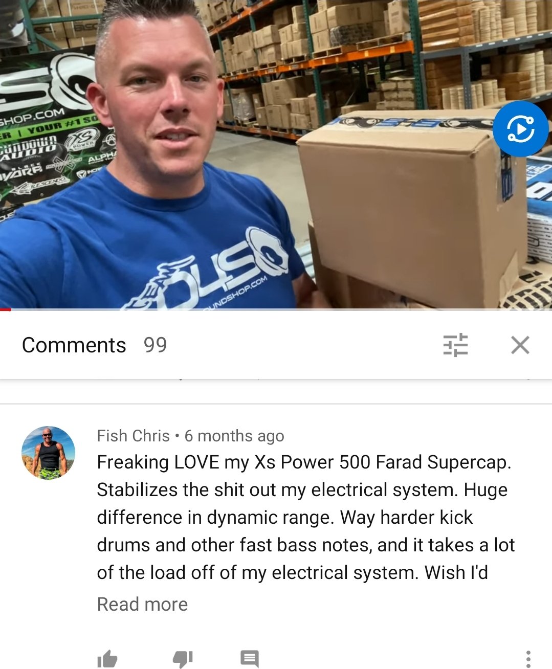

No doubt lithiums are awesome batteries, with very high power to weight ratios. And I totally agree that a high powered alternator (or 2, or 4 ;) with a nice strong lithium bank is a great way to go. Still, their is no doubt in my mind that keeping all of that < but adding some nice super capacitors will add dynamic range to the music, by giving more instantaneous power bursts. Lithium is definitely "faster" at making juice, than lead acid / AGM's, but its not even close to a super capacitor.
Really, I can only think of one (well kind of two) advantages to creating a ton of power, and running a bunch of supercaps, with no actual batteries... 1) Is that you will always see voltage drop when a big system is being beat really hard.... Albeit much less with lithium, than with lead acid. Whereas, "if" you can make enough power (meaning, making more continuously, than your system will use at full tilt... although a bunch of caps will add a little buffer) to begin with, you would see "zero voltage drop".
2) You would have something that few (no ?) others do :)
Or at your power level you could have just invested in good amps with regulated power supply and this would be a non-issue.
You're really grasping at straws here. Now can you quantify some audible difference with and without supercaps on say a 2500W system with HO alternator and just an upgraded AGM under the hood or that + supercaps? You may use RTA, termlab, or oscilloscope readings.

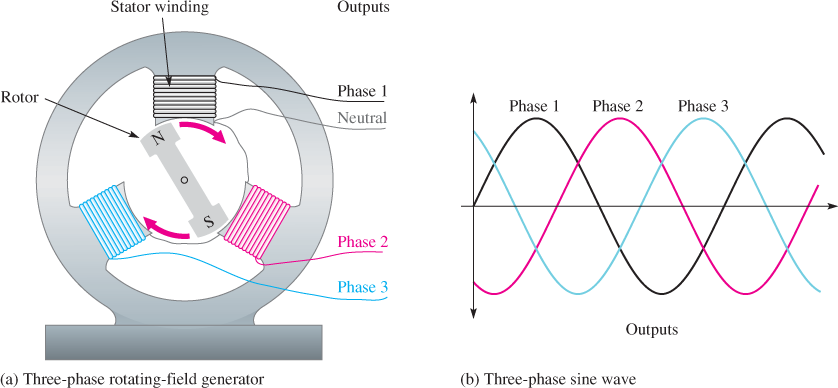

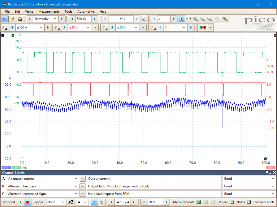

Your alt power comes out in some form of pulsed DC current, and it varies I'm sure. But the green line is the pulse. So if you're charging a 12v system at 14.4v, it's pulsing 14.4v, it's not a constant 14.4v, it's 14.4v at a certain frequency. That's how you get alternator whine, and that's why it gets worse when you rev the engine up, because you're spinning the alt faster, creating a higher frequency alt pulsation.
29072
How many phases an alt charges in changes that pulsation, because the waves are all evenly divided, just like a 3 phase electric motor does. That can change the DC pulse, how many phases the alt charges in, I assume. It's just how the wires are wrapped internally and how the magnets are geometrically placed and the number of the magnets and where the poles are. I'm not sure who does what and how with their alts lol, there's different ways to do it.
IMO, those really good caps are going to have the best chance at filtering that pulse out before it enters the amp. If not, the amps are using a pulsating/slightly varying current voltage from the power wires, to whatever extent. It should help balance the amp out, because that voltage pulse fluctuation causes also a current fluctuation within the amp, to whatever extent. It's probably minimal, but it just depends on how hardcore you wanna be. I would do both power and ground from the amps directly to the caps. If you ground to the frame, maybe ground the batteries to the frame, and use the caps to feed the amps completely.
