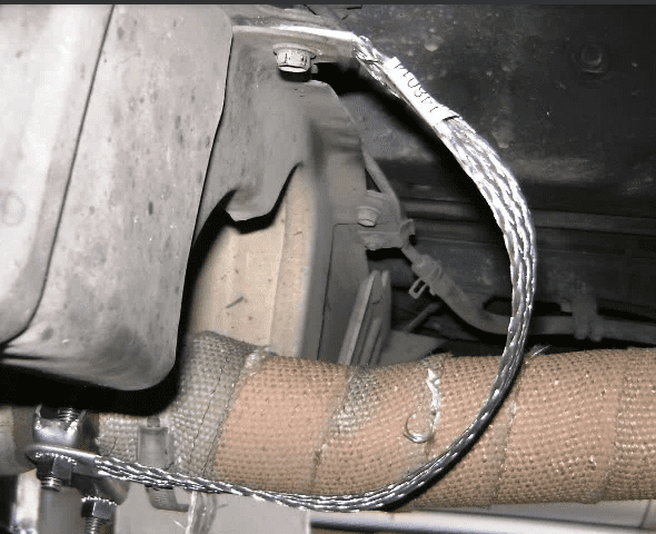

Should be fine. I also recommend grounding the exhaust near the cat and the muffler or upgrade the factory straps.
Have done the mentioned upgrades.. crazy voltage drop. even swapped out subs and amp for something smaller just to see what would happen.. still voltage drops below 12.. put in 3 cvrs and stinger 1500 as test and it's about the same drops so low amp goes into protect 30 40 secs into song.. what could be wrong

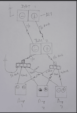

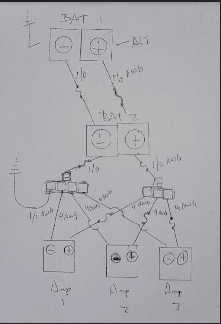

Ground the negative to the second battery. Car chassis. Metal iron part anywhere close by. Then you connect the positive side battery to the input of the amplifier. Positive to positive. Your car is a chassis or common grounded car connection. And it is 12 volts above the ground. "Ground" means any metal part of the car chassis. All battery connections operate like that description. Thank you!
You don't wire it in parallel. One battery will drain off the other. Cancel each other out. So you line it up in series. Sort of. By grounding one negative, that second battery now becomes 12 volts above the ground. Chassis.
