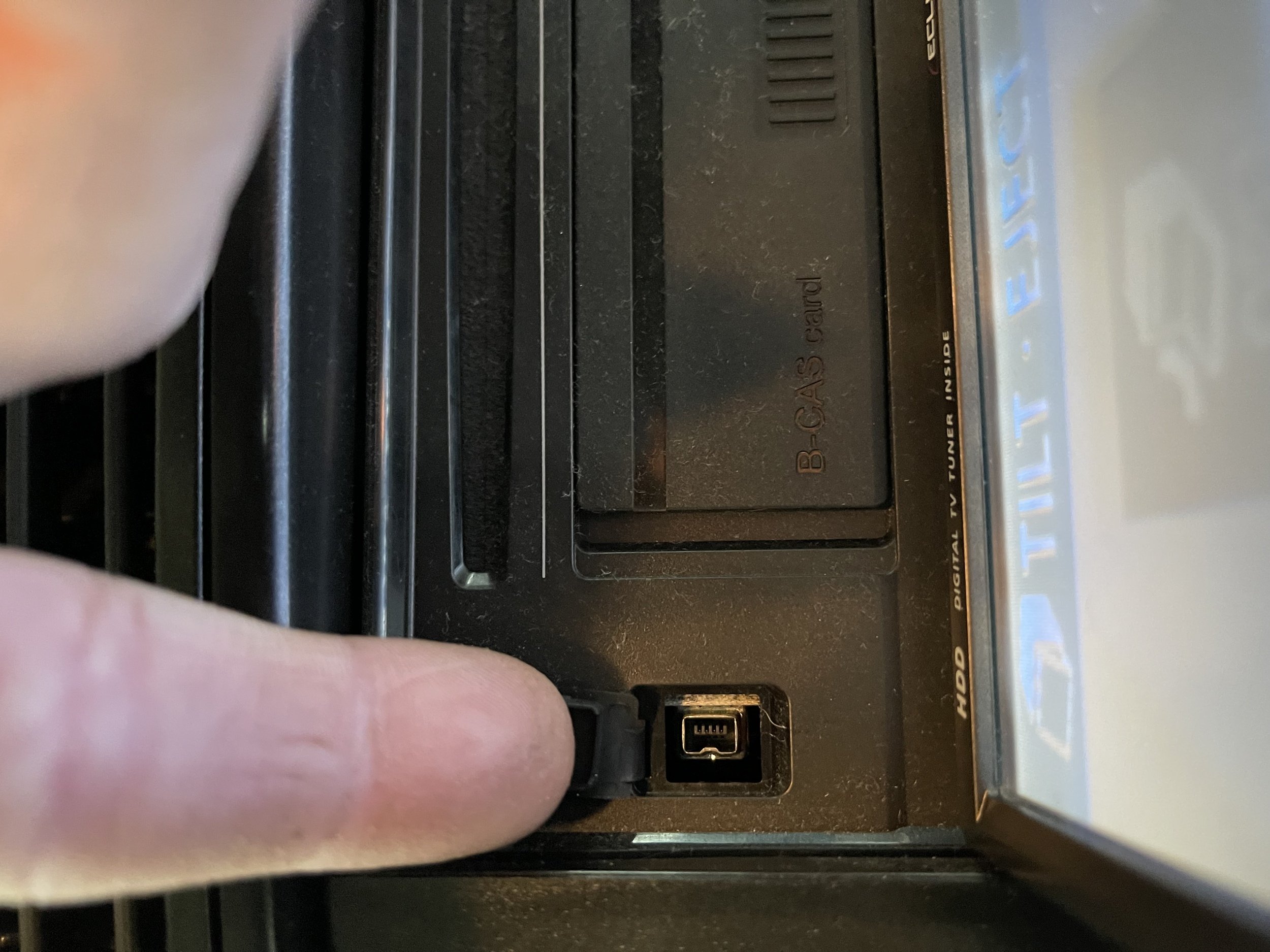

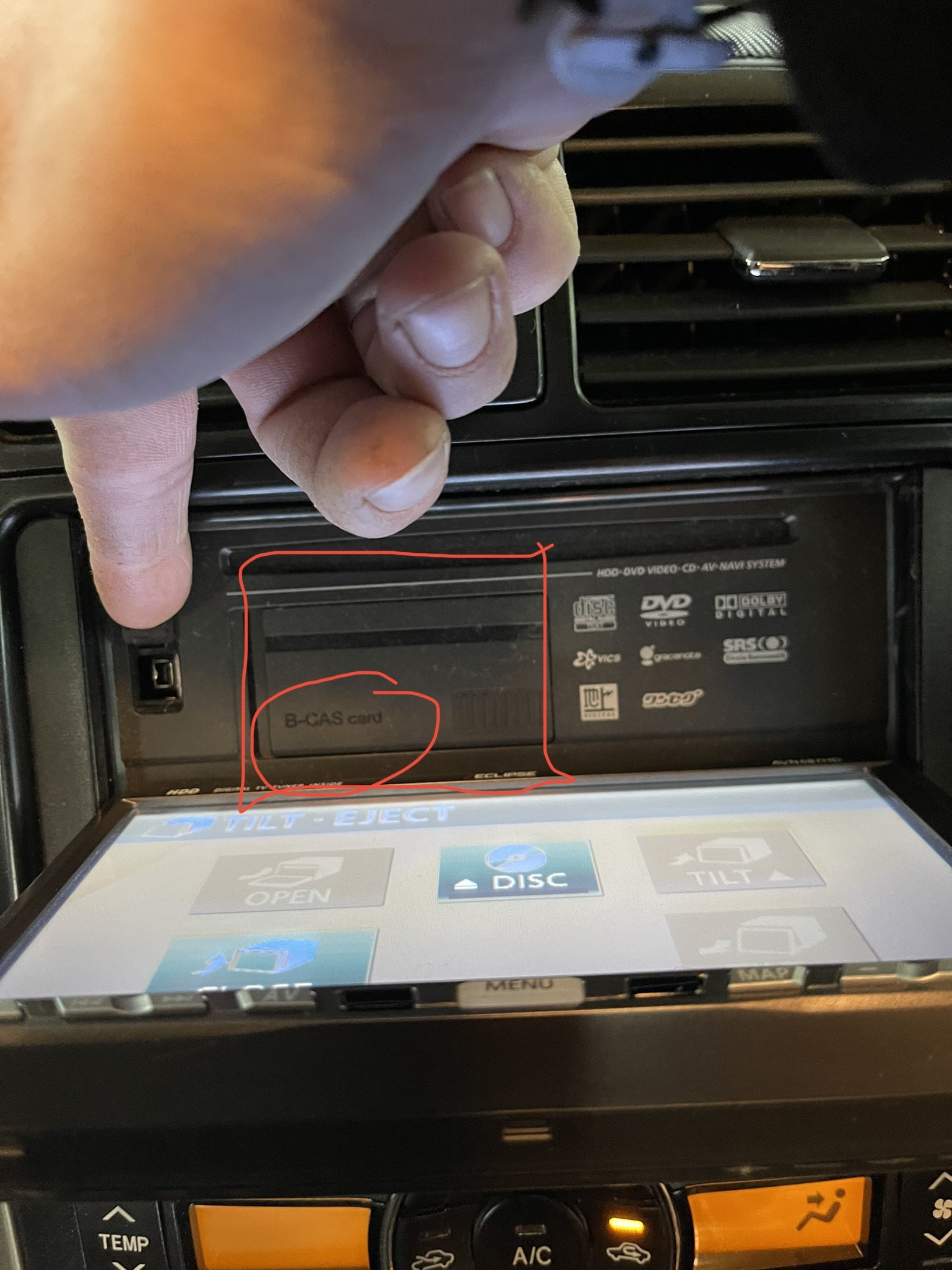

The Eclipse AVN687 system that is currently in place has a screen that tilts down to expose a CD slot and just beside this is a small square plug port that I have photographed and attached to this post. I wondered if maybe, hopefully, this port could be used to plug my iPhone into the system so as could play music from my iPhone's digital library?
I’m not sure what sort of cord would fit this port but I'm hoping it's an audio cord given it's placement beside the CD player.

Pretty sure all Toyota up until very recently have "iso-mount" which means the hole in the dash is standart aftermarket head unit width and there are brackets in there that bolt to the new head unit and bolt into the car very easily. Hopefully whoever installed that Eclipse unit bought a wiring adapter so you have a little more wiggle room, but I'd bet that the wiring from the Eclipse are also standard colors so just finding any reputable brand double din head unit should make for reasonably simple plug and play swap if you can figure out how to get the dash off and un-mount the Eclipse.
Stick to Pioneer, Kenwood, JVC, Alpine, or Sony for head unit for best results. Those are the top well established names for those.
