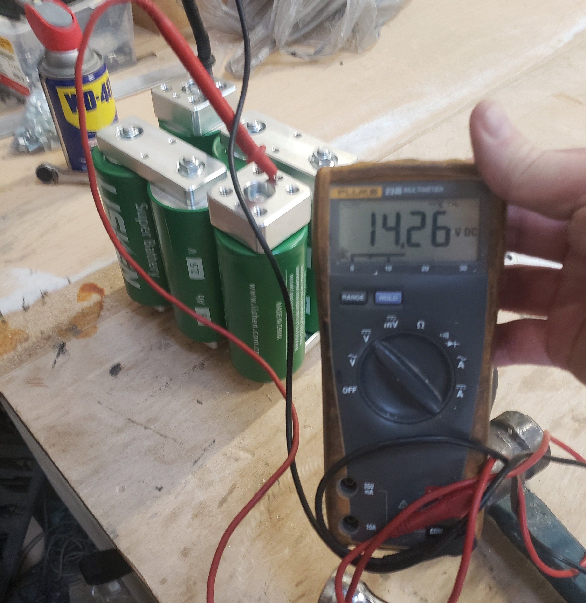

From what I read before hand, and what I'm experiencing now, the caps will stay perfectly balanced to whatever the voltage of your battery is (be it lead acid, or lithium) So if I have a strong fresh AGM thats resting at 12.9 volts, my caps will also rest at 12.9 volts.

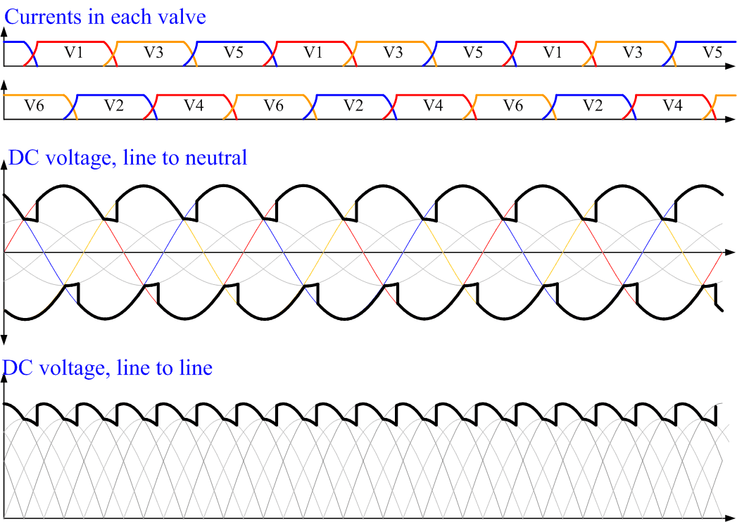

The alt charges in pulses, the alt actually creates AC current, that is then filtered by diodes into DC current. BUT, the DC current is pulsating, it's not constant DC current like a battery alone provides.
So the alt is sending out rapid pulses of DC current at 15v or so, and the amp is going to use that pulsing 15v charge to produce the amplified signal sound to the subs, probably largely through transistors. The pulsing of that 15v coming from the alt, that will cause pulsing variations of DC voltage going into your amp. So your amp is constantly getting pulsing DC current from the alt, instead of getting a smooth, non-pulse power current from something like a battery would do.
That current from the alt and voltage pulses at a fast rate, because the alt spins fast, and if it's a 3 phase, there's many pulses happening per second. That's where the charge and discharge rate, plus the high voltage capacity of the capacitors comes into place.
The caps can capture that higher voltage pulse from the alternator(s), and feed the amps a more constant 12v power-signal, vs a pulsed varying voltage power-signal at a high frequency that's coming from that alt. It's like pulsing from 15v to 12.6 back to 15v very very quickly, that's why charge/discharge rate on caps matters, gotta be fast enough to catch the pulse and dampen it. That way, your amp isn't constantly having to do very quick minor adjustments in voltage and current to provide the same voltage for your sub woofers.
The capacitors are so fast in their dealing with electricity (charge and discharge), that they can filter 12v pulsations within a system, and provide the amps with a pure, non-varying 12v power source, so your amps aren't fluctuating both amps and volts within themselves, and the power output to the subs is more consistent and more controlled.
The caps can take the pulsed DC waveform (which is varying voltage), and smooth it out to give your amp smooth electrical food, instead of pulsed electrical food:

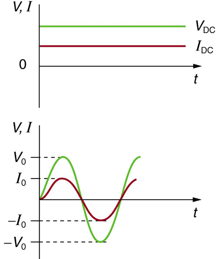

DC current is a flat line, you want your amps to be powered by the flat sustained voltage:
29108

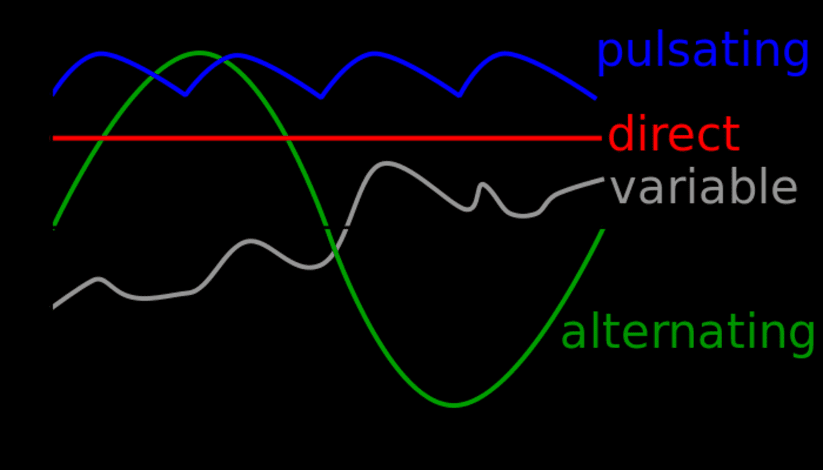

Alternators put a slight varying voltage waveform into the 12v system, and that can cause your amp to constantly varying in it's output because of the rapid changing of voltage. The blue wave is the pulsating 12v DC of varying voltage that your alt puts out:
29109
So ultimately, you'd want to use caps, IMO, to dampen the higher voltage alt pulsations, so that the amps get a steadier voltage supply. That means the caps help turn the pulsating signal into a flat signal, which means better consistency and stability within the system.
