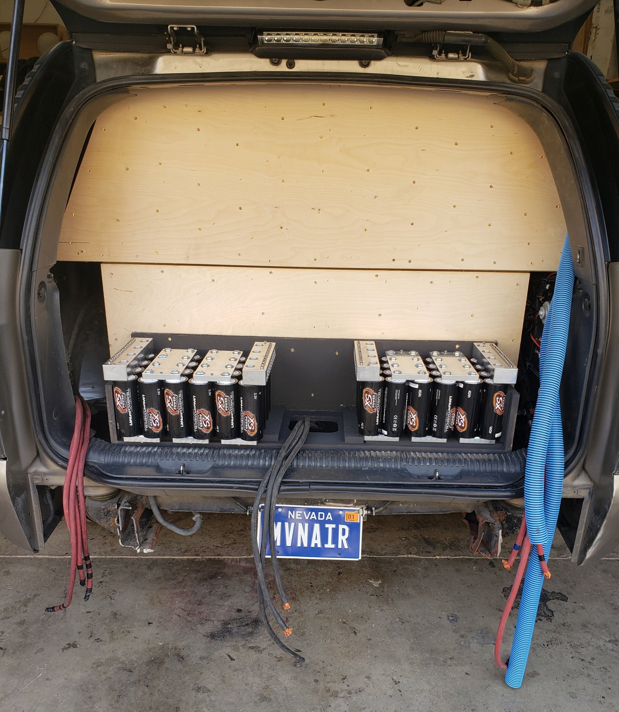

I'm running 3K with an AGM and a 320 amp alternator an all 1/0 gauge wire and it still isn't enough. I still drop to high 11's and low 12's on bass heavy songs with the car idling. I'll choose to run a 108 ah bank of lithium that weighs 11 pounds and cost me $230 over a 75 pound AGM everyday of the week. It's smaller, cheaper, discharges slower, charges faster, and lasts a lot longer.

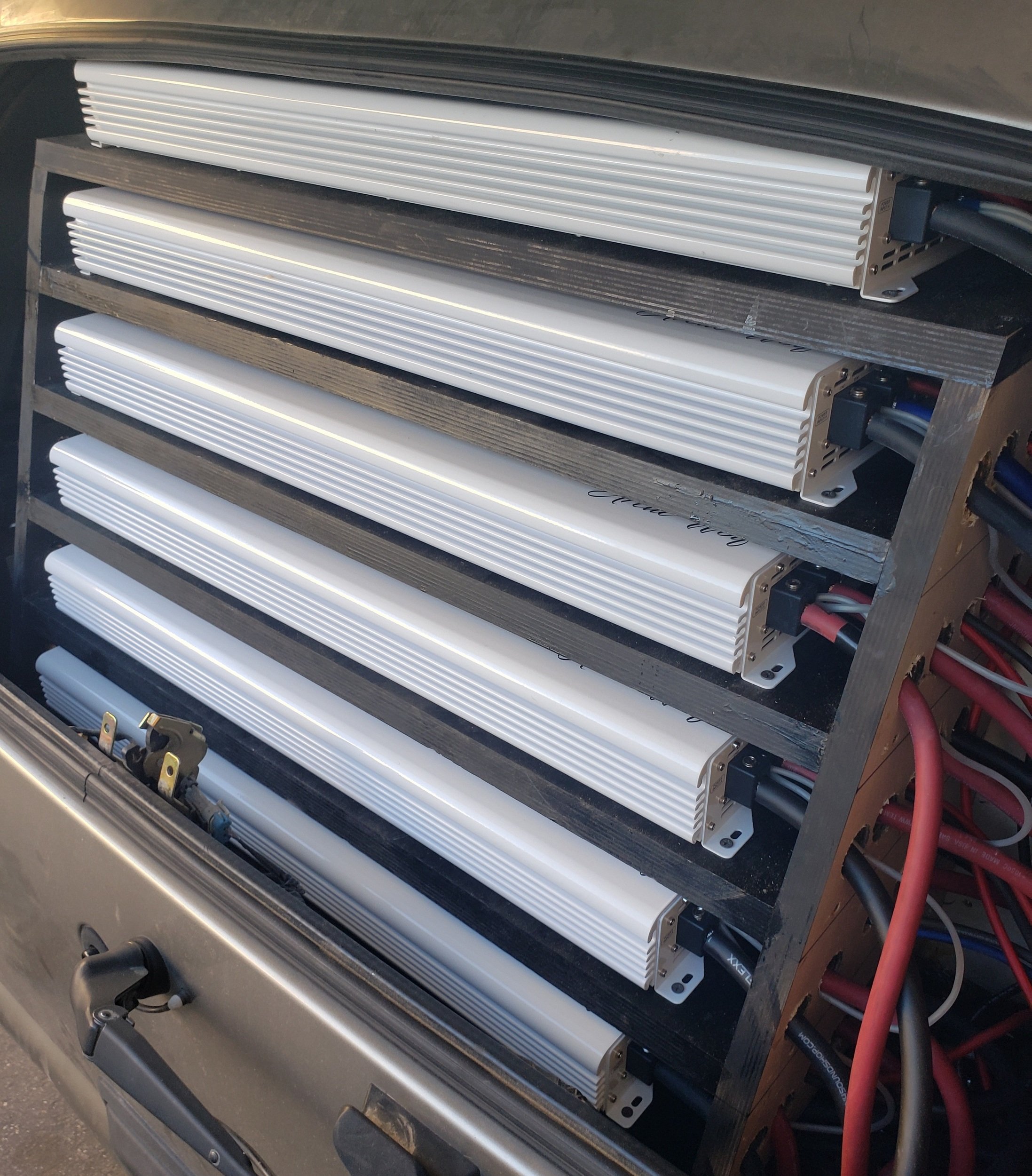

This guy has zero supercaps and is running 54K watts to six team Fi 18's. All lithium and alternators. 6- 9K Wolfram's

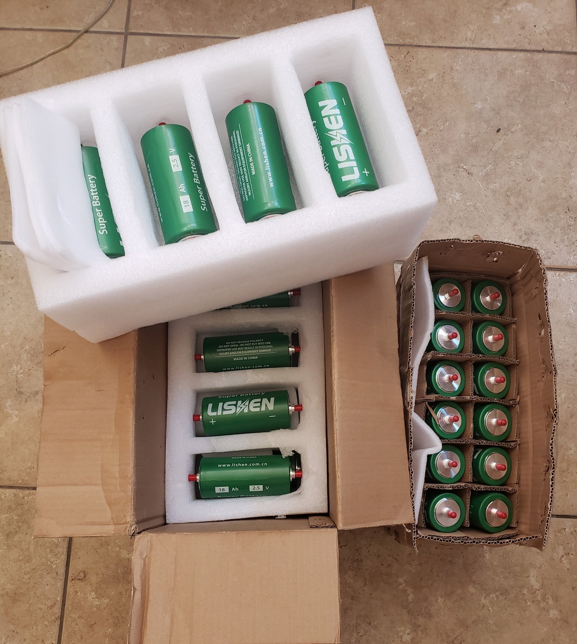

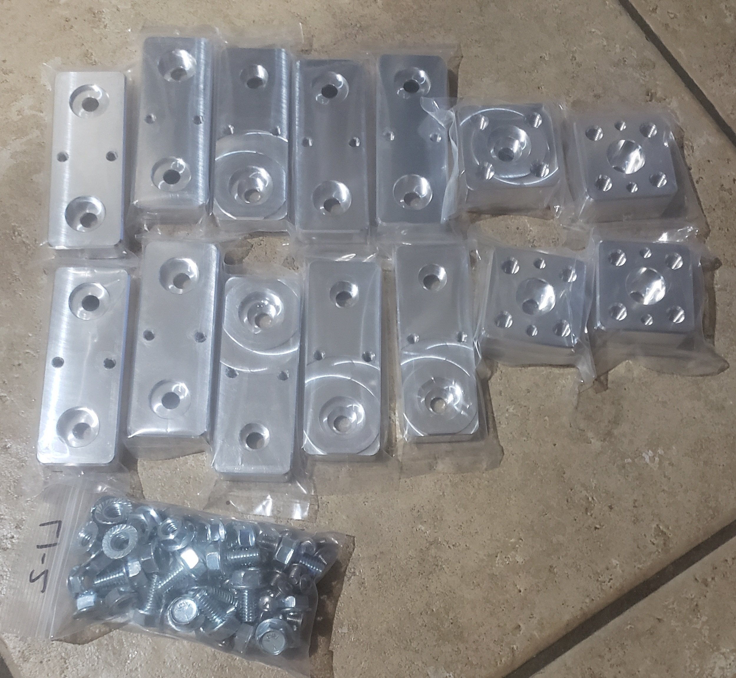

Why do you think lithium is so expensive? I just bought two banks of lishen and the bars for $460 delivered. That's 216 ah. They should last 5-10 years and only weigh 22 pounds combined.

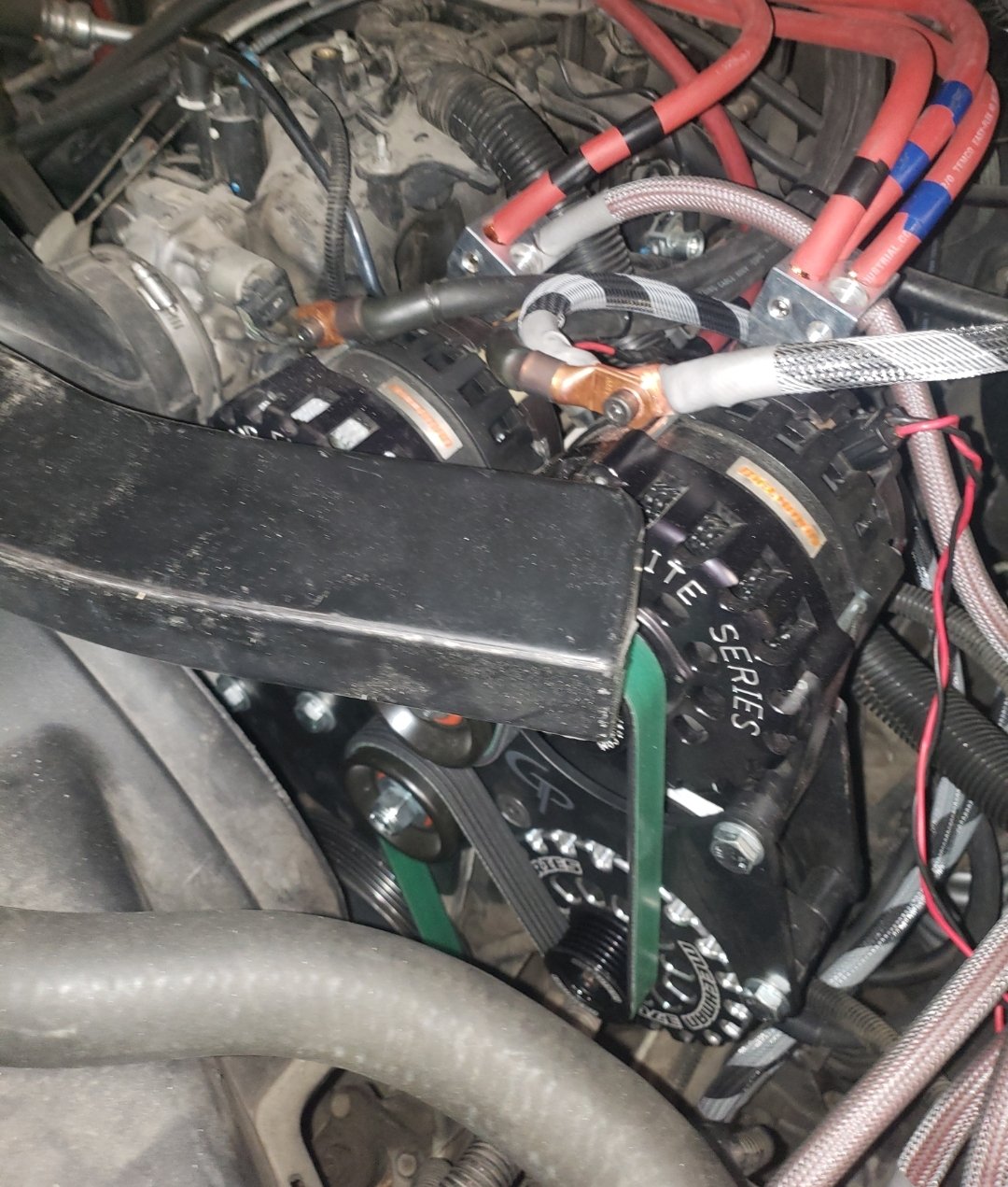

How have you verified that your alternator is making that much current under real world operating conditions in your vehicle?
