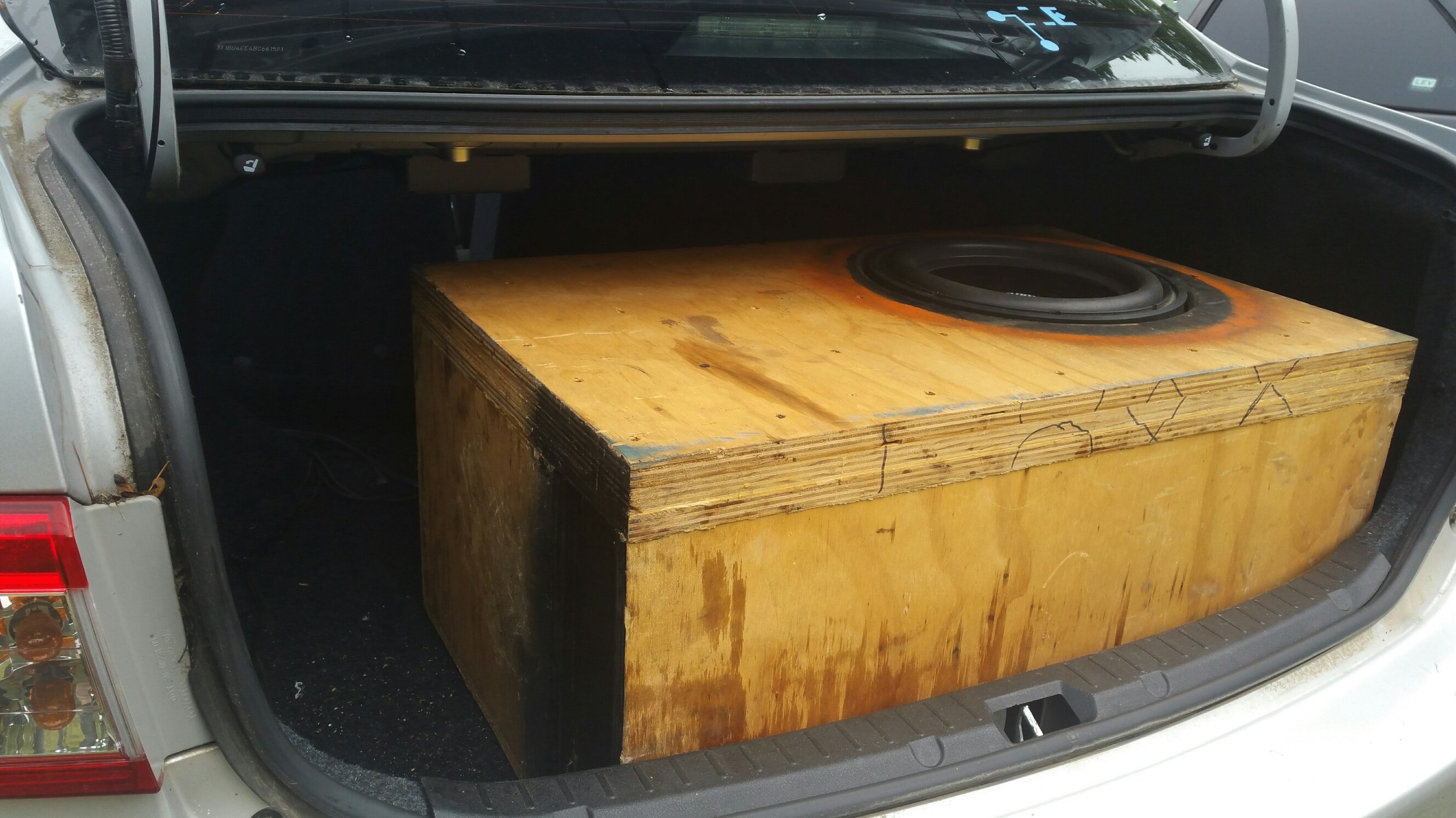

You can fit ONE proper 12 in there and that's all you should need. Modern high output subs are almost all designed to function well in ported box. The trick to making ported box sound good is using a well designed sub and having the proper box volume and port dimensions. This is the trunk of my Corolla this box is 3 cubic foot net.

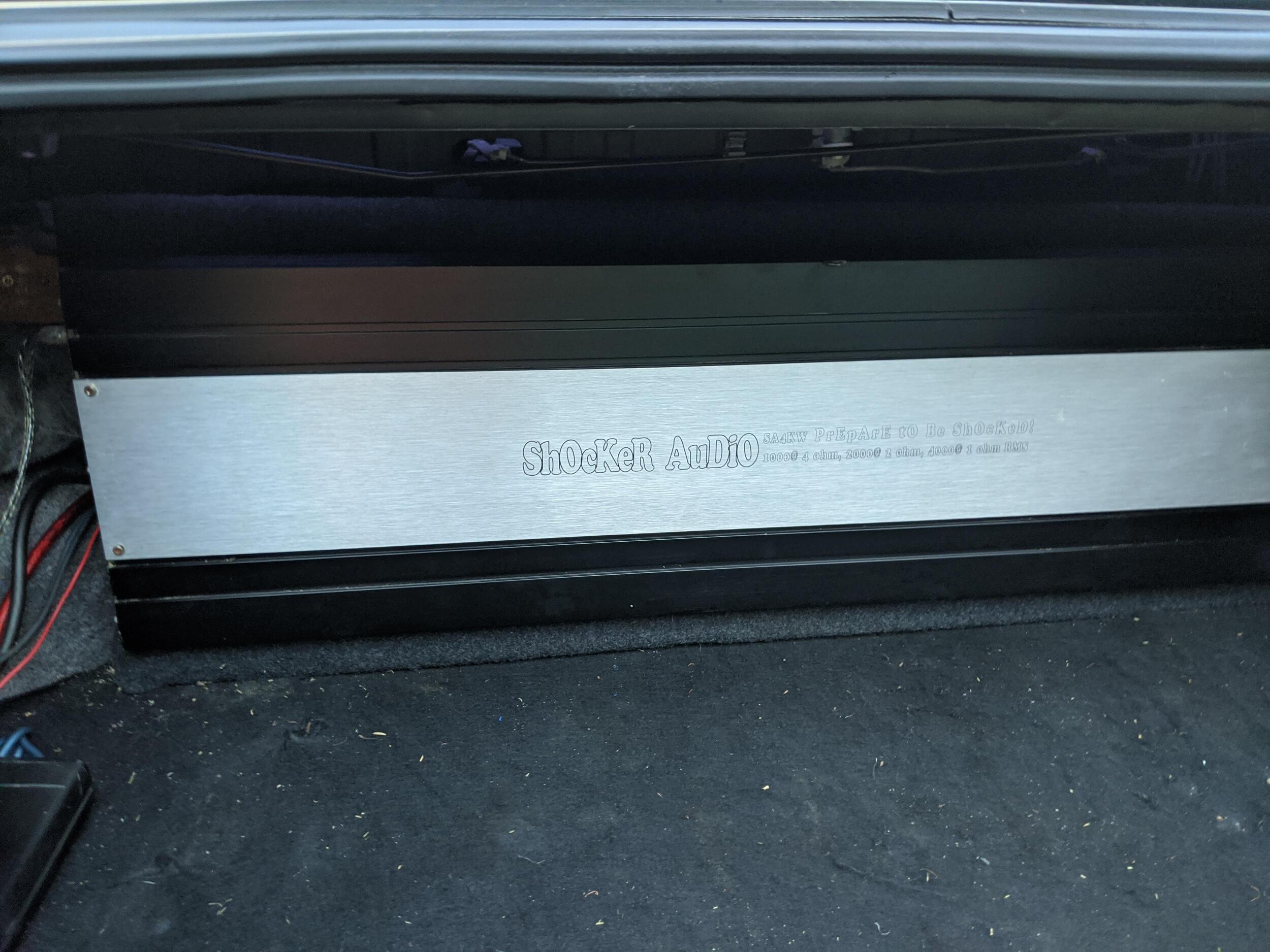

23472
How does he power the subs? Does he have 3 mono amps or something?
One large amp. Figure out what amp you're going to use and buy appropriate coil configuration subs. You can hook up any amount of subs you like to a one channel amp.
23475
btw this is whats achievable with a single 12 on 500 watts. Box is everything. One properly done 12 on 500 watts can utterly destroy three 12s on 3000 watts in sealed boxes. Space makes bass. Whatever you thought you knew about getting loud and sounding good is completely different than how things actually work in the competitive level.
