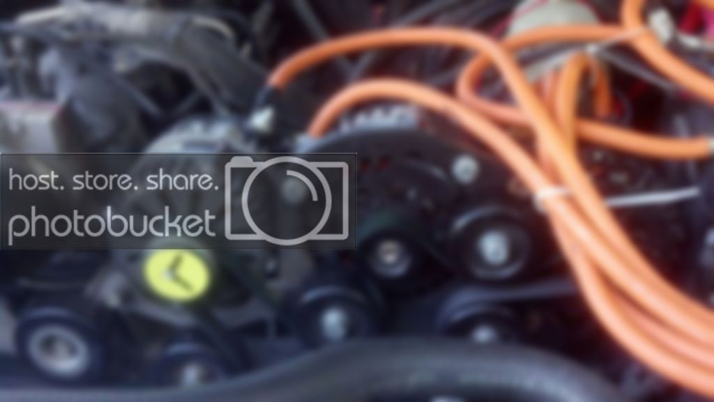

I got my US 390 installed, and now my dash says "charging system failure"
I'm going to have to give them a call on Tuesday. The last time I got that message, it was because I was running two HO alts without the factory harness connected (so the computer didn't sense the alternators).
After a certain amount of starts, the computer governs your RPM to 1.5k until you get it replaced. I don't want to be stranded somewhere with a top speed of 30mph

Yeah, I don't like that feature either. The last time it happened, I was on lunch break during high school and was late to class because of it. They designed it that way so you have to go get minor problems serviced and can't just ignore them. It'll say "reduced engine power" on the cluster and not go over 1500 rpm after about a week of starts

For me, it did it when I was running dual alternators not connected to the stock plug. Not using the stock plug caused the computer to think the alternator was bad. To fix it last time, I just put the stock alternator back on and got a quad bracket so I could fit more high output alternators. I'm using the stock plug on the 390, so I'm wondering why it's causing a problem with the computer. I'd rather call US Alternators first, before I take it to a dealership.

Truck looks nice with those rims and everything blacked out. Don't be a **** though, get the windshield tinted. I've also got the "CHARGING SYS FAILURE" notice on my 05 Tahoe. Happened about a year after running my Singer 300. I could not charge past 13.7 and could only get around 170 amps out of it. Had to swap back to stock and haven't sent it back to Mike to see what happened yet. Right away after swapping back to stock the error went away and I was charging normal once again.

13.7 is "limp mode" that the regulator puts the alt in when the computer isn't sending it signal or something internally went wrong. That's how my Singer 370 was, so I got a new regulator put in it for $50 and that solved the problem.

Ya I'm not sure what happened with the alt it was working fine for a year or so then just took a ****. Oh well it gave me motivation to buy a triple bracket. Now I just need to quit slacking and send the 300 back to Mike and get another one built.
