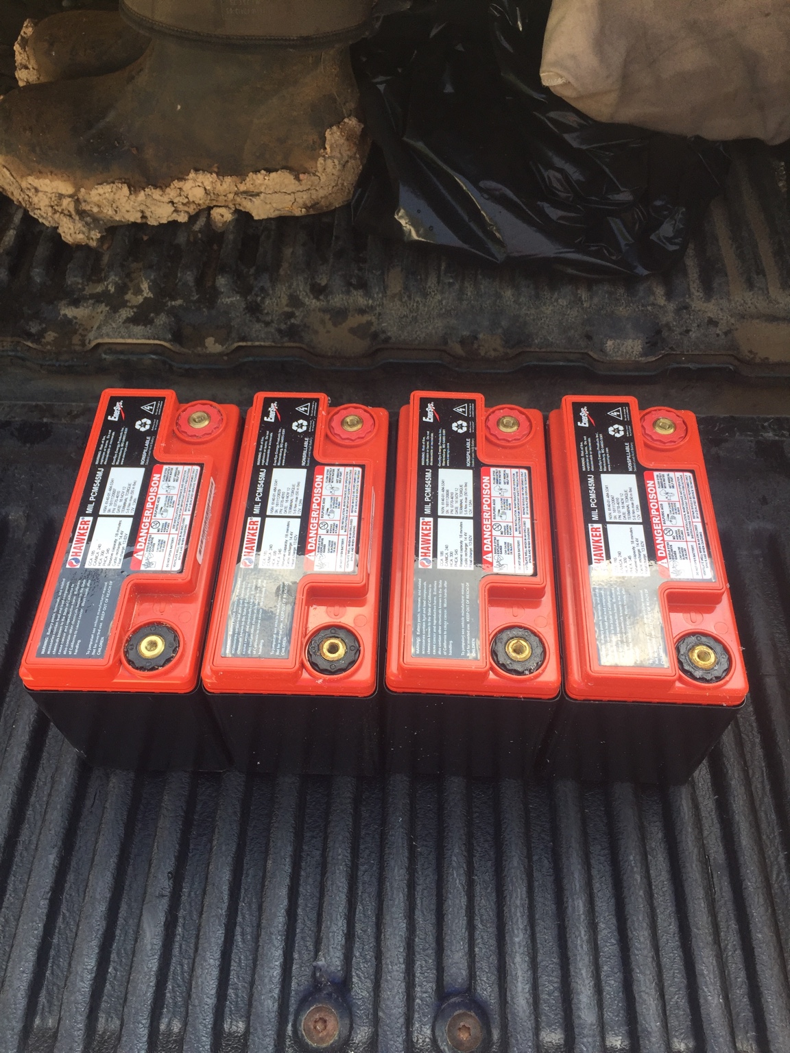

1. They weren't wide enough to touch all the terminals when set up like this. Would have either needed bus bars twice as wide or twice as many bus bars and have a half-inch gap between bars.
2. The holes didn't have to be super accurate when set up like this. There's a little play in it and it also allows the batteries to shift slightly without damaging the terminals
3. I already had the wires cut/crimped/shrinked from my last build
Yea I noticed your battery configuration right after I commented what size flat bar aluminum did you use.... I'll be making mine with 3/4 thick 1 1/4 wide flat bar but I'm gonna attempt to bolt batteries together
Also you got those batteries from where/who?

If I could for free I would
[quote name='els1989']Yea I noticed your battery configuration right after I commented what size flat bar aluminum did you use.... I'll be making mine with 3/4 thick 1 1/4 wide flat bar but I'm gonna attempt to bolt batteries together
Sent from my iPhone using Tapatalk[/QUOTE]
That seems way too thick of material for those batteries.
I got mine from work for $50 a piece

My bolts will be sunk inside the buss bar similar to others bolt down terminals... And the bolt down terminals that have 6 input slots are 1" thick... So I'm not seeing how it being thick is gonna be a bad thing... I will be drilling and tapping threads to attach lugs on the top side similar to yours
Ok. Drilling and tapping looks nice, but takes too much time for me. I did that with my first bus bars I used in my car. Now I just drill holes and bolt through.
I'm just saying using that much material is not necessary
I used 1/2 inch thick to carry 5,100 possible amps of current per bar and have .1v voltage drop at full tilt idling
