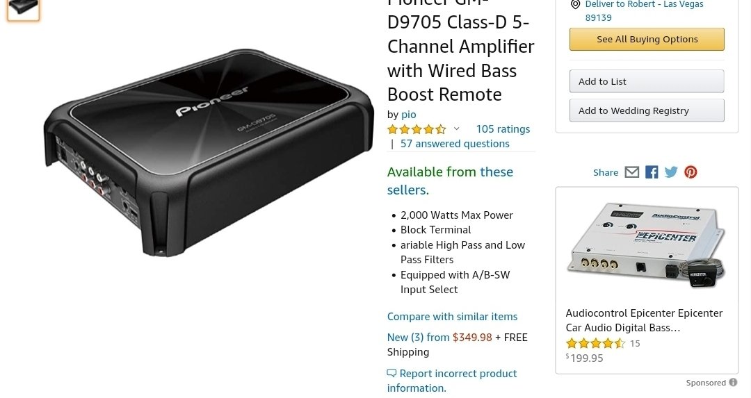

So, what's wrong with the Pioneer 5 channel for his system? It gives him 100 x 4 and 600 x 1 on a dedicated bass channel with a bass knob. The sub that he picked is only 250 rms., so, he would be feeding it more than double the rated rms. Plus, it's an easier install with only one amp. His stock electrical can handle 1,000 watts.

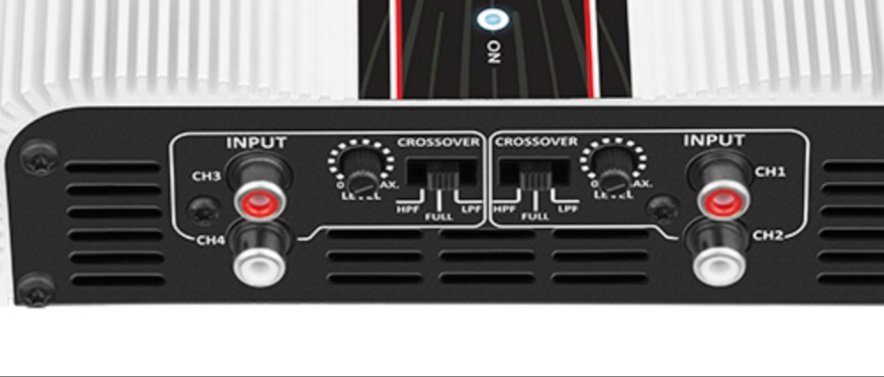

The only drawback is that the Taramps doesn't have crossover points. Isn't that going to be a problem?
