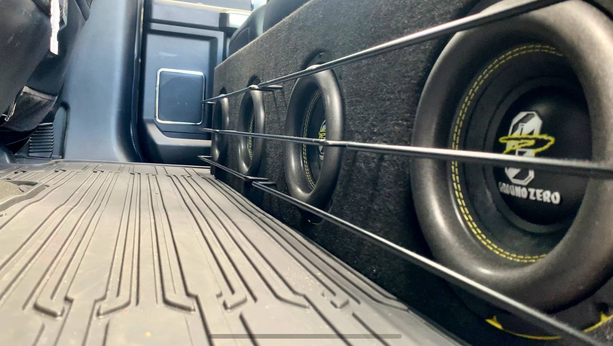

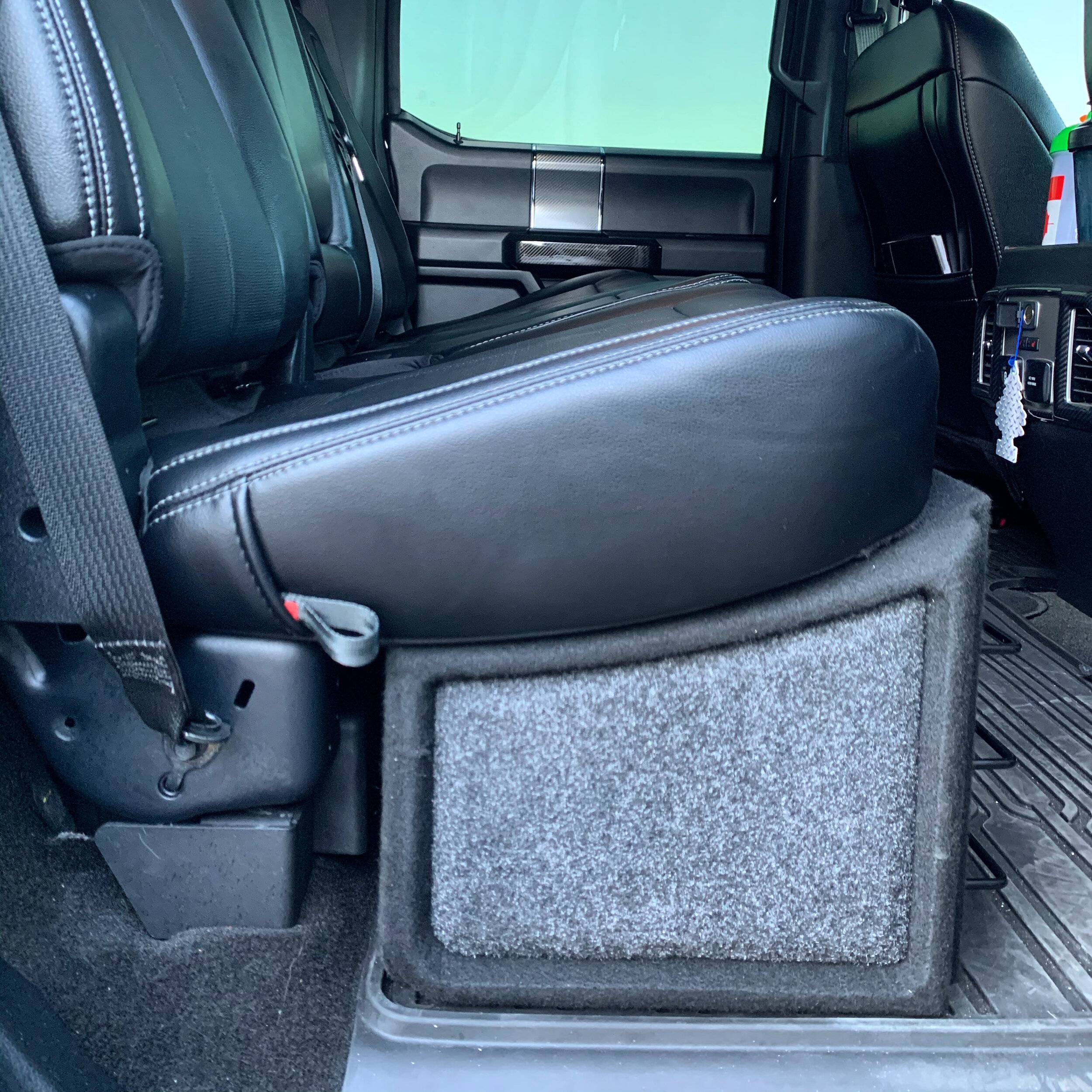

The set up I had on my 2020 with the factory B&O system. I’ve had lots of different under the seat combos on my previous half tons but it wasn’t ever enough. I went with 4 8” Ground zero subs, custom sealed box, custom 2” seat lift, Soundigital 5000.1 evo amp, LC2i line output converter and 0 gauge wiring. All on stock electrical. It pounded. So much better than the previous 2 10’s I always ran.
A few more pics..
