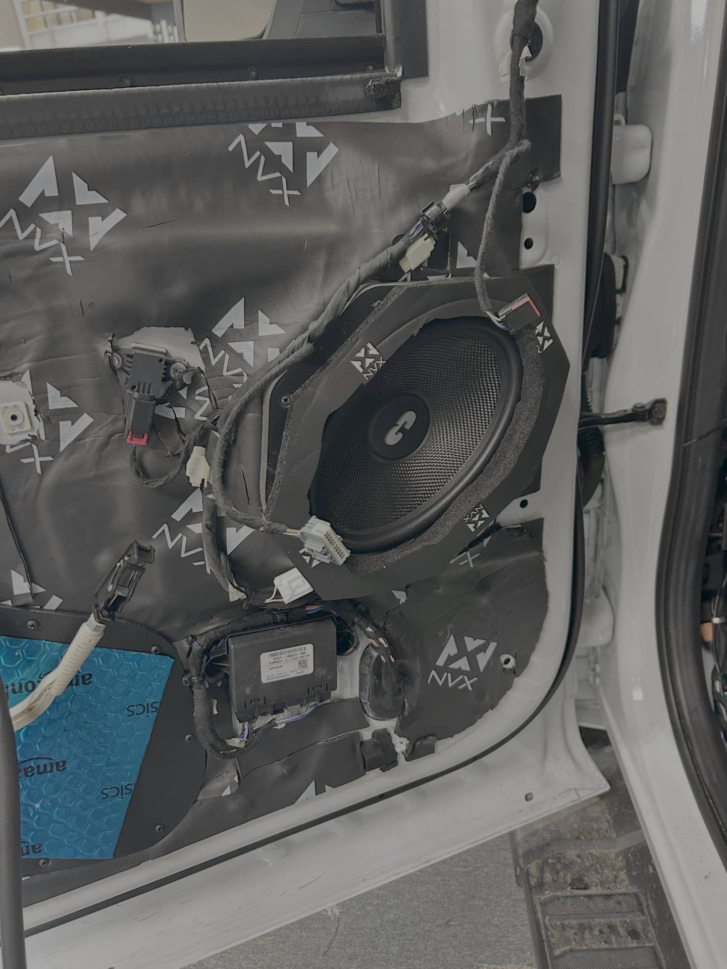

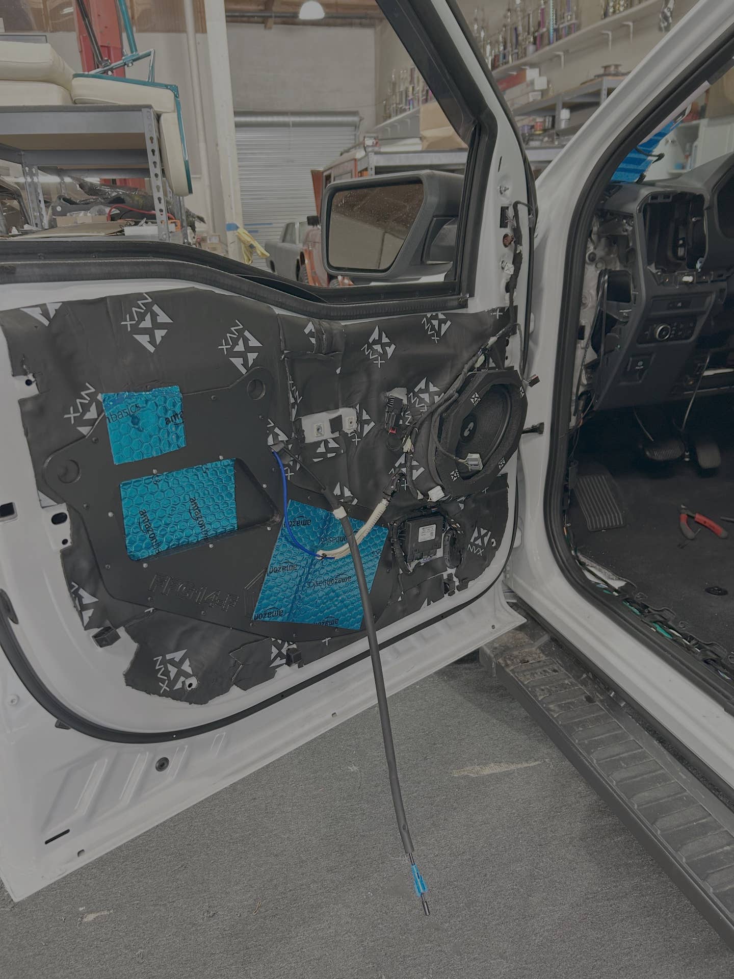

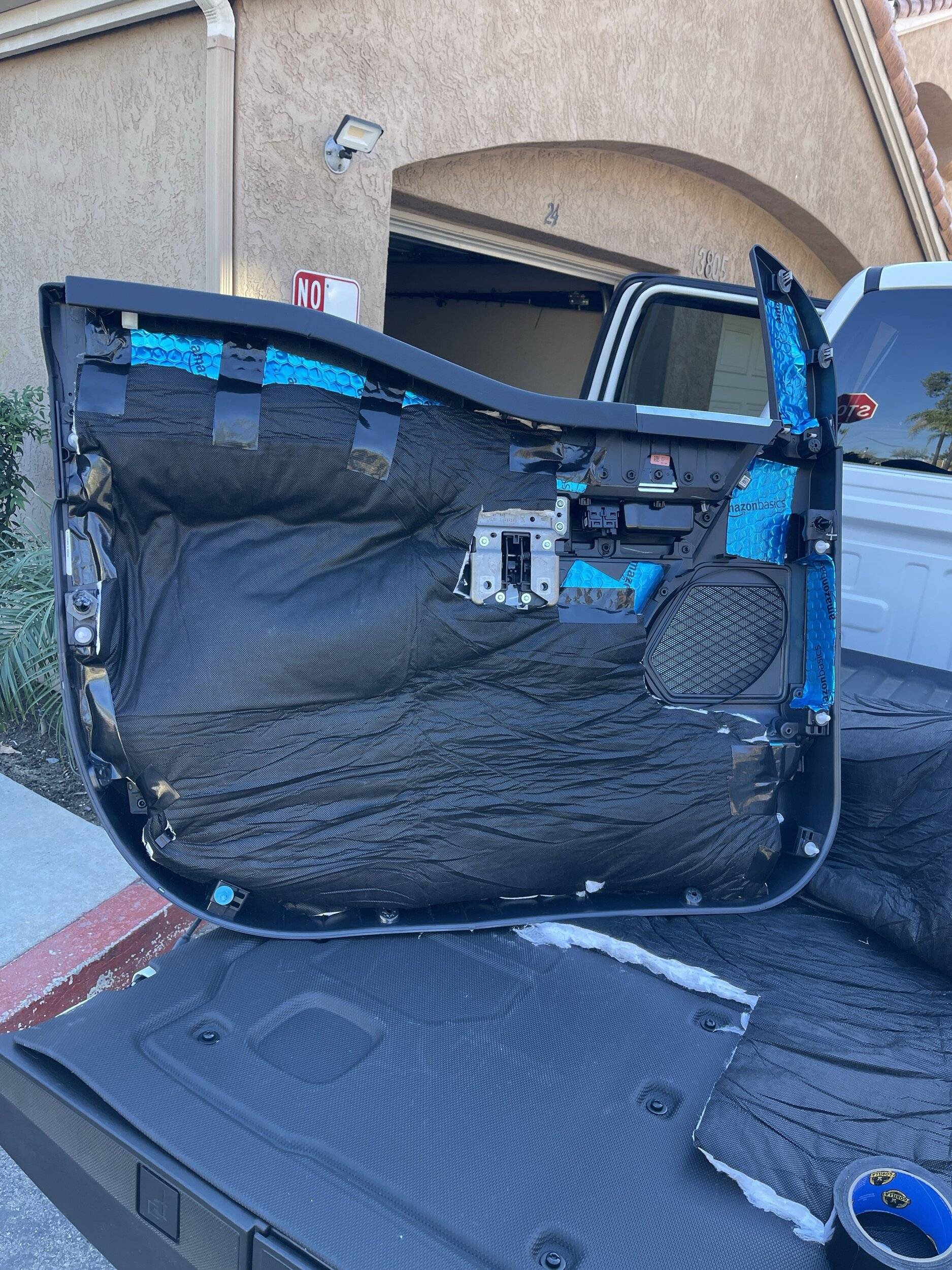

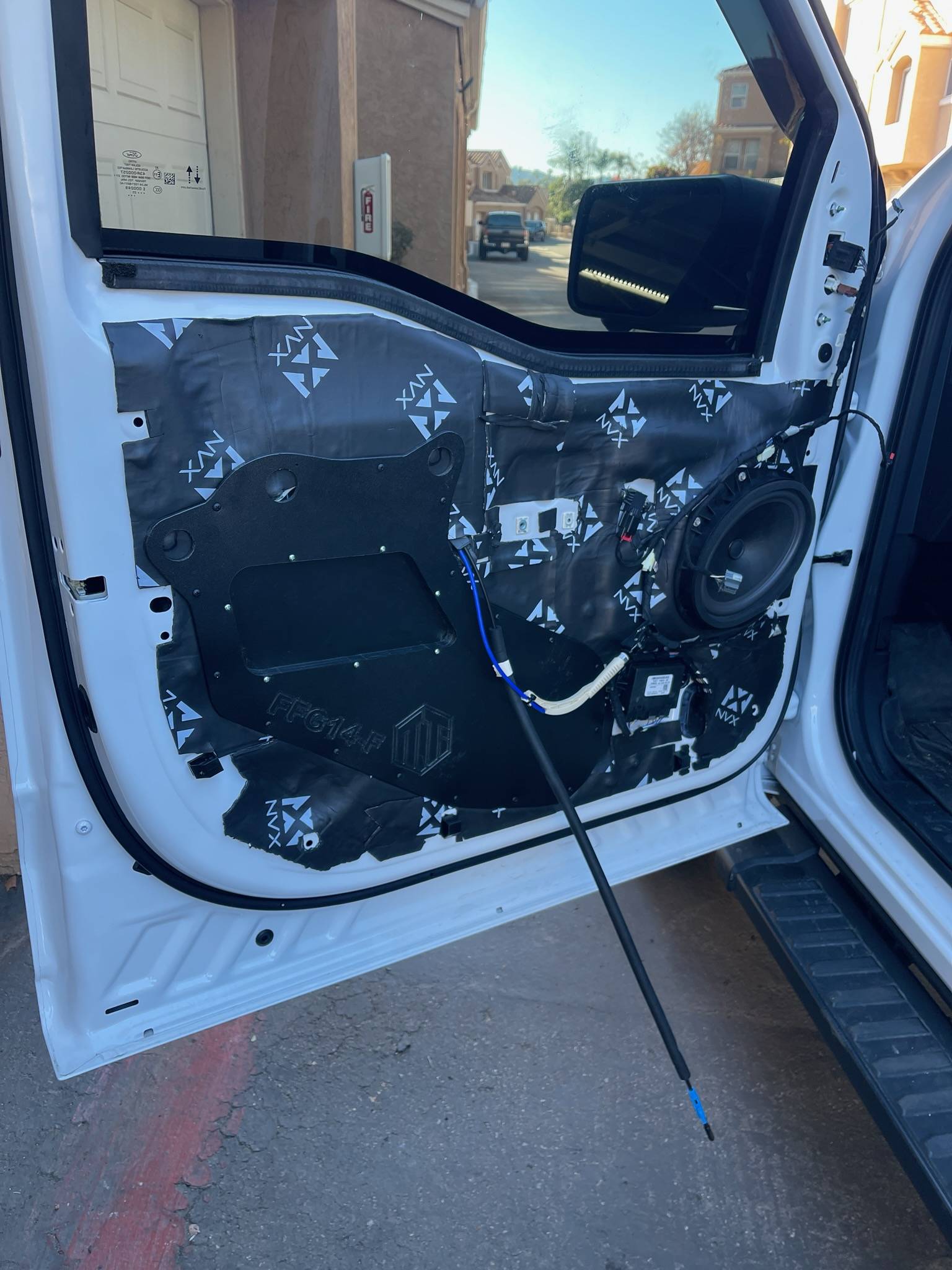

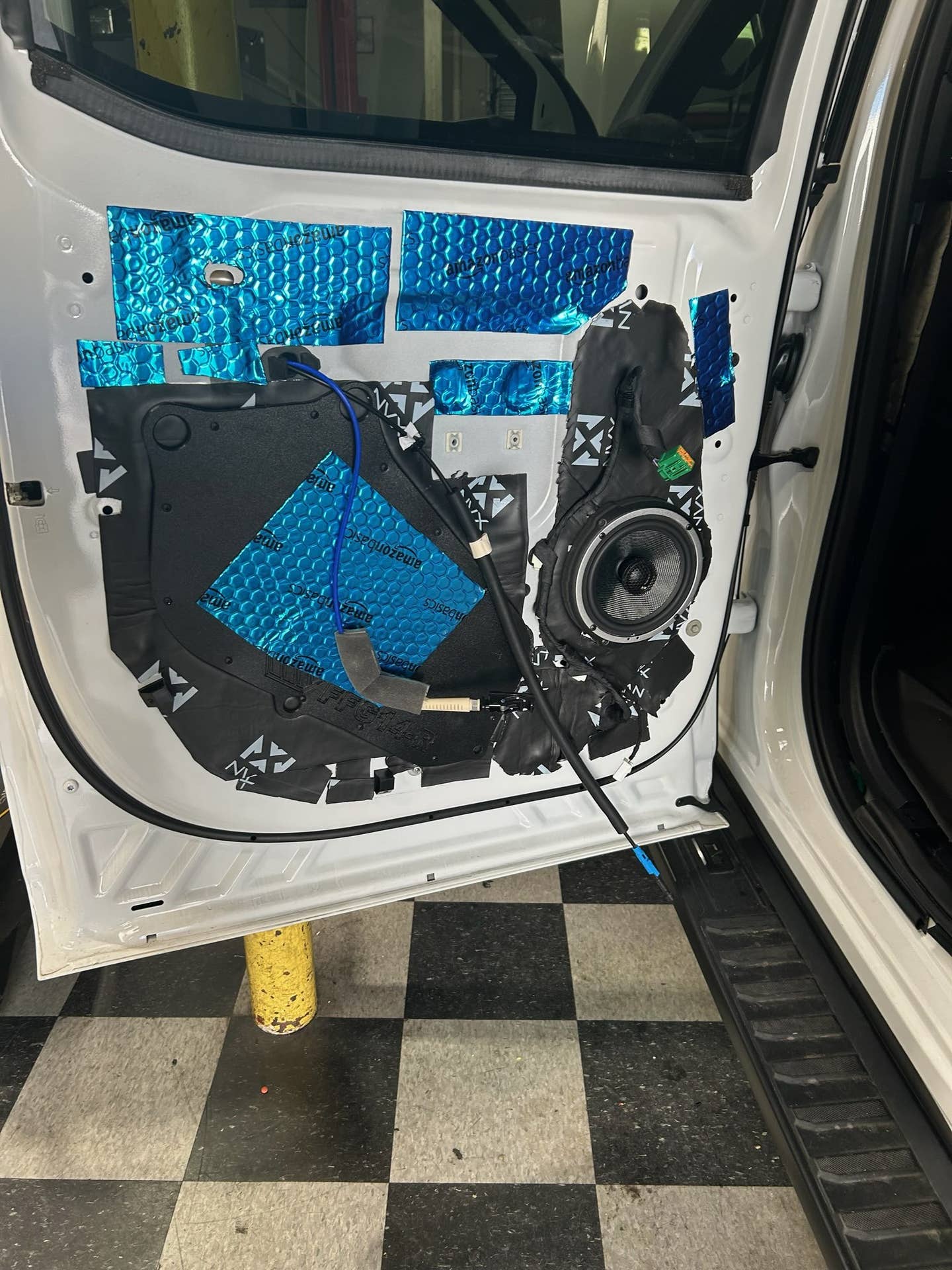

Got the sound deadening done,
Off to the shop to do the install & tune,
Well, hopefully this time around the CDT's doing me better this go around than last, this time with a DSP from the get go....
Went with CDT all the way around for 3 way sound stage, cashed in on the BF sale theyre offering.

went with
hd-690cf 2ohm 6x9 mid woofer front doors
es1200is tweeter
es-03 3" mid range
es-6ex1 6.5" 2ohm coaxial rear doors

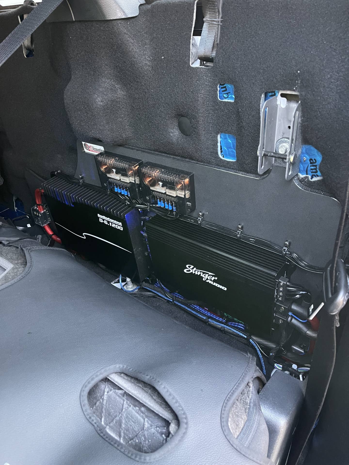

Stinger mt 2000, running at 1 ohm
Audio Control 6.1200 dsp amp

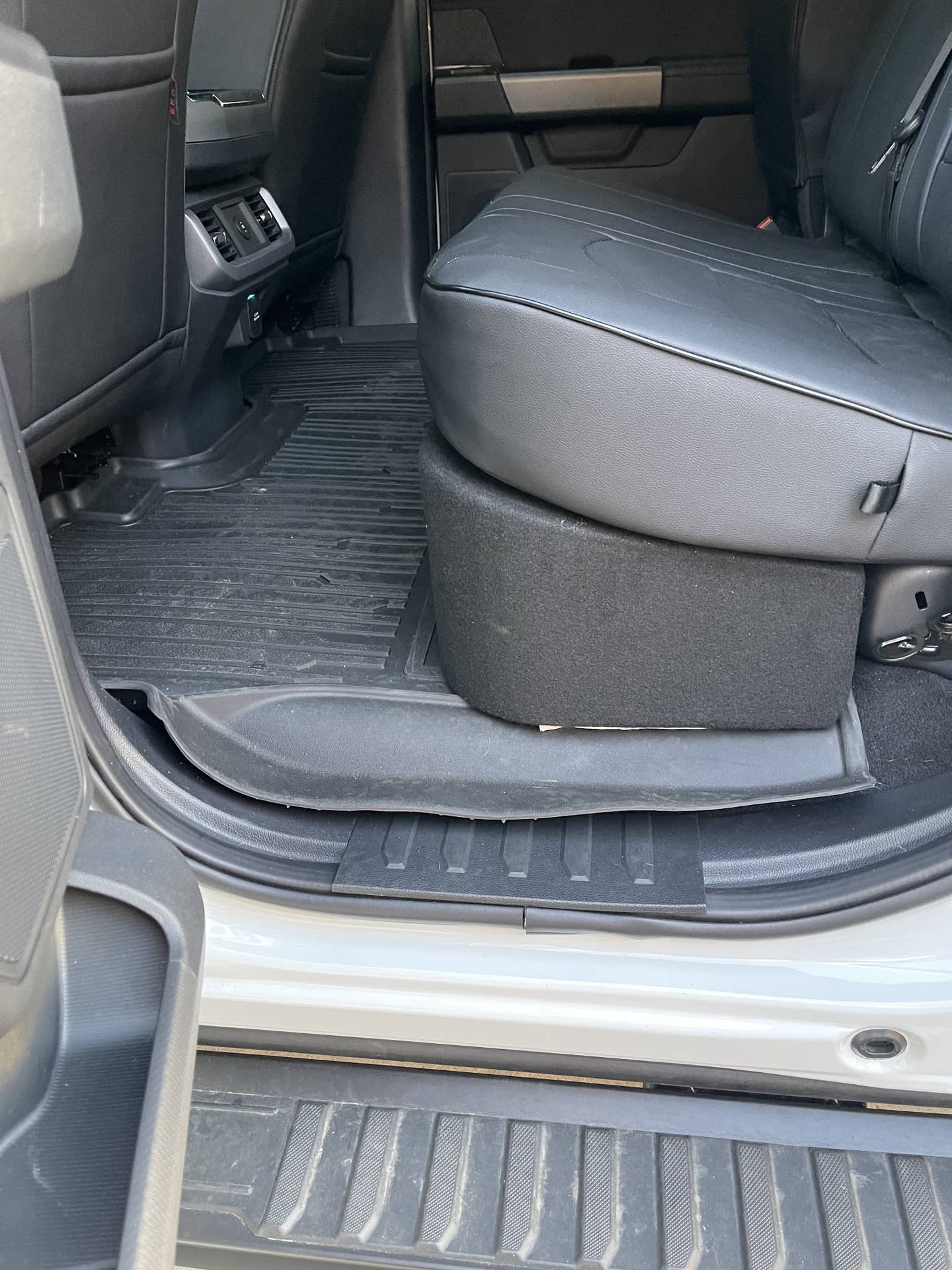

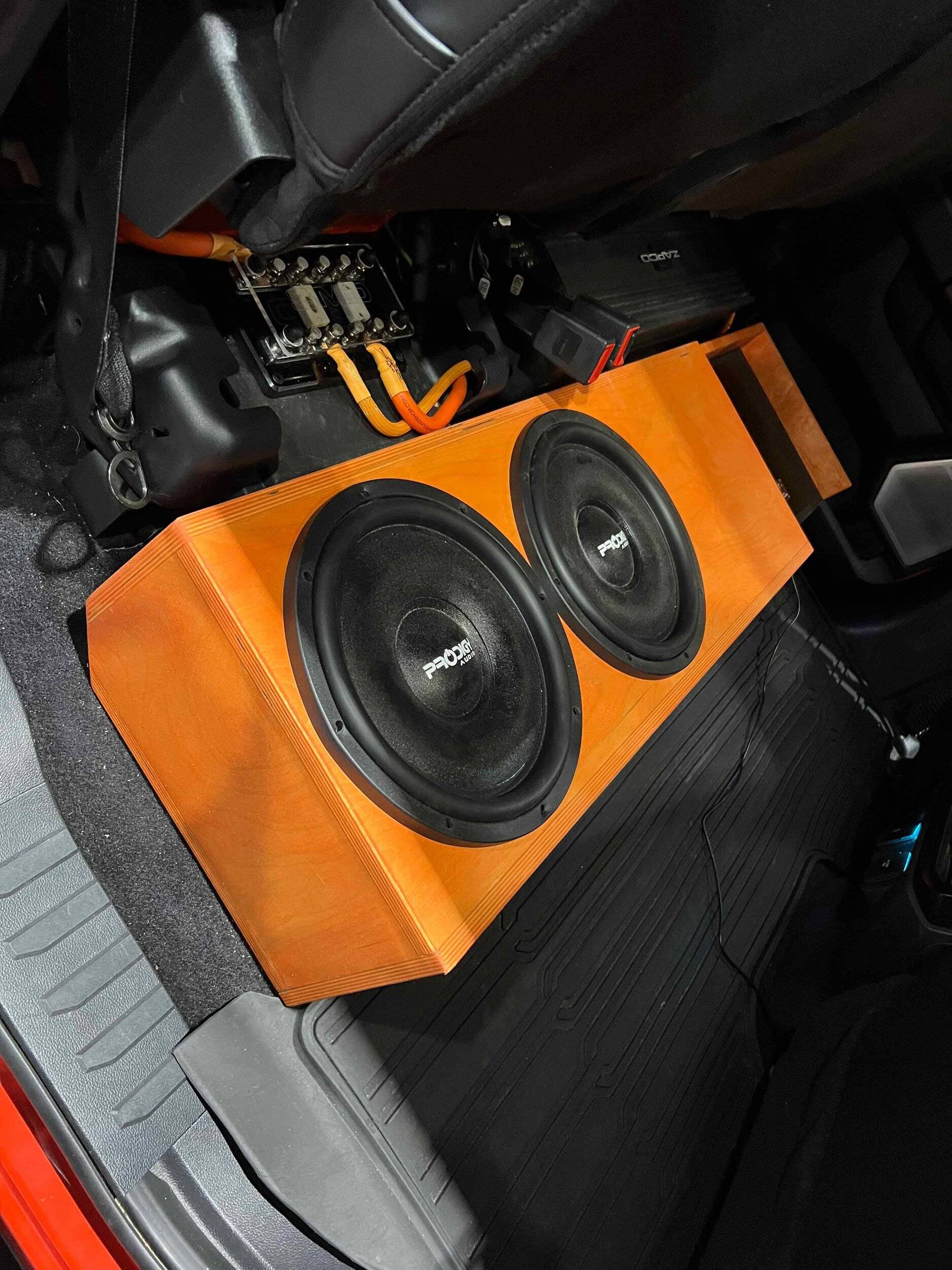

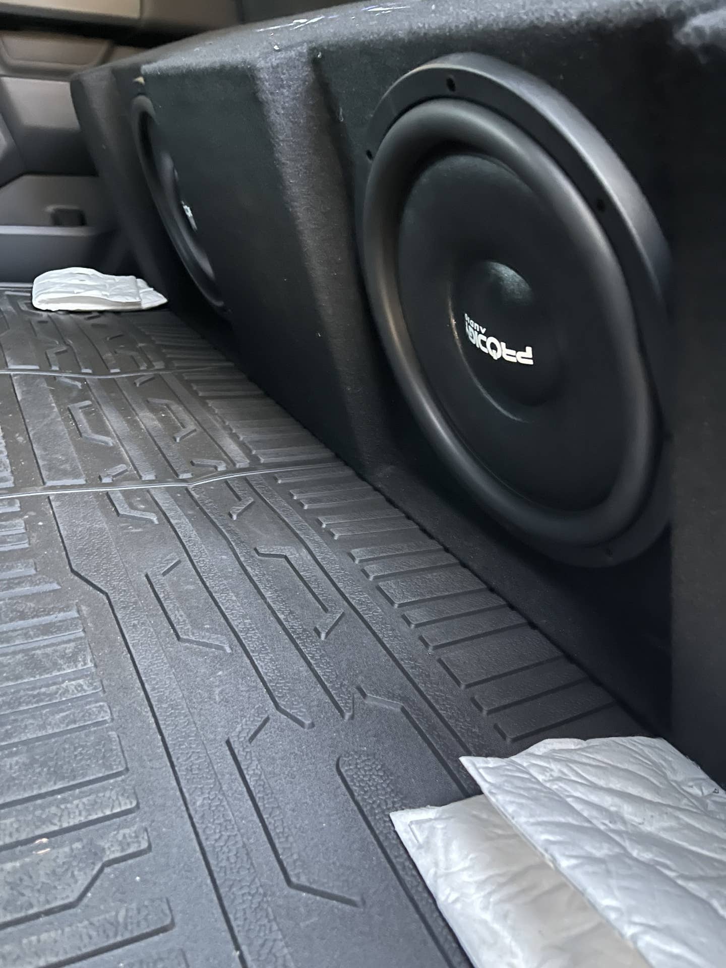

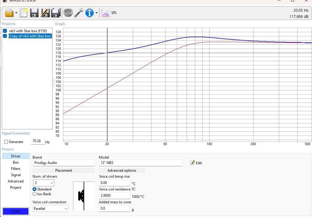

Rolled the dice & went with 2 Prodigy 12 Shallow subs NB3, that claim to handle 800 rms & has some presence in the SQ comps, so hope they dont totally disappoint
3" voice coil.
Also rolled the dice on a sealed down fire dual 12" SKAR box for $130
Had SQ-USA model the subs & box combo for me over at DYI.
Their response....
This doesn't look bad, but the specs on the prodigy look suspect. I modeled it quickly (blue is with cabin gain), at 800W each sub. You are good with xmax, but I wouldn't go much beyond that. For the price, I would at least try this first; you could probably resell the whole box for close to what you paid. Make a build thread and post pics.

Fingers crossed......
Ateast it gets me started, & cheap.....
The amp of choice can handle anything I throw under the seat,
So if it sucks, its not very dynamic / musical, I blow them up, etc...
Im not out a ton of money.
The owner claims they have a few guys doing SQ comps with them, so how bad can they be?

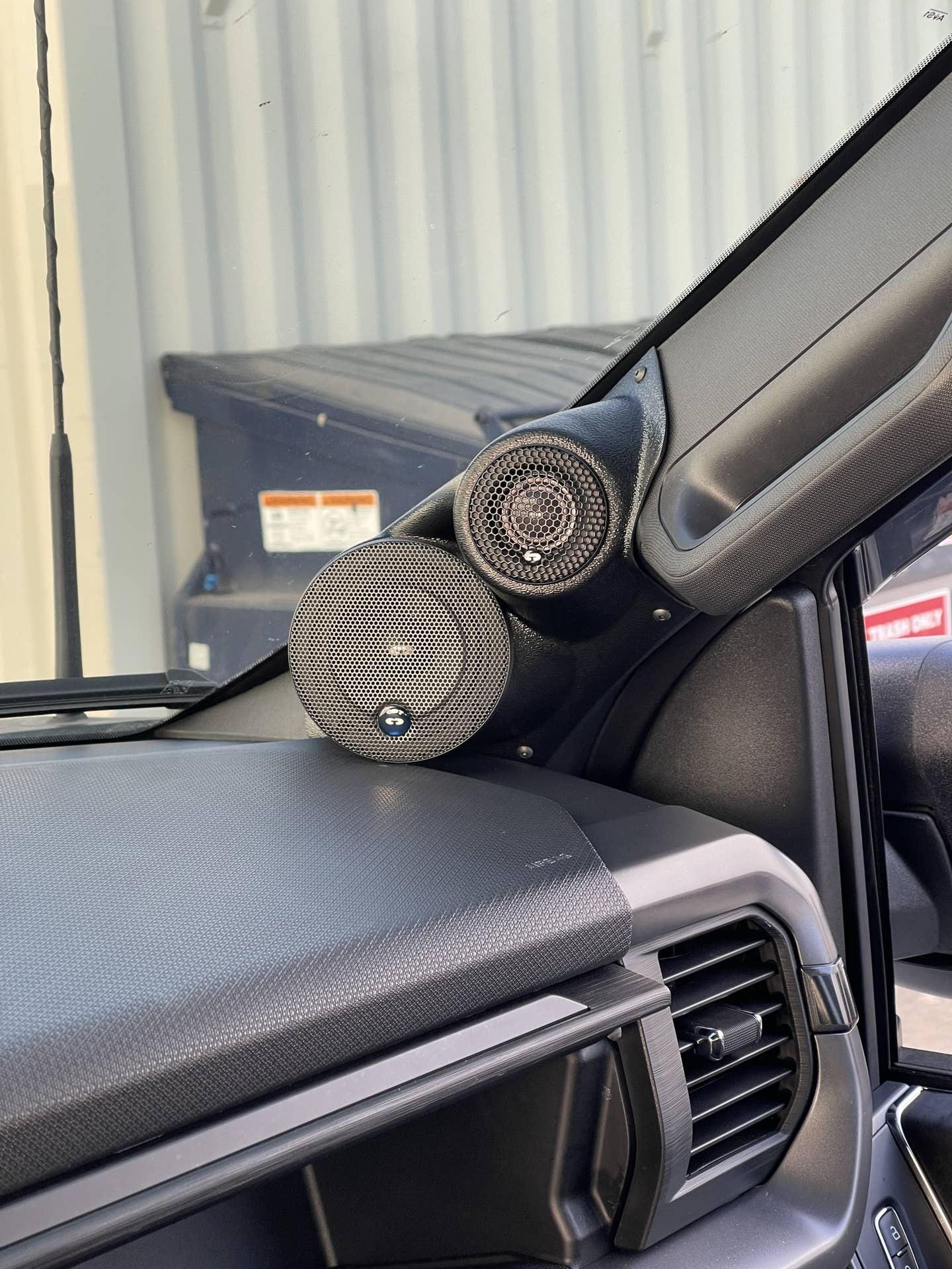

Sounds great for such inexpensive sound stage, think the speakers in the pods really helped with that, even though theyre cheap, dont see it being an issue at all....
I'm sure the pods made a big difference. Speaker placement and aiming are a huge part of a good sound stage.

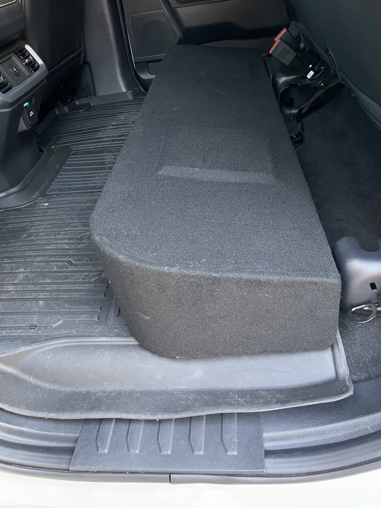

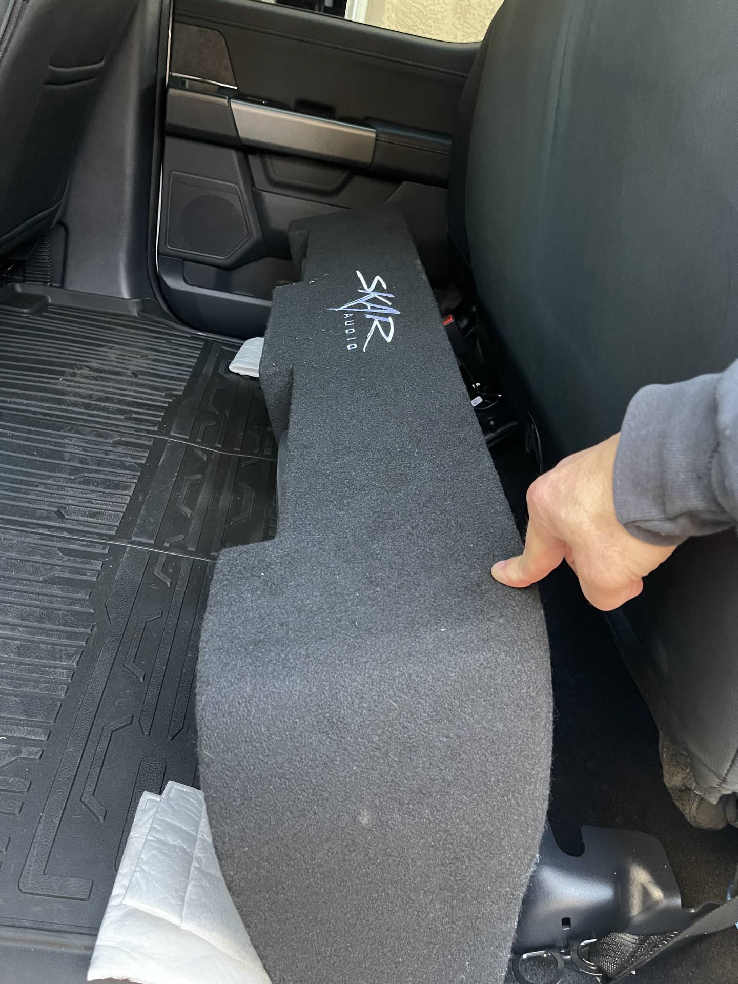

Anyone have any thoughts on this box?
Emailed them to figure out if its 5/8 or 3/4 mdf...
from the pic, ide guess 5/8
Im questioning the air space theyre claiming, 1.25 cf per sub.
Seems larger spec than similar boxes.
Seems large than the recommended air space ive seen on various subs?

Nice design but the tune is too high for me. I would want the tune near 30hz.
Yeah...
I was torn...
I initially bought them with zero reservation but after interacting with others on DIY forum that have these trucks, I had so many various opinions....

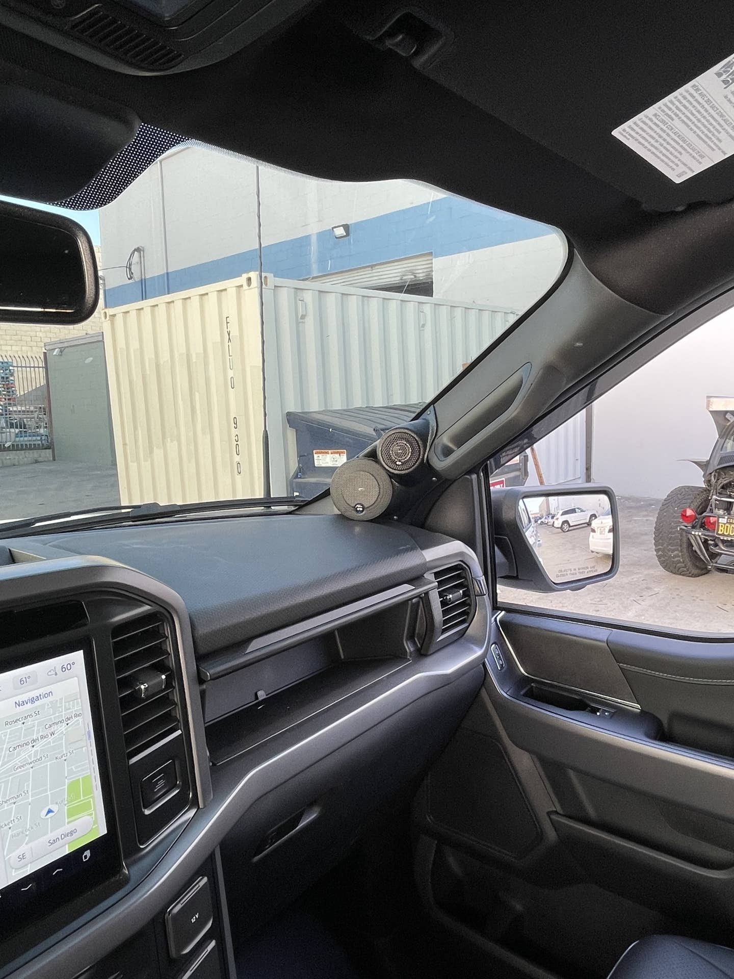

Some guys running SGS & MTI pods which still appears to run the tweeter & mid off axis & cost $1500+, but theyre pretty.....
then there was LMDesigns on Etsy, talented kid in the 3d printing world & an installer, making pretty pods also for $350, but off axis also.
The pods I bought were $120 on BF...
Yes, the driver side kind of is somewhat aimed toward the instrument cluster hump, but doubt theres any 1 perfect solution for everything.
Then theres guys that are getting the upgraded defroster grill assy that mounts on the dash by the windshield, has built-in grills, used by the f150's with the upgraded b&o system, mounts mids in the dash. That was a $250 grill panel.
My installer was all about that, he has "tumors" mounted on the a pillars in his own vehicles but he prefers to keep things clean & factory looking.
Then once he got in there, he decided there was to much cutting of the lower dash skeleton to make it work, just a huge open cavity, no baffle, etc, to much work to make it sound good, me shelling out more money, so he aborted.
Retuned the panel to the dealer I worked at & got a full refund.
Overall im happy with the A pillar pods from speaker pods.com.
Dont think the look over the top stupid in any way, personally.
Yes, im sure there ay have been some way more aesthetically looking speakers that may have tied it all in better, but the grills are ok on the cat's, dont look overly cheap.
