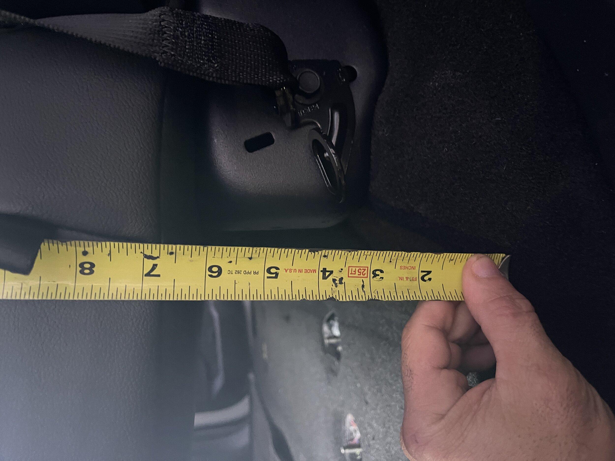

Whats the height x width x depth available?
Is the floor flat or are there things to work around?
Last F150 I did that comes to mind had limited height and used 6.5" subs. The owner was adamant "no seat lifts".
I think I consulted on one with 3 kicker L78s last week and it had a 2" lift. It was shelled in prior to final determination of # of subs/tuning. The shop initially called Kicker for suggestions and the port area/length in the supplied airspace was typical Kicker... 46hz with excessive port area. But the shop had NO idea.
I remember driving over then looking at the actual enclosure, running numbers /w/ Torres on the spot and coming up with a single side fire 6" port about 17" long for a 33hz tuning.
Space makes bass, even the 6.5's would have liked a slight seat lift iirc.

Pull some measurements, Last F150 underseat enclosure I dealt with in person was a fab stacked chinese puzzle with just enough side panel area for a round. 2" lifted and shelled, stack fabbed or glassed in. Like I said it was done right but barely could be designed around. The owner had 4 subs and wanted 4 installed. After some back and forth 3 were decided upon. Nevermind Kicker's recommendations. Absolute garbage.
I remember a fabricated disaster done well but barely enough room for porting. All those seatbelt notches and allowances for floor clearance made the airspace he created with a seatlift almost moot.

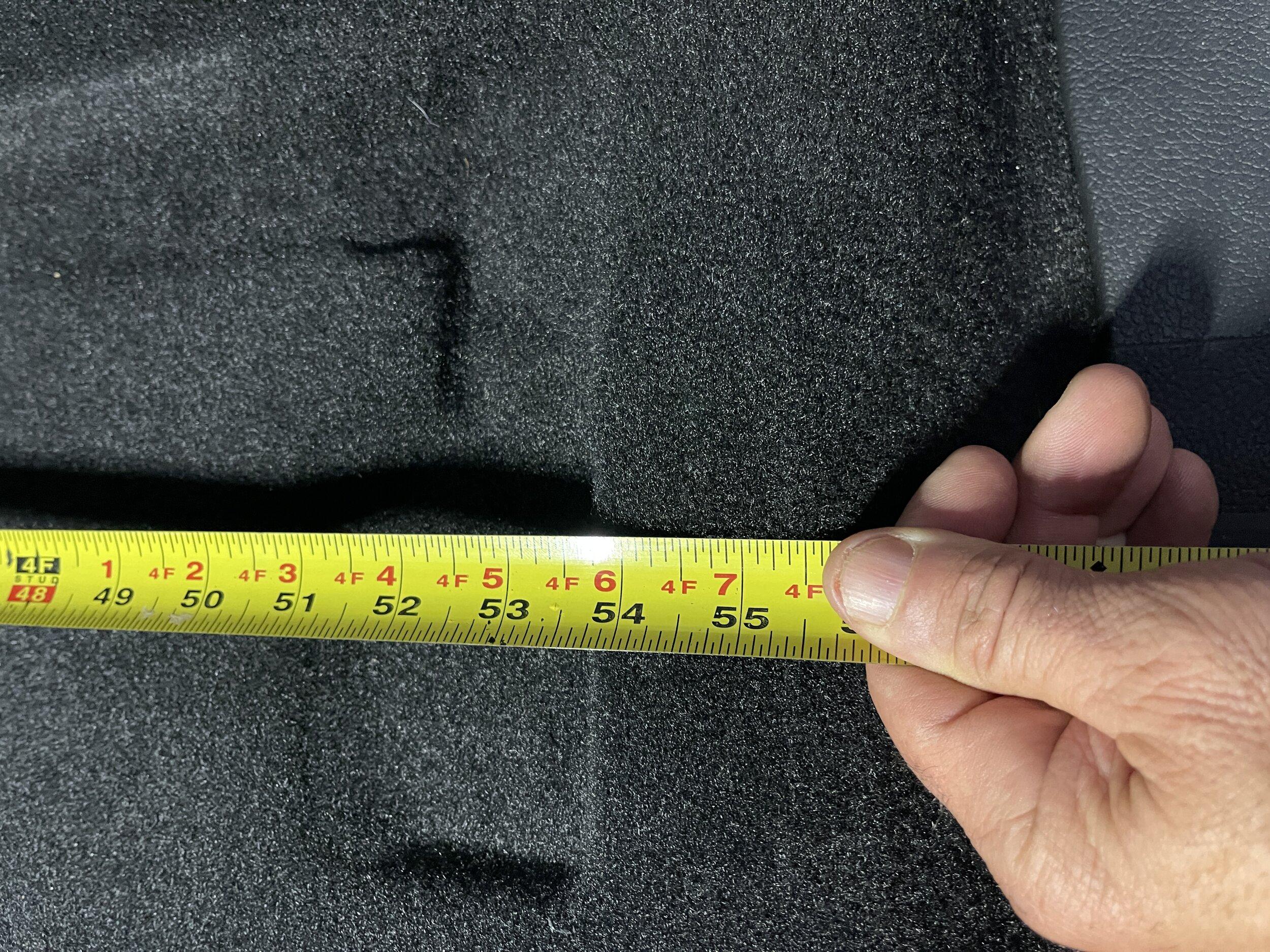

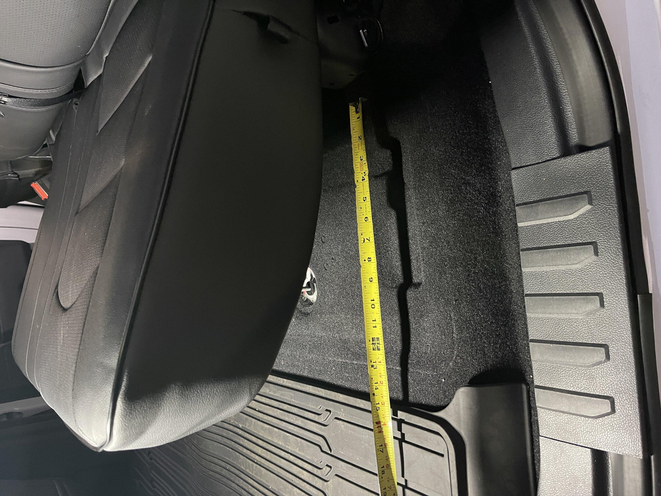

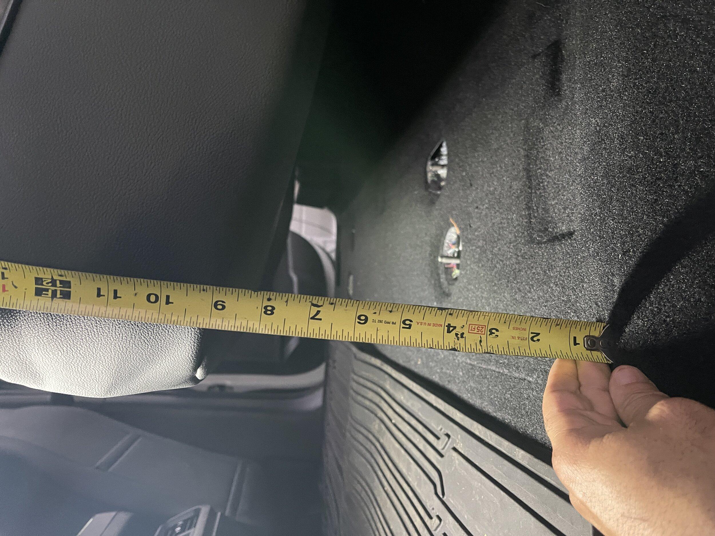

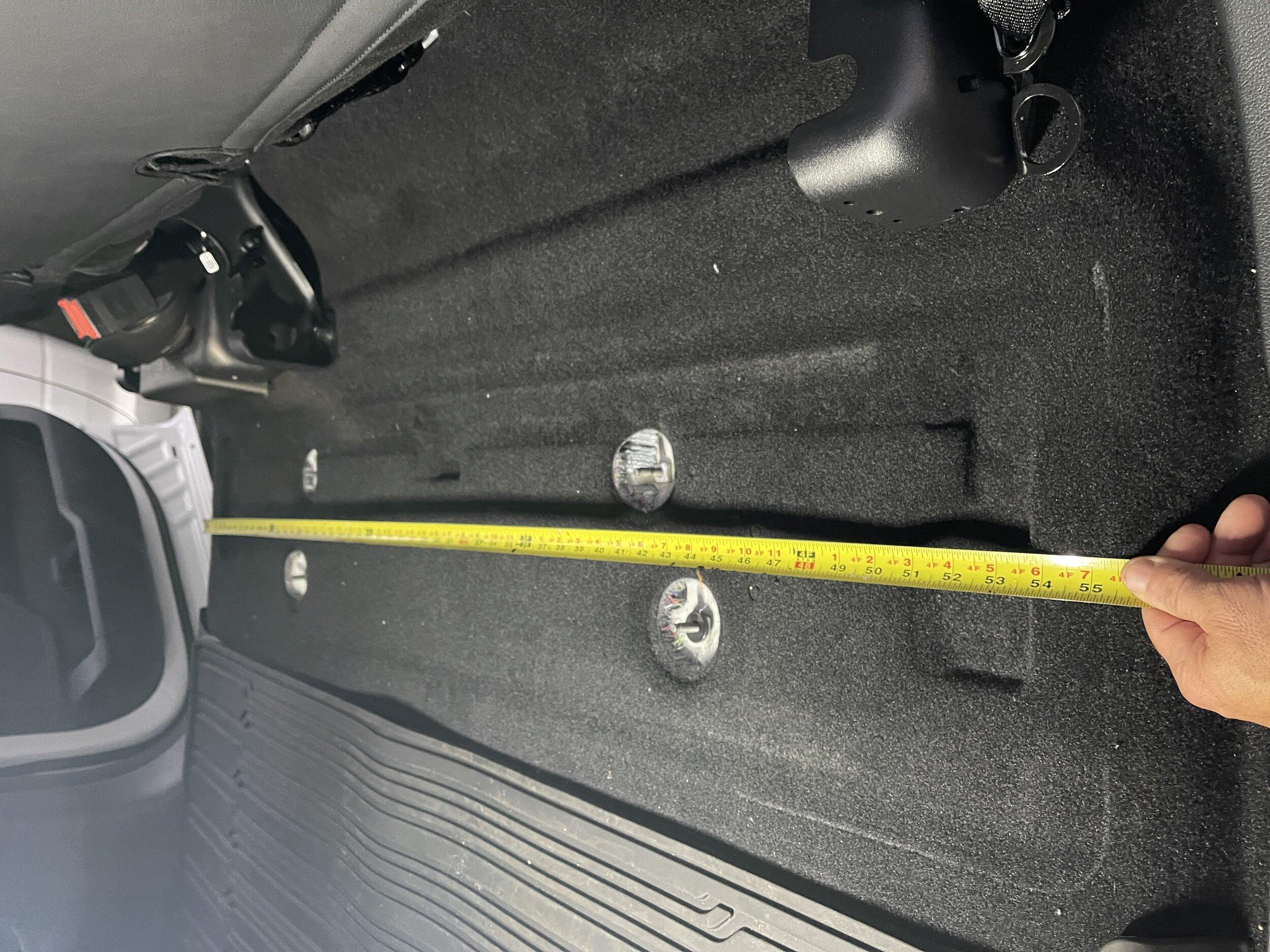

ill take some pics & measurements, the underseat area is pretty big & overall clean with minimal obstruction..

Ide say ground shakers measurements are pretty accurate.

Ooh... I see about 2.5ft3 available maybe more. 2-3 8's or maybe a pair of 10s look very doable. I'm no salesman so brand or gear recommendations ain't my thing but I would wager a pair of serious 8's could do some work in that space. Don't discount what a pair of 8s in the right enclosure can achieve. I do this all the time.

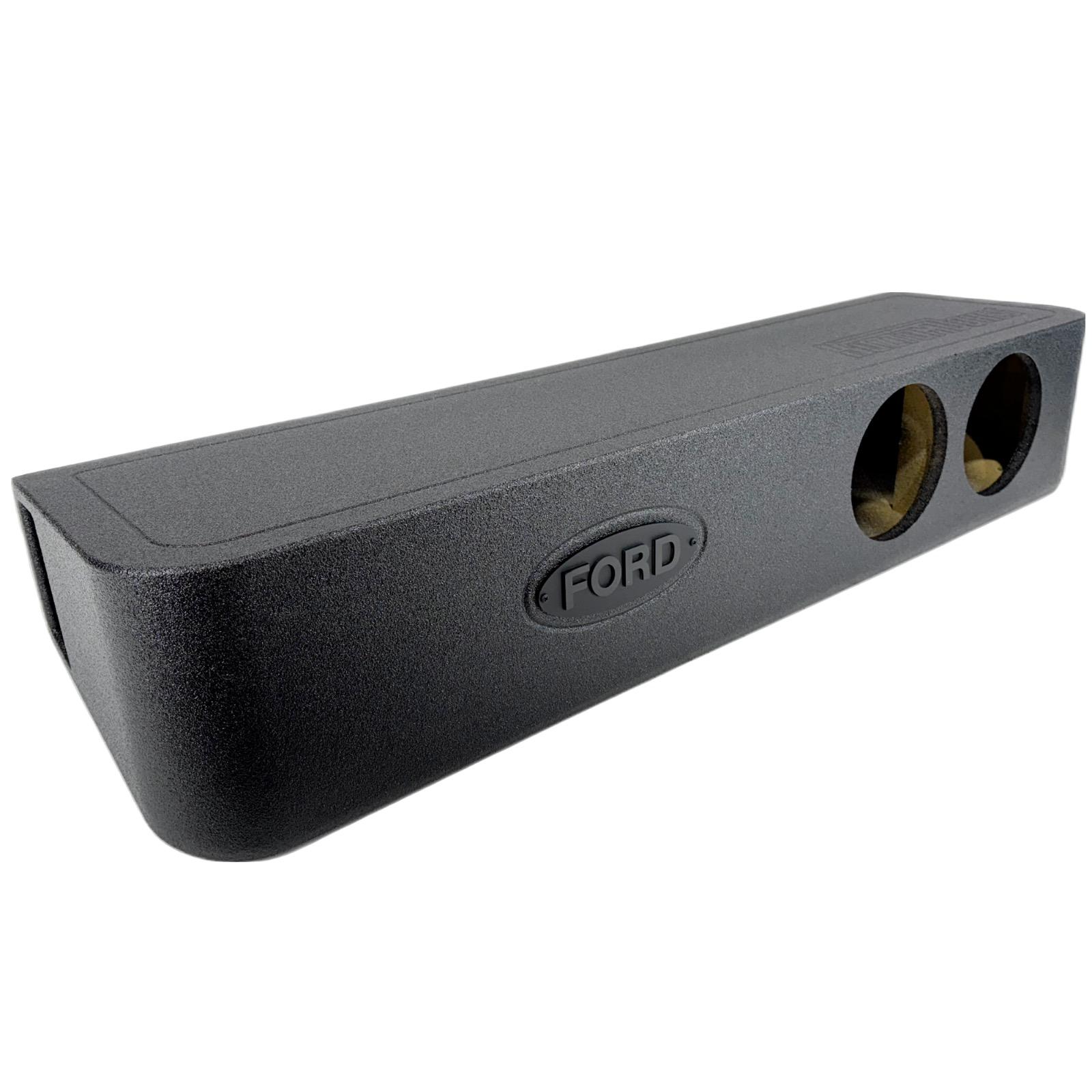

Anyone have any thoughts on this box?
Emailed them to figure out if its 5/8 or 3/4 mdf...
from the pic, ide guess 5/8
Im questioning the air space theyre claiming, 1.25 cf per sub.
Seems larger spec than similar boxes.
Seems large than the recommended air space ive seen on various subs?

FITS:
FORD F-150 09-24 CREW CAB
FORD F-250 17-24 CREW CAB
FORD F-350 17-24 CREW CAB
BOX DIMENSIONS:
Length: 54"
Width: 13.5"
Front Height: 10"
Rear Height: 6.75"
PORT DIMENSIONS:
Length: 30.75"
Width: 2.5"
Height: 5.25"
Air Space Per Sub : 1.25 CF
Box Tuning : 37 HZ
MOUNTING DEPTH: 8"
WOOFER CUT OUTS: 7.5"
WOOD TYPE: High Quality MDF MADE IN USA
ENCLOSURE FINISH: Black Armor Coating (Same Heavy Duty Material That is Use to Paint Truck Beds)

I think the cuft is close to accurate, but it's tuned to 37hz, which is on the high side.
According to the guys over at CT, they claim the box is way to large for only 2 CT Stratos, Tropos, or Mesos....
They claim that volume is better suited for 4, unless theres a calculation error somewhere, over my head/
