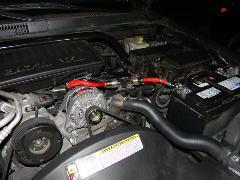

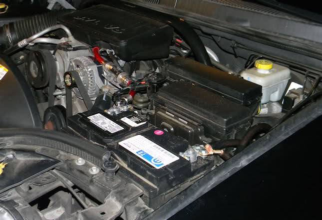

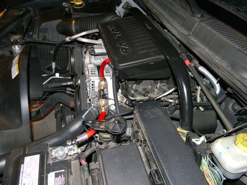

Upgraded the alternator to 220 amps and did BIG 3 with 0 gauge.

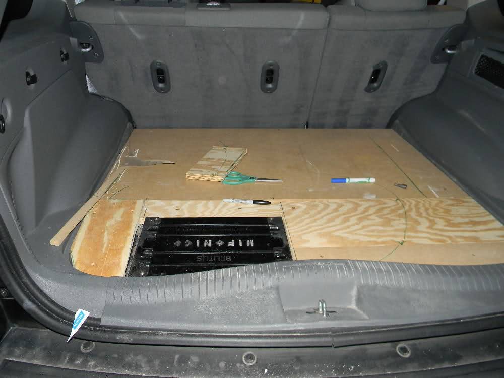

Drawing out a plan 1st....
Then checking his measurements....
ok now all the cute stuff is out of the way......

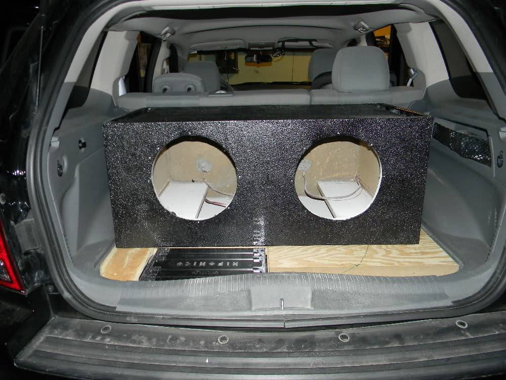

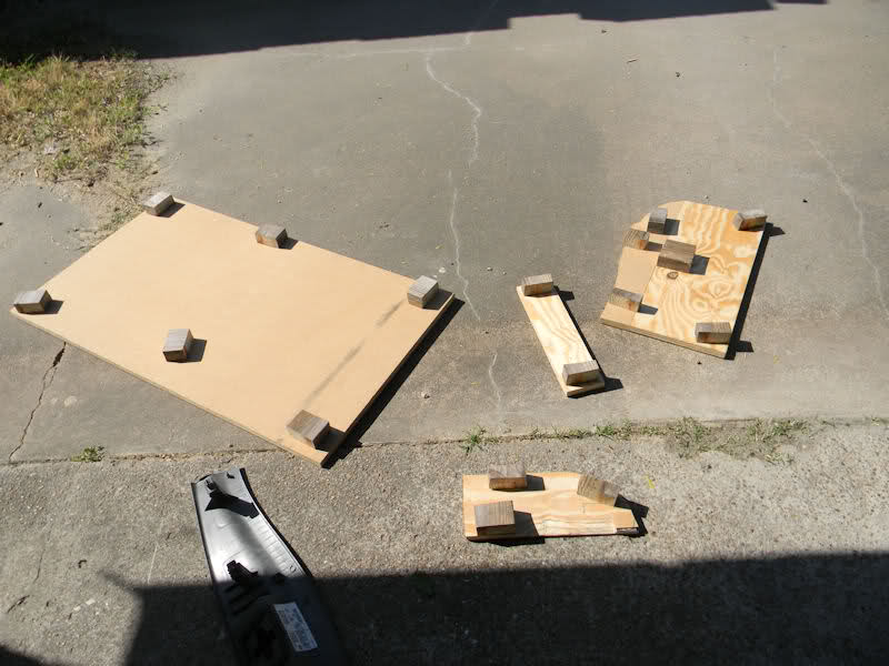

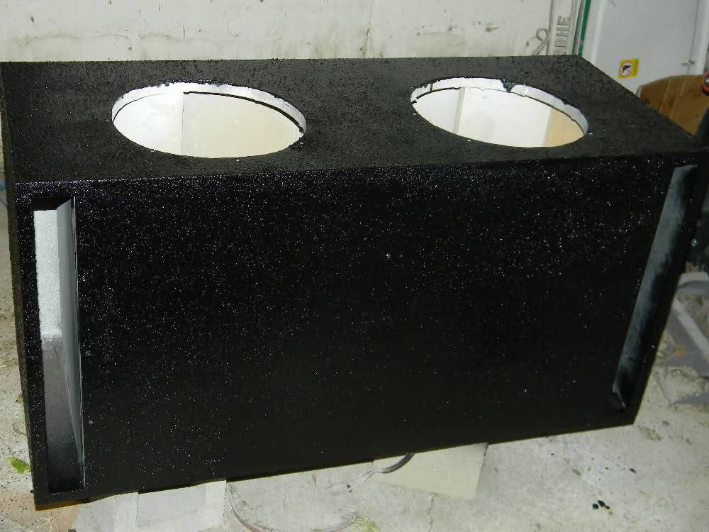

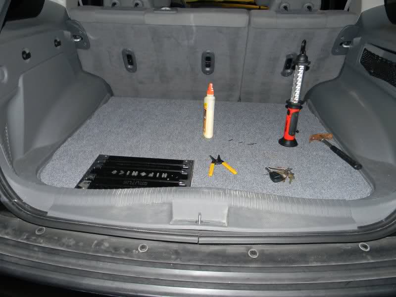

Four Large pieces with 2 inch standoffs
and they fit like a glove
Just had to see how the box would look inside

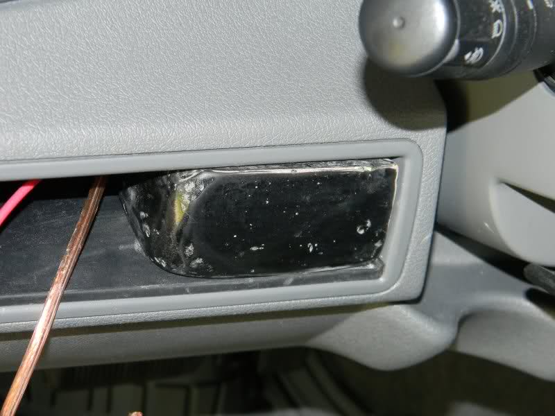

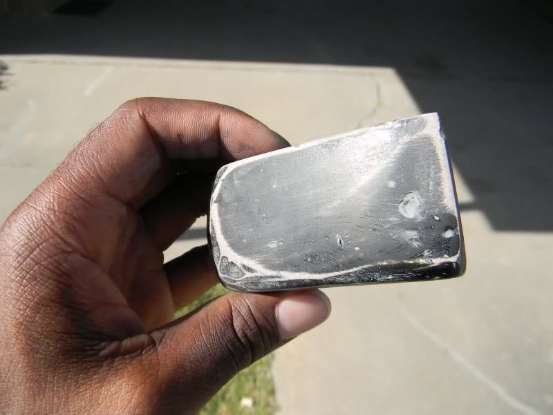

working on a fiberglass project (sorry no pics till now).
used foil to shape it to what I needed it to be.
used fiberglass resin to hardened it just a little.
then fiberglass + resin to give it some strength.

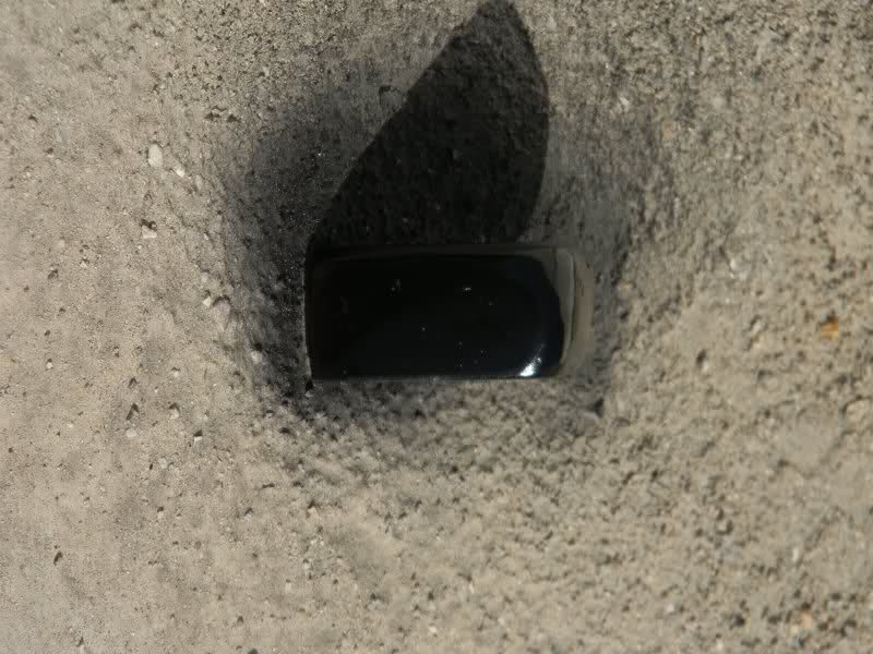

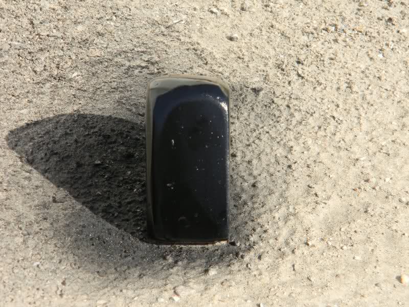

bodo, 40,220 sand and then 1 layer of black spray paint and this is what you get.
adding another layer of paint

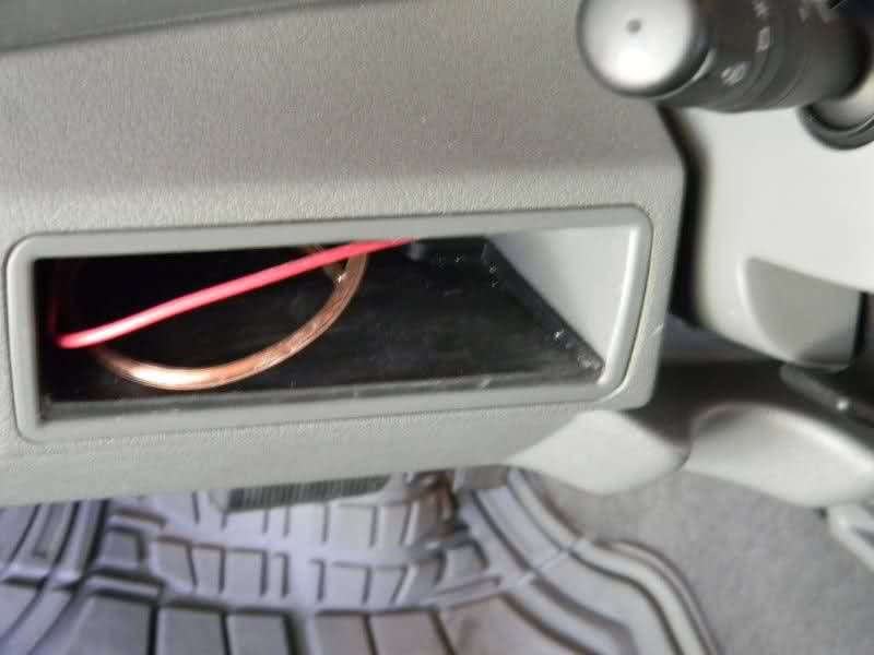

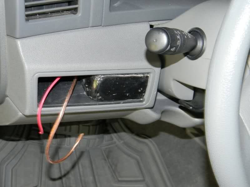

So what is this polished turd used for?
Well its going here to house the switch to turn on/off the hifonics amp.
Nice and snug in place
Need to sand/ paint with 600 and 2000 grit to get a smoother look.
