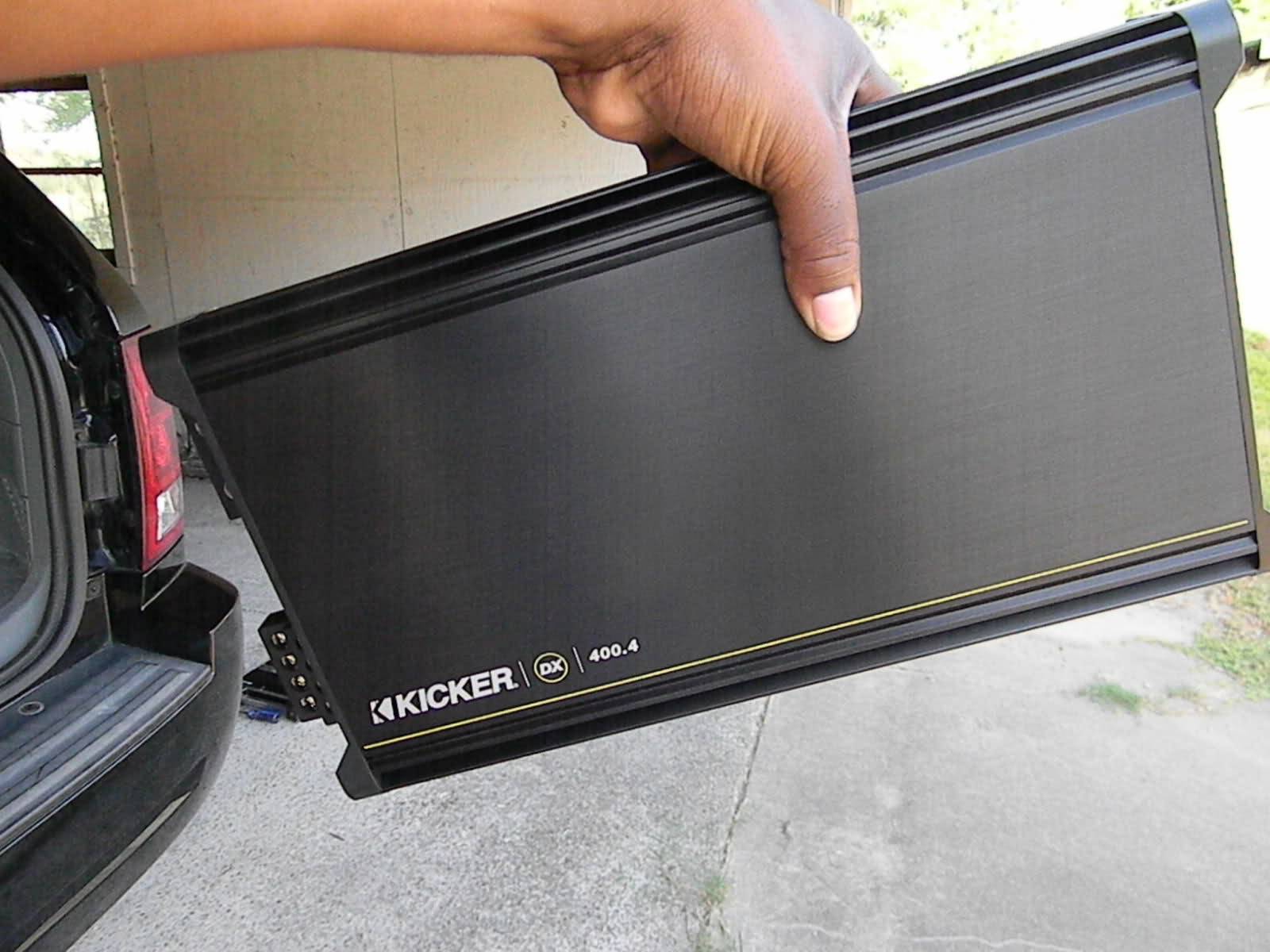

This was the amp I was using for my back door speakers

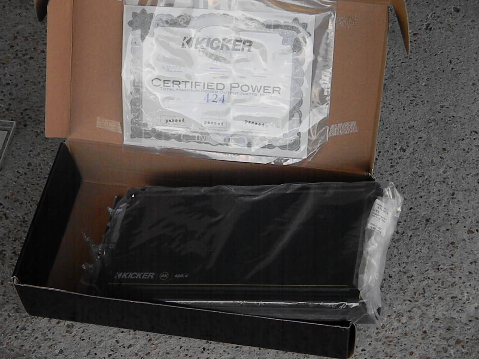

Replaced that crap with ....

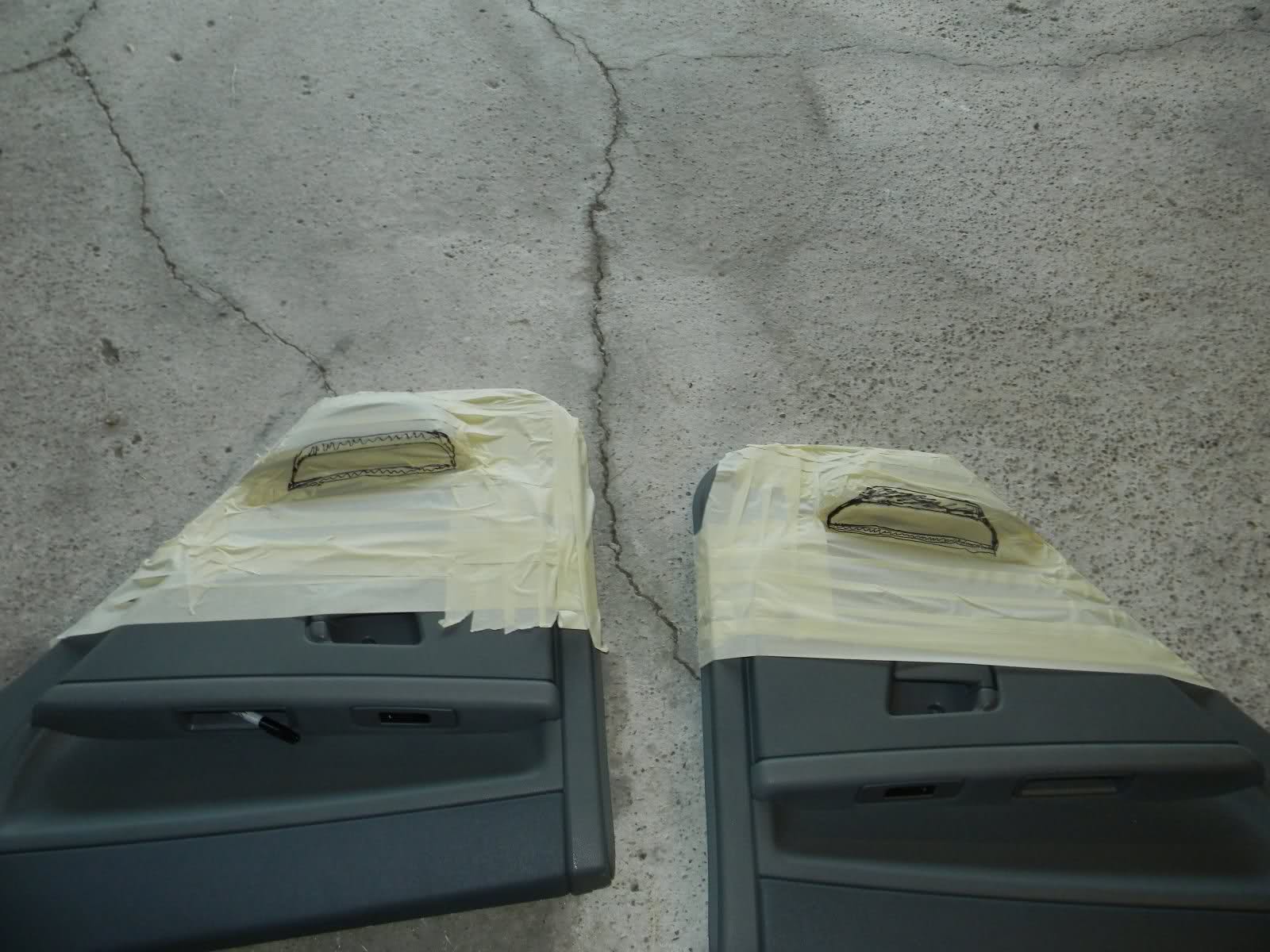

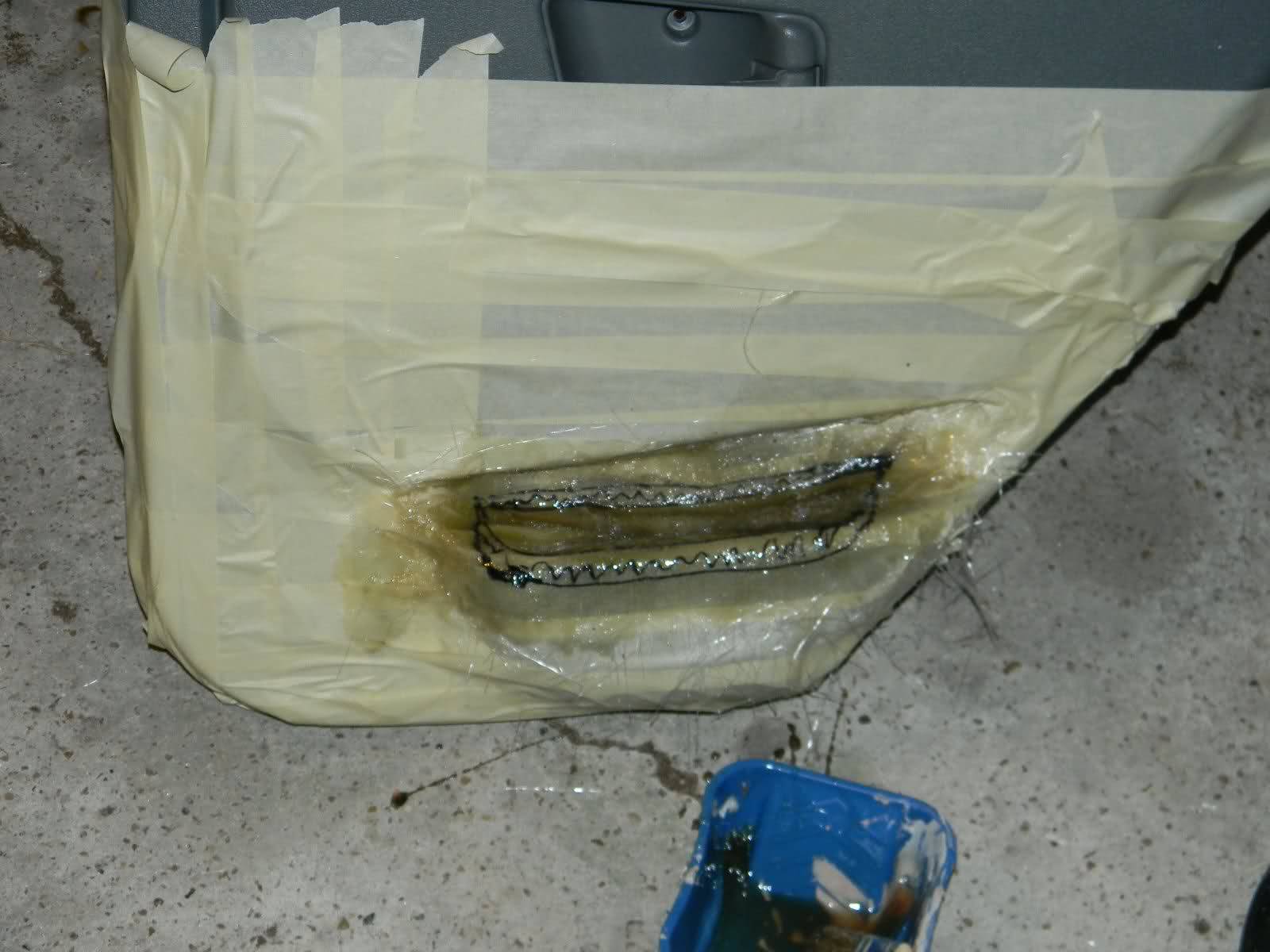

Took off the doors to get them ready to be fiberglassed
then added 3 layers.

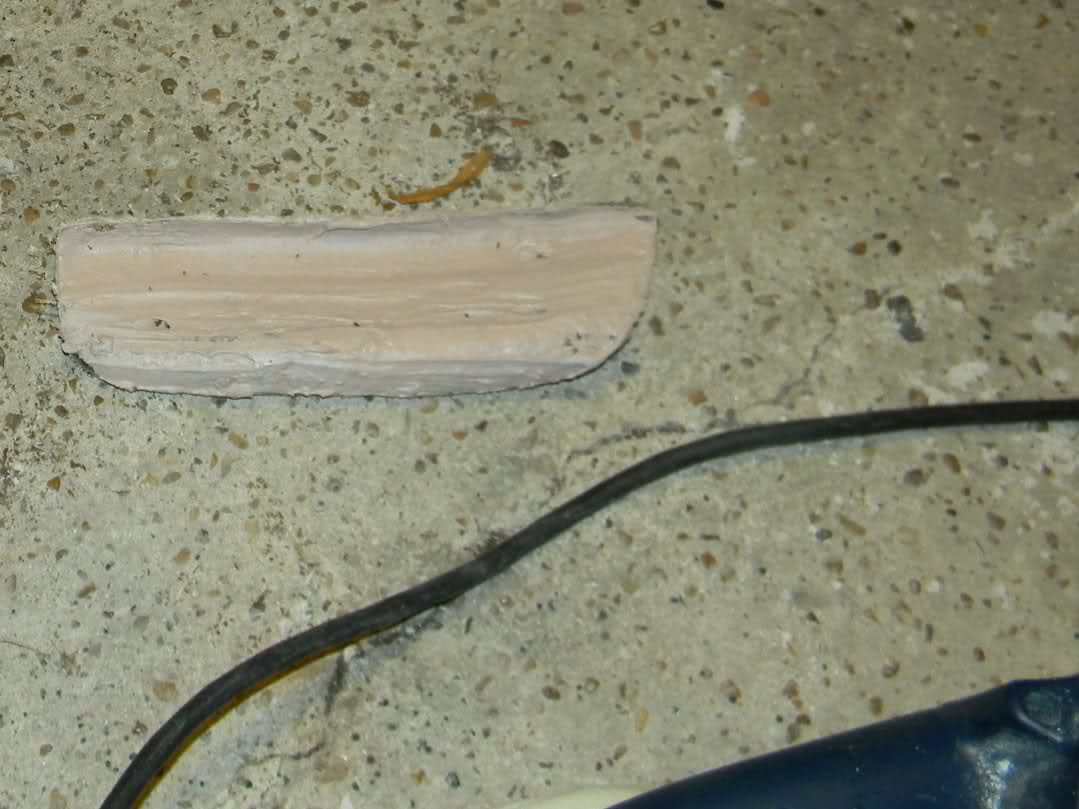

Then bondo.
sand and shape with 200 grit

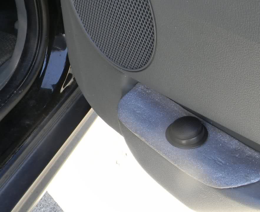

Didnt want a super smooth look so I used Spackle spray paint. Apparently this was the closest they had to the shade of gray that my door panels are
But overall I think it turned out ok.
