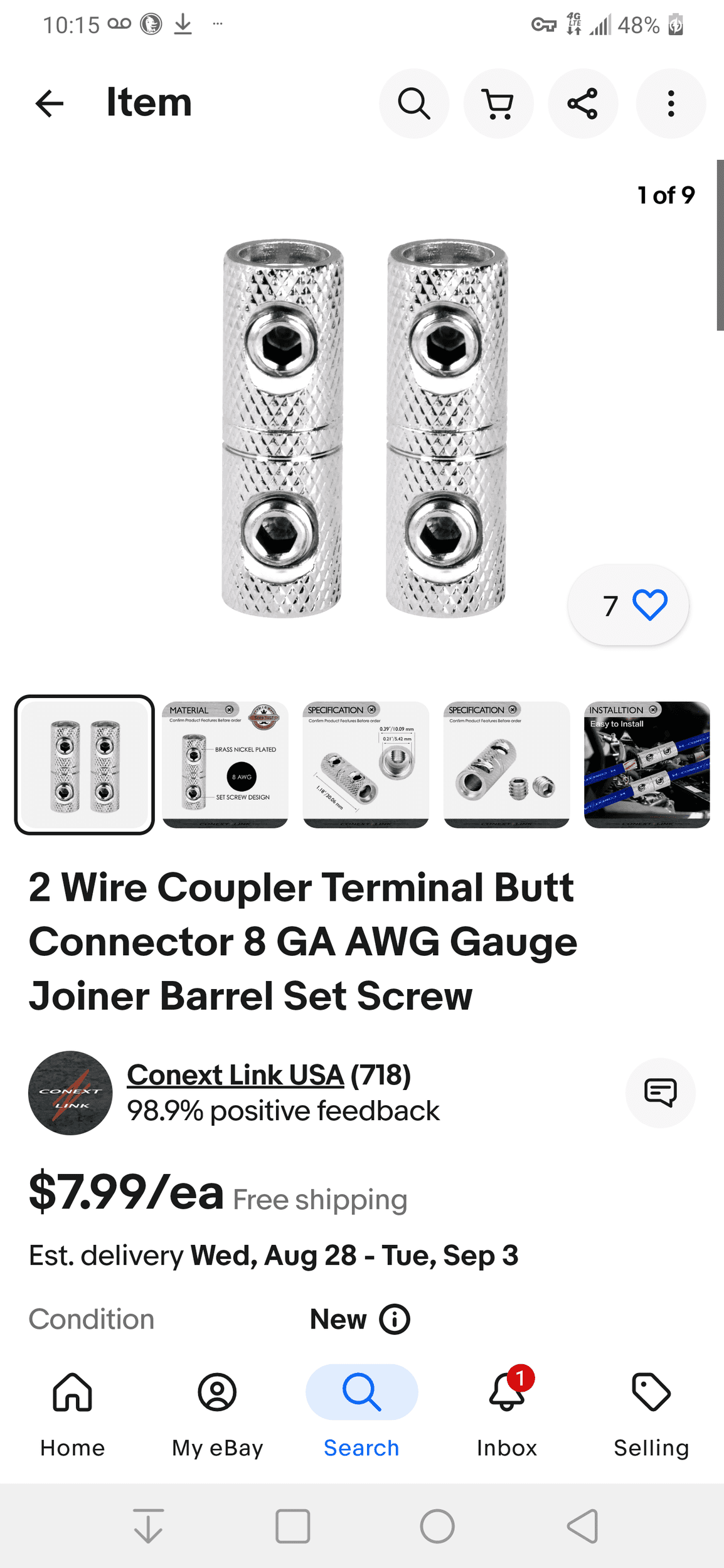

I'm going to have to solder that small wire into the bigger gauge, is that fine?
I used something like this. Works fine.

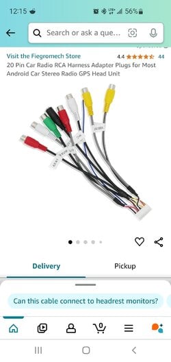

Also, am I supposed to just "tap" into the factory speaker wires with this type of amp?
Since you have an Android radio, it should have RCA outputs, and that loaded speaker harness should have RCA inputs.

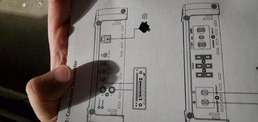

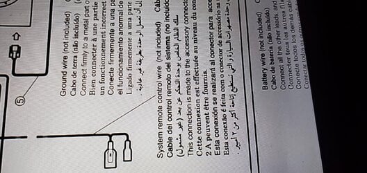

In the diagram it says the System remote control wire (not included) needs to be connected to the accessory connector in the car's fuse unit from which over 2 amps can be supplied. So can I go to the 12V cigarette outlet ? I assume that's is the remote to power on the sub, wouldn't I want to wire in a switch to turn it on after I start the car ? And it looks like it has some flat socket connectors in the diagram (the not included wire)
Those look handy dandy. I'll probably try those out. I can avoid heat shrink and hot solder. I hope the audio shop in town has them on hand.

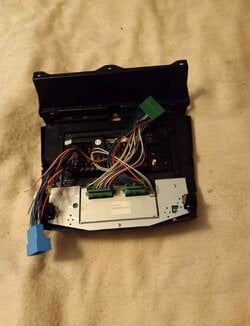

As for the Android I'm pretty sure it uses standard wire harness. It was already installed but looks like the one I attached. 2003-2007 Accord Android screen generic eBay crap. It works though

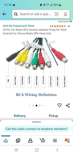

Actually ya you're right. I gotta check to see if I have the connections. Otherwise I ordered a pair of Amazon. Hopefully it fits.
That takes care of the remote signal, but would I just use the RCA AUX IN left and right? What would I use the green sub RCA connection for ?

If it works, I would use the left and right outputs, not the subwoofer output.
Works. Crispy and clear actually. Upgrade for sure. RCA worked. Just wanted to say thanks. You can't see a single wire either.
Yes, you can tag the cigarette lighter's power for the remote.

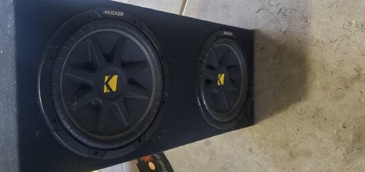

So I'm back with more remedial asks. Being New Year's I decided to clean up my garage and low and behold I found 2 kicker subs. They like 10 or 12s. I totally forgot I had them. They've been sitting for like 13 yrs. They were my stepsons and I never got rid of em. I was literally LMAO when I found em.
I bought a economy amp which should be enough.
Blaupunkt AMP3000D AMP3000D 3,000-Watt-Max Monoblock Class D Amp​
Being everything was wired I didn't have an issue with the remote and power connections. Everything fit awesome. Blue lights come on and amp is on. I'm wondering if I need to swap the RCA connector at the head unit to the Subwoofer connection(the green connection) If I do though there's only one plug what happens with the Left and Right channels? Do I need to get an adapter to tie it to one signal?
As of now I just swapped the power and remote cables to the amp(blue light on the amp shows good). RCA plugs to the RCA Ports on the AMp, and parallel connected the subs. Again I don't know if these subs are good but I hear nothing not even crappy sounding subs.
